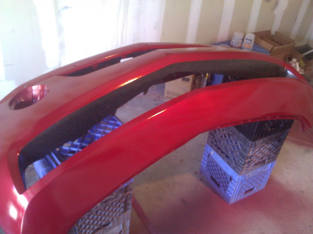

Finally it was time to clear, ugh, I hate clear coating. It sure does make everything purty and shiny, but so hard to get smooth. I used a decent HVLP gravity feed gun with a 30 gallon tank and a 1.3 tip. I couldn’t get that sweet foggy spray pattern I saw online. Again I did bumpers separate and they went a lot better as practice before I got to the entire body. Lucky I’m tall cause I could start on far side of hood than down windows, forward from rear bumper to front fenders, cross over hood and re-fill gun finally doing other side and trunk. Well the thing is… It went ok until I switched masks to one I thought would work and nearly blacked out. 3M mildew masks are no good for painting, says my rubbery legs and nearly blacking out. This mayyyy have lead to some runs, just maybe… My best advice on clearing a car that will be wet sanded, “entire car should be one large run.” No problem, 4 thick coats later she was off and running for sure!
Who likes wet sanding clear? NO ONE!!! I first told a friend it would take me 2-3 weeks. Try 6 weeks! This is with work and of course buffing it back to shiny. With this much orange peel here’s what I came up with: 1. Wet sand with 600 2. Wet sand with 1000 3. Wet sand with 1500 4. Buff with a heavy cutting compound and foam pad 5. Buff with a good 1500 gritt sanding or swirl remover and wool pad 6. Buff with a polishing compound 7. Finally wax the $hit out of it! About half way through I attained a real zen like state listening to my music while sanding and I became able to see the orange peel while wet sanding. I could literally see the imperfections through the water. By the time I got to the final side, drivers, I was super pro! Because I’m me after I finished car guess what, I went back and redid a bunch of my work. I think I found one panel that had so many scratches I think I forgot the 1500 grit, woooops!

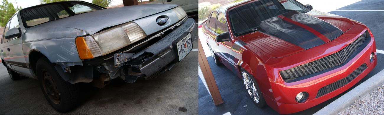

Before and after, see the difference? It's subtle!
To me, just my opinion now, she turned out amazing!!! Just look how the front fenders flow from horizontal Camaro bumper to Taurus sides. Look how the shrunken bumper looks seamless! How the fender flares tuck those front tires in just so! “Nic, you really got that thing tucking tire!” All without lowering it an inch. Look at those sides, look at how I transformed them! I got this thing looking like some kind of AMG or Dinan Euro super sedan! (in my mind) Finally that rear, which I’m most proud of. I honestly think it could pass for a real car. Look how the black separates the red so evenly! Really helping to break up such a large area. Talk about a transformation!
