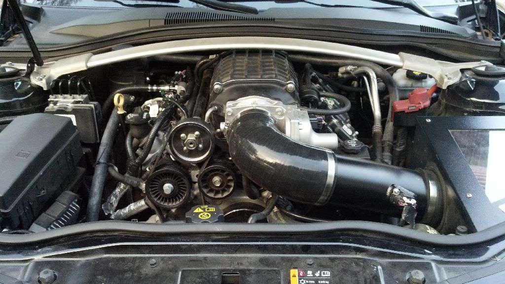

Just thought I'd share for the benefit of anyone else buying a used Maggie setup, as I've installed several new kits, but never a used one, so there are a few things I didn't notice when I was looking at the kit I bought.

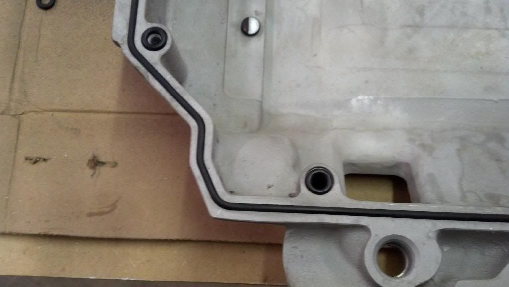

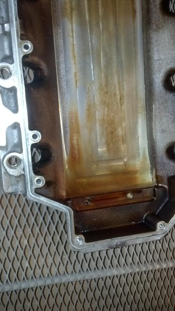

I guess the previous owner didn't have a catch can installed. You can see the little pool of oil in the spot where the intercooler "buttons" go that hold the intercooler up. So I went ahead and blasted the manifold before I started porting it. I ported one runner before deciding it was just too much to do all over again. Last time I did one, I did it all by hand. Took FOR-EV-ER. So I decided to rough out the ports with the mill.

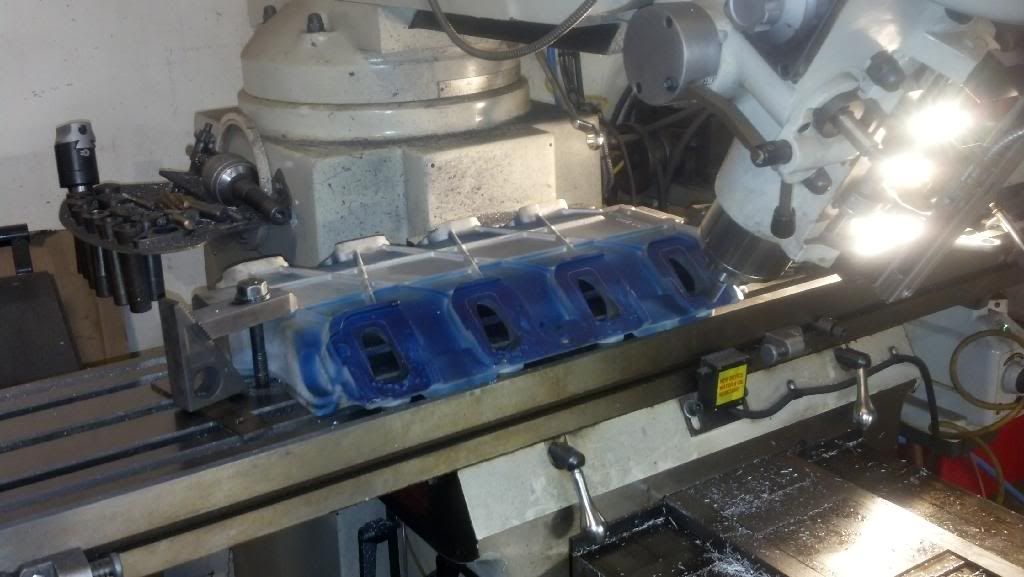

Saved HOURS of time with the carbide burr. Milled it out in 45 minutes. One setup shown in the picture, and one from the inside of the manifold that leveled the port floor with the machined area under the intercooler. You can see some of the difference here in this inside shot, that shows the new o-rings required when reassembling the upper and lower manifolds.
I have the sizes required written down somewhere in the shop for anyone taking this on in the future.

I was able to do the full install without draining my radiator, as I have a 2012, so the heater hoses aren't in the way of the blower. The instructions don't mention this. All I had to do was remove the line from the nipple at the radiator cap while I did some work in that area, I clamped it off with vise grips, as it goes to the steam line that will drain if not clamped off. I then leaned back the radiator to install the intercooler. I also did not remove the fans, as that would have required draining the radiator as well. I still had enough room to install the pin kit in the crank with my right angle cordless drill. I was able to scare up a pin kit relatively cheap, but I could have gotten it cheaper buy just using two dowel pins that I have in stock at work, A used kit without the pins, and a new crank bolt from the dealership. Would have saved about $30.
I also did not have the valley plate that magnacharger provides for the LS3 motors. I reused the LS3 plate by turning the PCV nipple downward and doing some minor grinding to the nipple boss on the plate. The real interference issue is the ribbing on the underside of the lower manifold. 3 minutes with the die grinder was better than removing and reinstalling the plate anyway.
On the oil pressure sending unit, there is a copper crush washer that is included to index the wiring clip it a certain direction to prevent interference. Of course, not included in my used kit. I was able to make one from teflon sheet and a gasket punch set at work. I think it was 3/32 thick, with a 9/16 center hole and 1" OD. I added a little extra thread tape and some RTV on the washer for good measure. No leaks here!

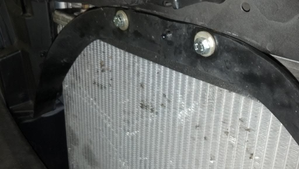

Lastly, on the issues of the convetible strut tower brace and radiator support brace: I did not have the spacers that Magnacharger includes for the radiator support brace. I had the bumper off for my install, so I was able to use some spacers I machined at work along with some longer bolts and washers. I also placed some weatherstripping tape between the heat exhanger and brace to make me feel better about the possibility of them contacting each other (they had clearance without the the tape, though):
Contrary to what I have read is some places (including the magnacharger instructions), the strut tower fits right back, no problems.
