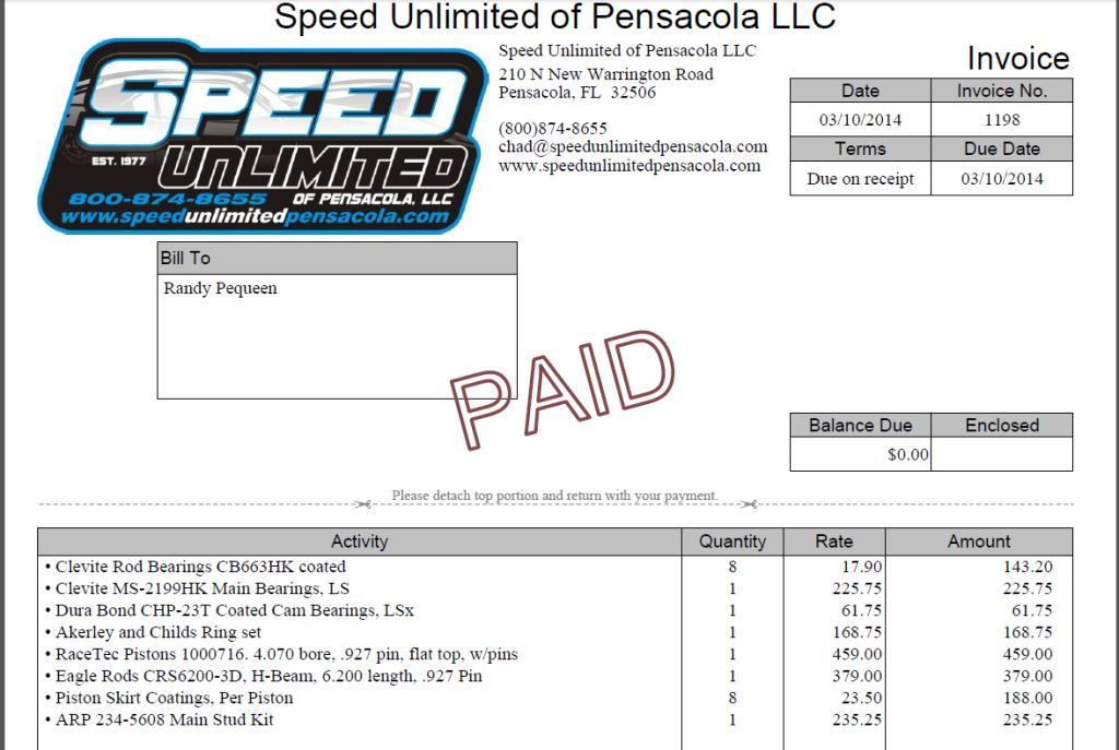

Ordered.
Black is about done, bored minimally to get a good clean hone so no real displacement change there but the pistons will be shorter for 10.2:1 compression and a bit of volume be default there. Not much I imagine. Pistons and rods forged of course. Re-using my crank.
Heads are getting CCd and cleaned up. Not going to port them but going to knock off the sharp edges that can get hot.
Cam and specs to come.
1860.70 so far.

Ordered.
1860.70 so far.
Attachment 606840
