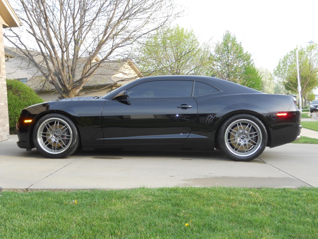

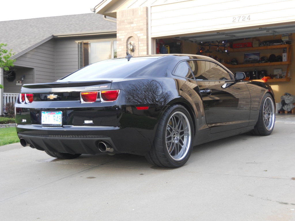

Originally Posted by Speed74SS View Post
Here is a 315/35/20 on a 10" Rim in the rear. My fronts are 275/40/20 on a 10" Rim as well though.
Attachment 242452
Attachment 242453
What's the offset on the wheels?
