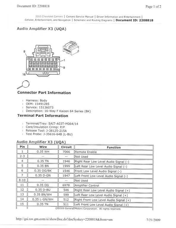

Old 02-05-2015, 06:02 PM   #8
Rainbow1616
Rainbow1616's Avatar
Drives: 2011 Inferno Orange Camaro 2SS/RS
Location: Pittsburgh, PA
Posts: 1,368
I used 2 of these and 1 piece of 18 gauge white wire.
I also used 5 red T Taps and some black electrical tape to keep it neat
One Rca for the right side went to pins 12 (+) and pin 4 (-) T tap these
The left rca went to pin 13 (+) and pin 5 (-)
The white wire for remote turn on of your new amp t taped into pin 1
This is for the BA system only
