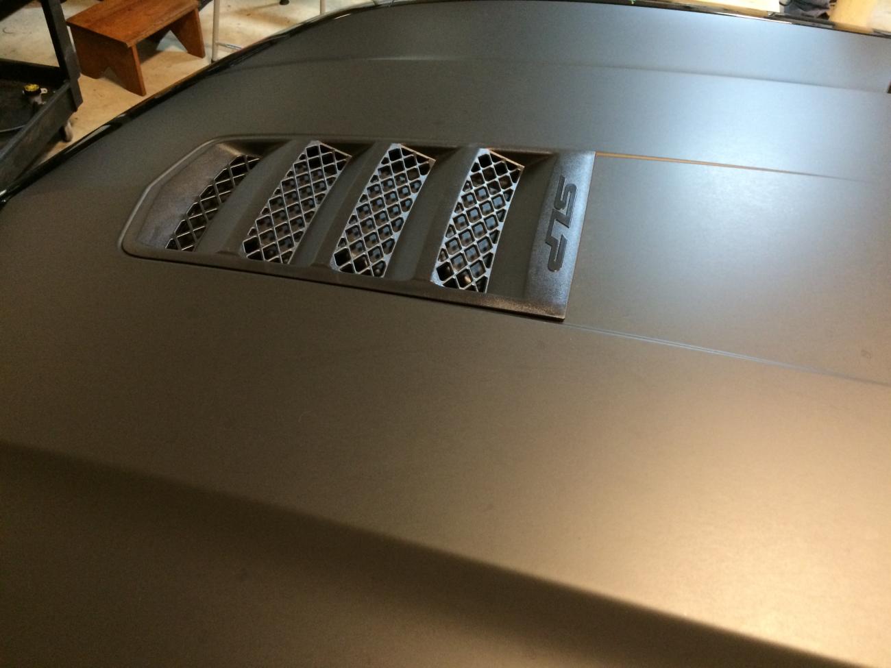

I have the slp drip tray. It is very nice. The finish is not quite on par with stock, but it fits great. In one way it looks better because it is more of a matte finish. I also like the slp letters on it now. They are subtle. Again the fit is amazing and so are the directions. I would just go ahead and get it. It will keep engine bay cleaner than taking out the stock drip tray (if it is as simple as that).

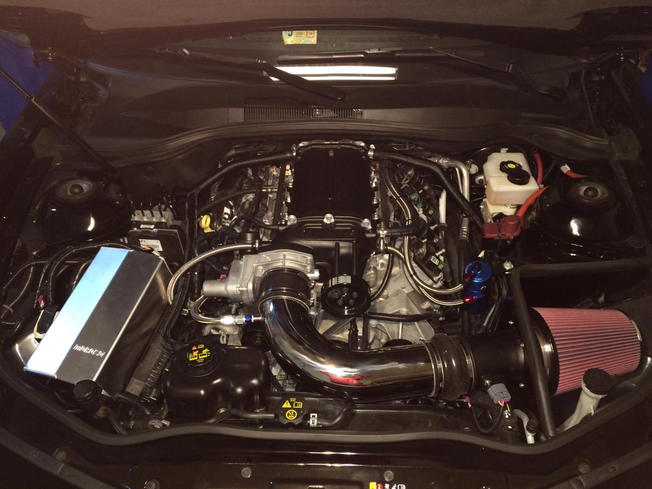

Ordering it now! Thanks for the pics. DO you have any of the engine bay? How do you like it? What tune did you use? Thanks!

JRE is handling my tuning. I had to upgrade fuel system as my pressure was dropping at wot. A BAP would have been sufficient, but after a few wot pulls, I want more power in the future. So instead of spending money on something I would replace down the road, I just said what the hell, and went with squash return style. I have both the squash kit and a 3.6 in pulley. I have yet to install either. Hopefully I will be able to install both soon. I also switched over to SCT handheld instead of intune. I would recommend finding a good tuner before buying anything to tune the car.
I still drive it here and there but no wot. My brother has a lift but he has been pretty busy with his 2015 STI. As soon as his car is off the lift, you better believe that squash is going in!
Overall, I love the kit. Very easy install.
SLP TVS 2300 Kooks 1 7/8" Rotofab intake NPP
