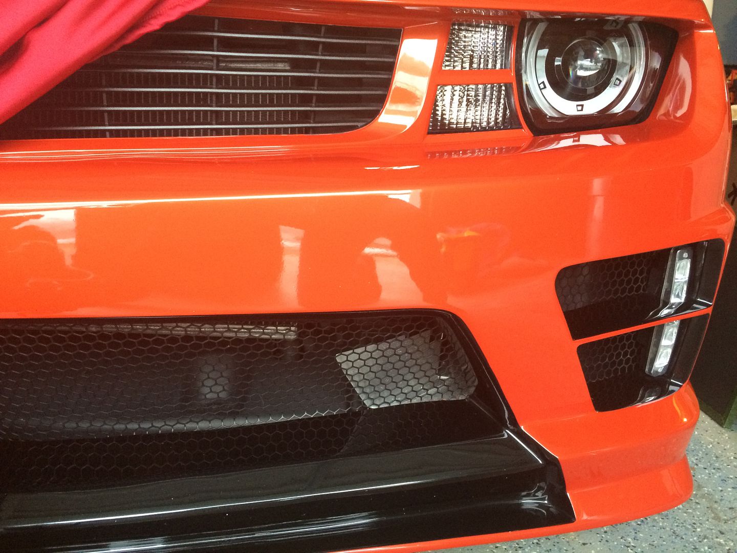

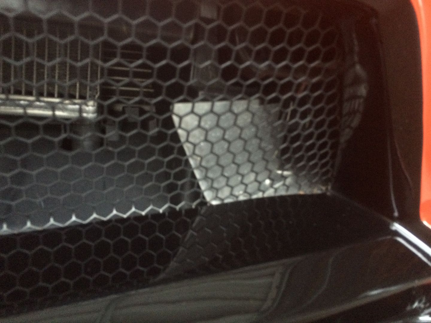

Here i can help with the scoop questions.
Here are a few pictures of the race scoop installed with the bumper.
The scoop itself will need to be trimmed in order to fit with this bumper. The depth of the bumper hits the scoop. The trimming is very minor. All you have to do is trim the rear of the scoop down where it connects to the car. This sucks the scoop closer to the car than the bumper. Very easy to do. You can trim the front as well. i just found it easier to do the rear portion since its not visible and you don't have to worry about how your cutting skills are!!
As far as rain in the scoop. Its no different than a stock SS bumper and water.
As long as your not driving in flood waters, you will be fine. The Intake is designed for this.
Here is an actual quote from Chase at Apex Motorsports when asked about water getting into the intake.
"There is nothing to worry about. In order for water to get to the air box it would have to enter the scoop, negotiate a 45 degree corner, make a 90 degree turn upward, and then climb about 12 inches vertically. While the scoop does direct additional cool dense air flow into the intake it does not create a vacuum capable of doing all that. Water vapor condenses against the back wall of the scoop and is drained through weep holes in the bottom rear corners."
