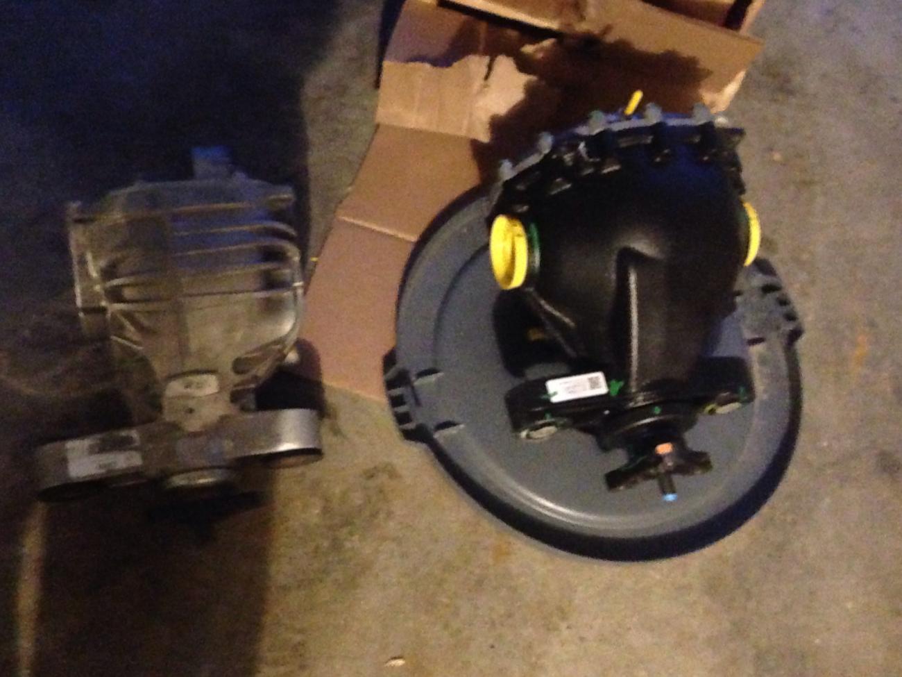

MA2010SS
Drives: 2010 Camaro SS
Location: Somerset MA
Posts: 725
Huge difference in size and no doubt strength with the ZL1 differential kit
2010 Camaro SS Whipple SC, CAI Inc Intake, TSP 1 7/8" LT headers no cats, 3" magnaflow exhaust, HPT, RX Catch Can, LSR Toe Rods, LSR Trailing Arms, ALKY Control Meth, McLeod RXT Twin Disc, ZL1 fuel pump, 3.73 ZL1 Differential Kit, BTR PDS Stage 2 Cam, Tuned by SLOWHAWK Performance Bridgewater MA
