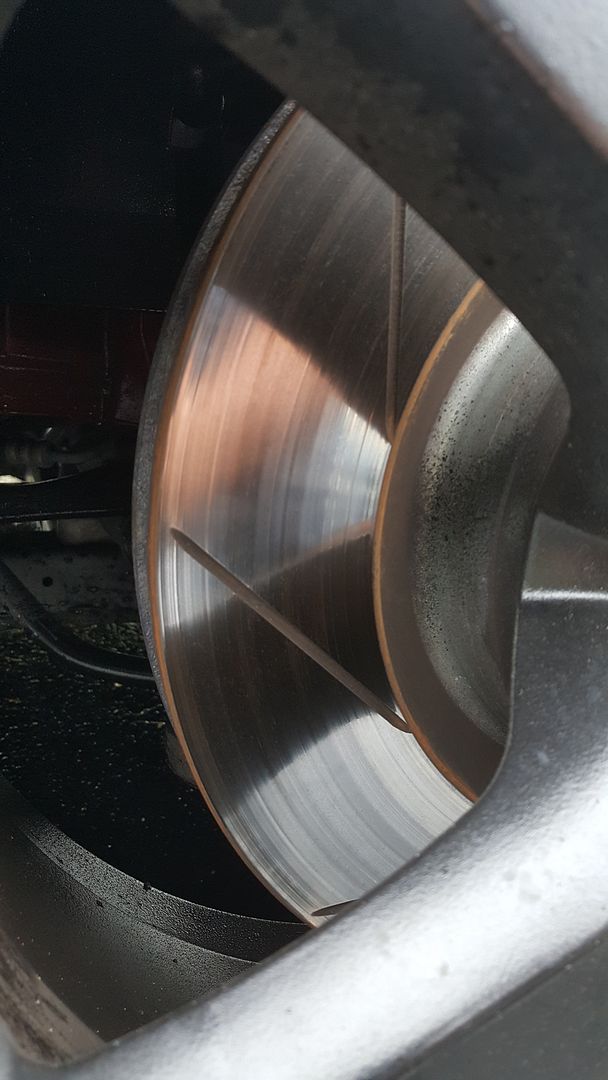

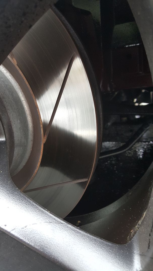

Old 05-11-2015, 11:18 AM   #4
Denis
Denis's Avatar
Drives: 2010 SS
Location: Yorktown Heights, NY
Posts: 7,695
Drivers side:
Passenger side:
Denis is offline   Reply With Quote
Old 05-11-2015, 01:45 PM   #5
intensifi
Drives: '12 2LT Convertible
Location: Belmont, California
Posts: 1,701
Originally Posted by Denis View Post
well after reading up on that lateral runout it would seem that over torqueing the lugs could cause that...
I wonder if just picking up a new set of rotors and being more careful with the torque would be the fix.
I haven't noticed anything etched by the pads but ill take a better look at lunch.
Also clean rust off hubs, rotors and bolts.

Old 05-11-2015, 02:42 PM   #6
bannonm
bannonm's Avatar
Drives: 2011 2SS/RS M6 VR
Location: Chicagoland
Posts: 1,536
It's hard to tell from your pictures, but did you have your wheels power coated? I have a friend who had the wheels on his Z06 power coated. While doing an HPDE, the wheels had heated up enough that the paint on the backside of the wheel where it mounts to the hub had melted enough that it affected the lugnuts. That part of the wheel should never have been painted for that reason. I bring this up because of the mention of not having the proper torque on the lugnuts. Make sure the back of the wheel is also clean so that the lugs can't loosen up.
