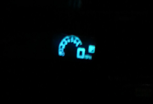

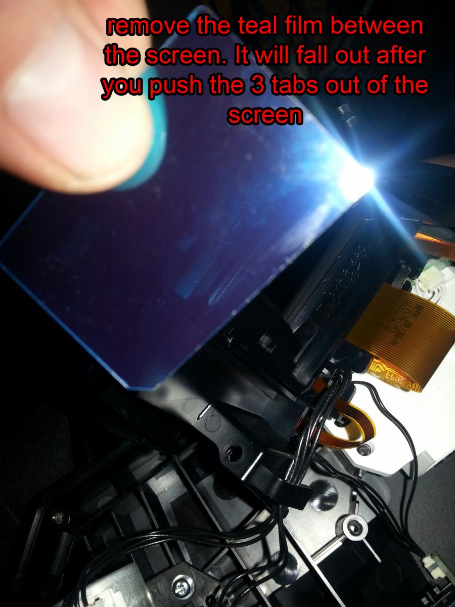

So i am installing HUD in my 2013 LS, and i HATE Teal! I have already done the LED swaps in my cluster and radio myself. I am currently installing HUD in my car and do not want the Teal color!
I tore open my HUD unit to find out where the teal color came from. The LED's are white, after testing, which lead me to believe there was a teal filter and i was right. There is a Teal film sandwiched between the HUD screen.

Here is the result without the teal film, its a lot brighter and a clearer image, it does not translate in the picture at all.
its more white, just a light hint of blue and no grainy rectangle box outline.
i will try different films to see the color differences and post pictures
This is also a non HUD windshield

So i was able to kill the teal tint altogether.
there is a reflective teal mirror.
I replaced it with a clear mirror to test.
i will do more testing before i post the rest of the results.

So i cut a new mirror to replace the teal mirror, sanded the edges smooth and it fits perfect
I think i figured out a way to change colors with the gels, so you can change the color under the dash bezel, rather than opening the unit each time.
Basically i put a clear mirror, took out the teal gel, so the text is all white now, so my next test will be putting the gel film under the dash bezel to see how it affects the colors, and post results.
I'm shooting for making everything clear inside the unit, then being able to change to any color without removing the unit each time.
