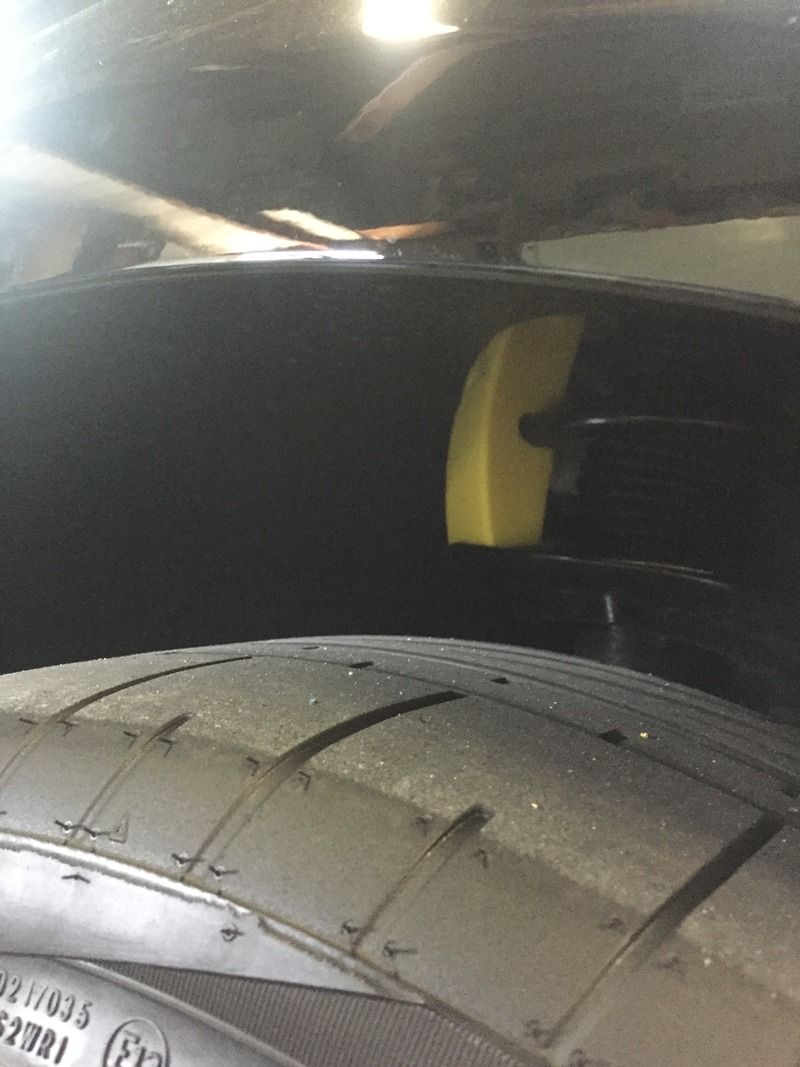

Spring spacer
No wonder it sits so high! I do not want to waste a day dropping the car off at the dealer for this. Can I do it myself?
Thanks

Another dealer failing to do PDI properly. You can pull them out yourself if you can jack each corner up to get the weight off the spring.

jack up the car by the frame and let the tire droop...reach in and yank out the spacer

Dealer left the spacers in mine, too. ~225 miles on them. I'm bringing it in to a closer dealership this afternoon, hopefully they won't give me any lip about removing them.
