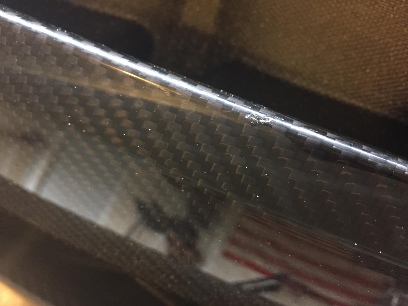

I was polishing the hood and the side of the polisher took a little knick out of the clear coat on the hood vent. Any advice on how to fix this? I have a clear coat pen as well as a wet sand kit, but I don't want to make it worse.

I decided to use the pen and then lightly sand it tomorrow and hope it looks better

You can't tell from the picture, but it's pretty noticeable. And I don't care if it's a track car or not. It has 260 miles and haven't been able to get it to the track yet. It should be flawless.

Know how you feel mikeyg36. It does look like you need to put another coat on there before you start wet sanding. It should be a raised bump before you start.
Go slow, you'll get there.

I don't have a picture of it but it came out completely thankfully. There's just a tiny little bubble that looks like it came from the factory.
