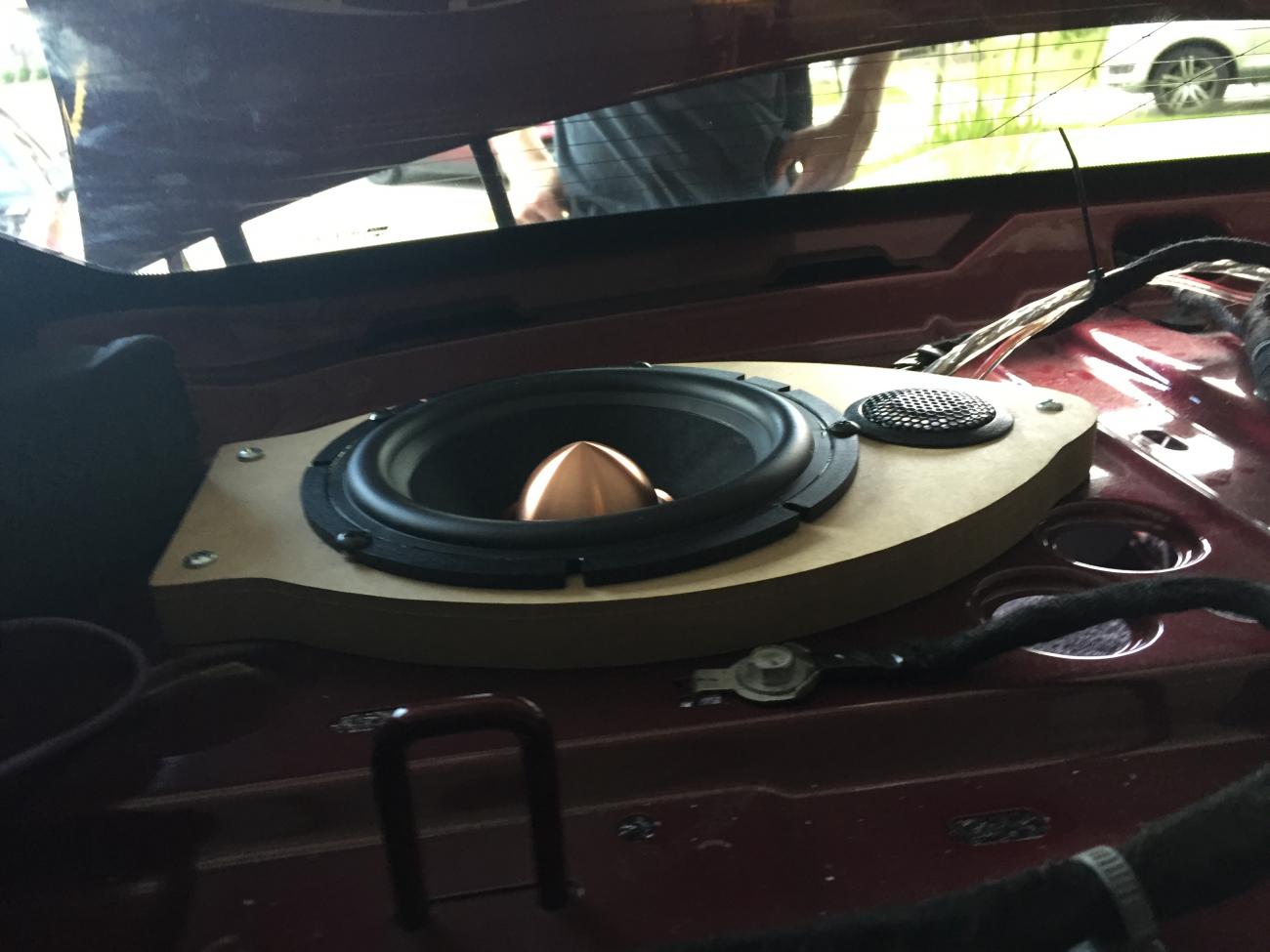

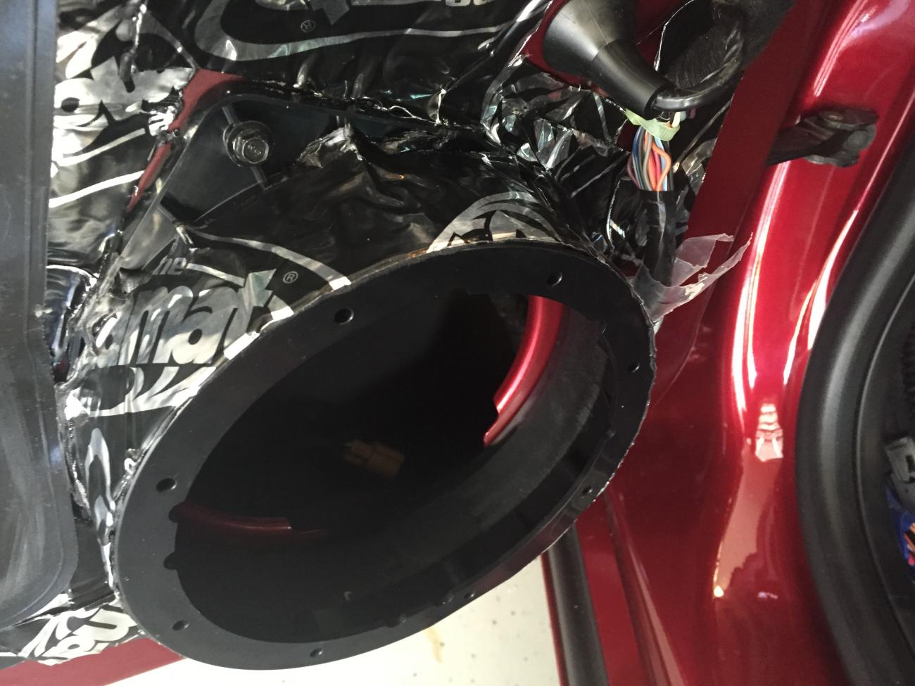

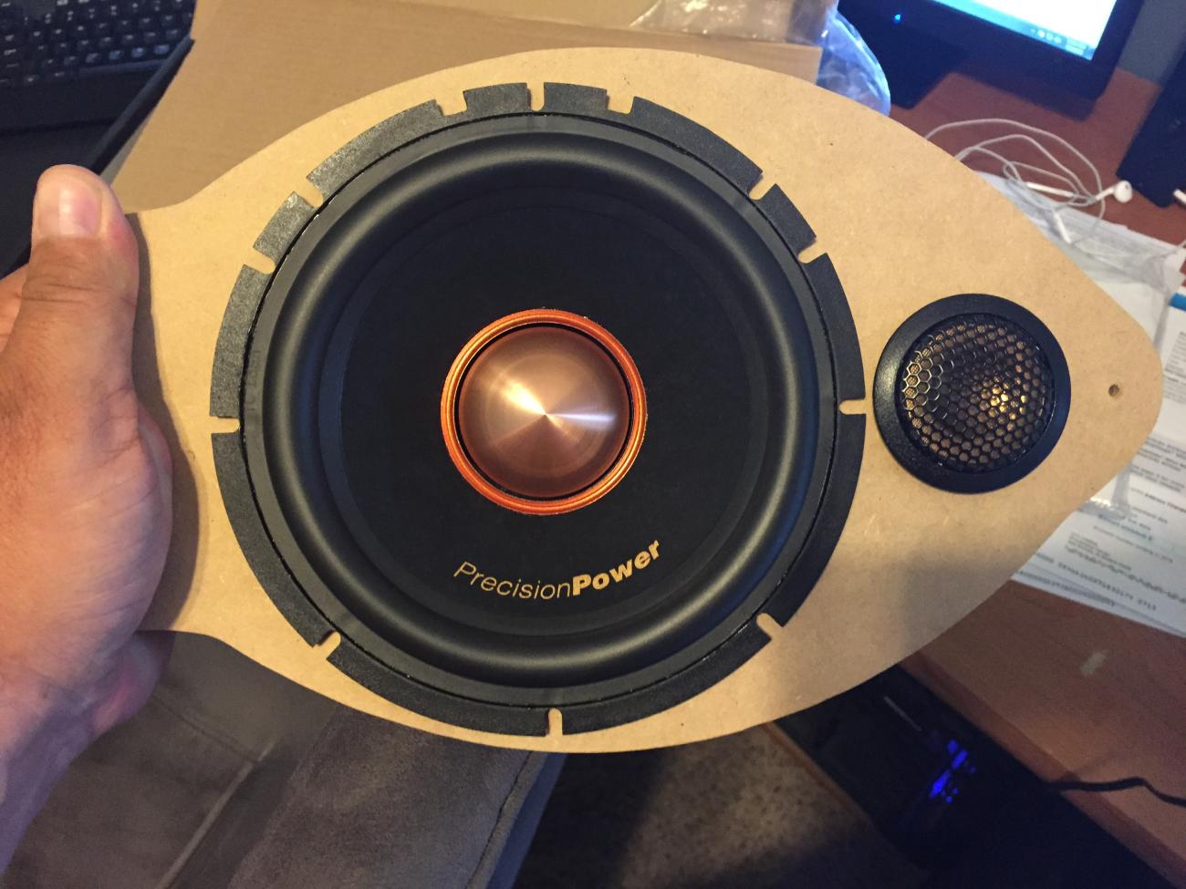

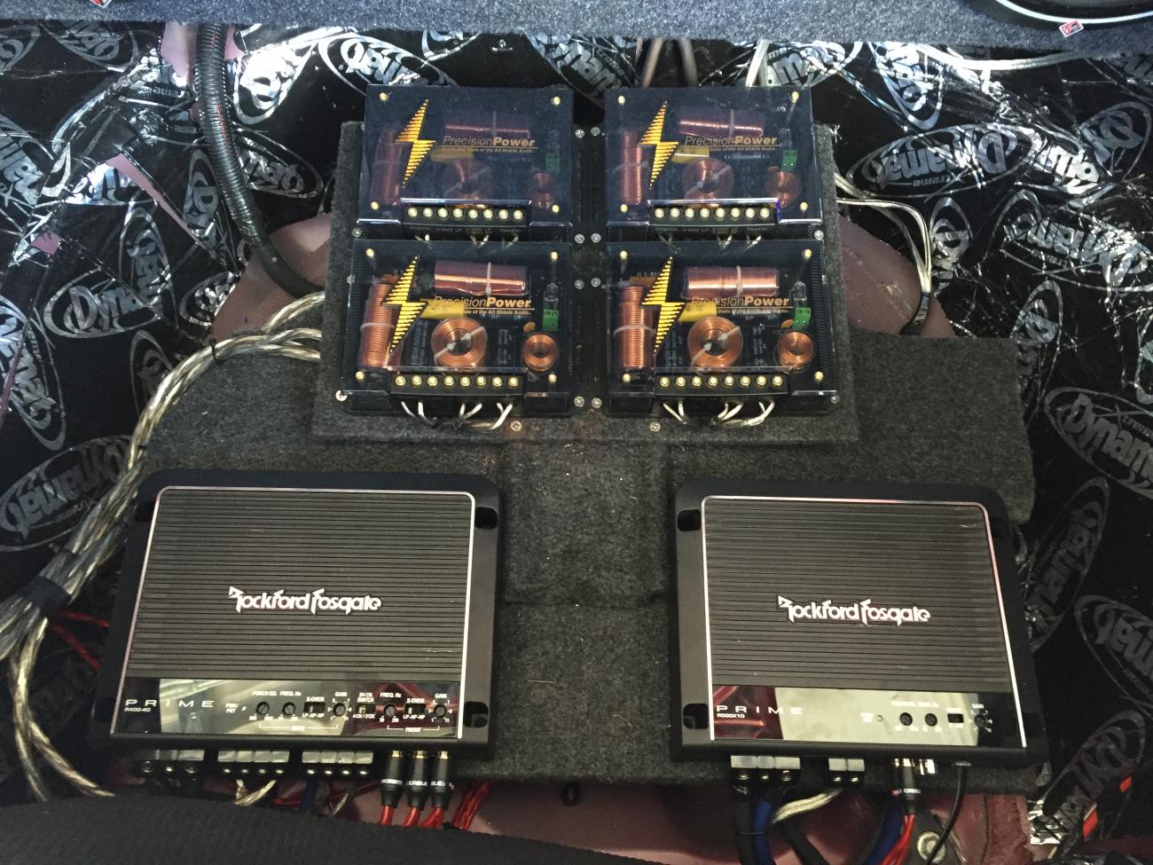

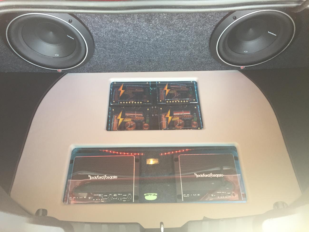

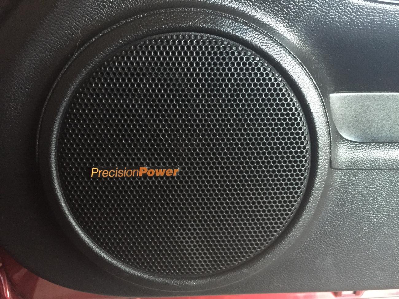

This weekend was spent upgrading the sound system from the BA to PPI/RockfordFosgate.
Precision Power PC2.65c components front and rear. Also added a Rockford Fosgate R400.4D 400w 4 channel amp for power and disposed of all the factory speaker and amplifier. Entire car was rewired using 16g twisted speaker wires and 4g power and ground wiring. Doors and rear deck were treated with Dynamat to prevent rattles and noise. Since the subs had been previously installed the trunk was already covered with Dynamat. The adapter plates were provided by Steve at Sub-Thump. Installation was done by Luke Lerick of Lerick Custom Designs in Houston and I will sing the praises of his skill set. All wiring was neatly bundled and run using factory pathways. Trunk floor was custom cut and upholstered using vinyl fabric matching the cars interior. Amp and crossover rack was also custom made and fully carpeted. Finishing touch of sound sensing RGB led's in the amp area showing through plexiglass panels that light up the electronics. The last pic of the trunk really doesnt do it justice.
I still have one more piece of the puzzle as Luke and I are working on an idea for a board to cover the sub box also upholstered in the faux leather to match with the trunk and interior. Hopefully have it done before Camaro Fest.
