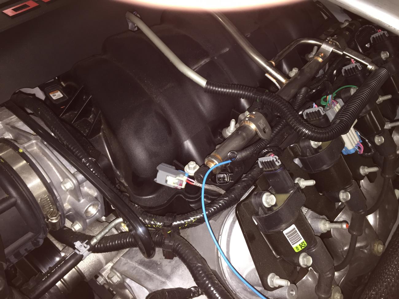

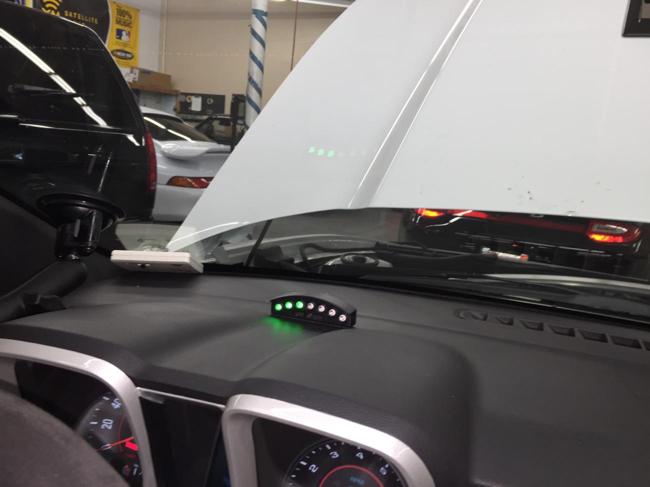

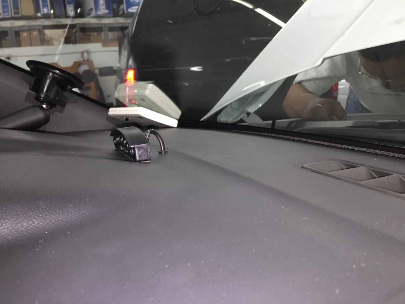

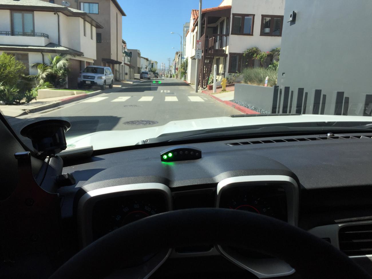

I had the Ecliptech installed. They picked up the RPM signal from the fuel injector (per alarm industry guidelines for this car. Looks great and worked without a hitch. I have now programmed it to start at 4000RPM so lights don't go up until you are into the torque curve. See attached pictures
