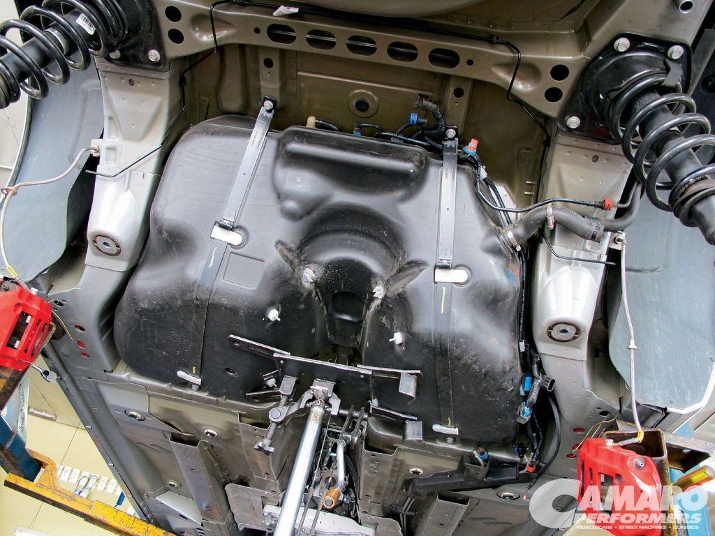

Here is a picture of the tank in 2010 Camaro:
This next photo shows the filler tube on right where it connects to the plastic gas tank. The whole Independent Rear Suspension cradle was removed giving a good view of the filler hose and clamp area.
Replacing the tank sure would not be a fun project if the car was not on a lift.
Photos are from a Superchevy project found here:
http://www.superchevy.com/how-to/pro...r-fuel-system/
Ron
