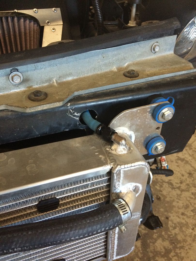

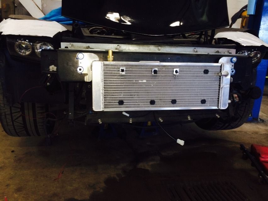

I was watch some vids from a vendor on here, I think the guy is from austrailia?
His seemed to work pretty good, just unsure of dealing with a guy so far away, but his system seemed well thought out and engineered, just still unsure, I spent quite a bit last year on tigershark front end and Afco HX.
The other 2 guys selling these seem a little sketchy.
Some pics:
LedfootLarry is offline   Reply With Quote
