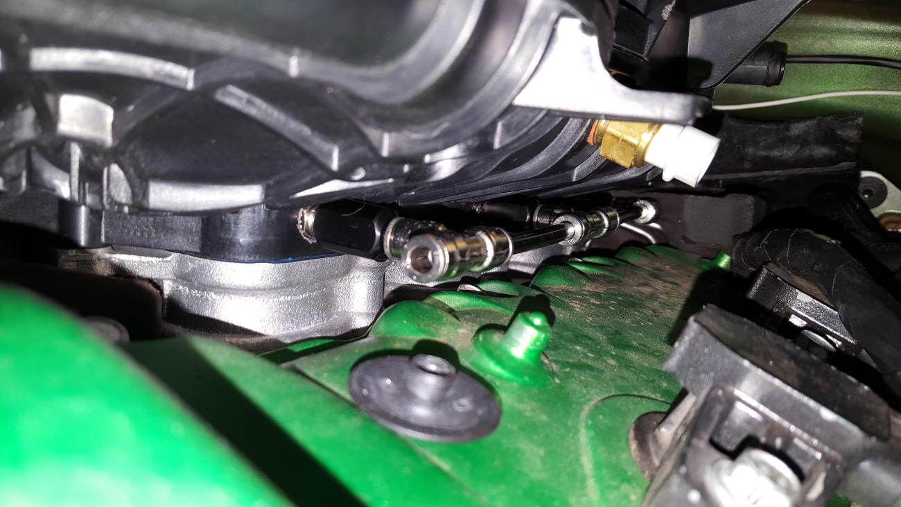

The aluminum adapter is too low, the nozzles holders would have been hitting the valve covers. If I had a 1" spacer below the adapter that would work, but the runners would be too long.
It wasn't too hard to drill and tap, but the big pain was getting all the shavings out of the manifold since you can't open the top like the LLT one.
I'll take a picture of it sitting on the engine tonight, you can see how much room there is. It will be possible to fab a direct port nitrous setup since those nozzles can be longer. Would probably look bad-ass.

Placed the manifold on top of the engine to show how much room there is. Yes the engine is dirty.
