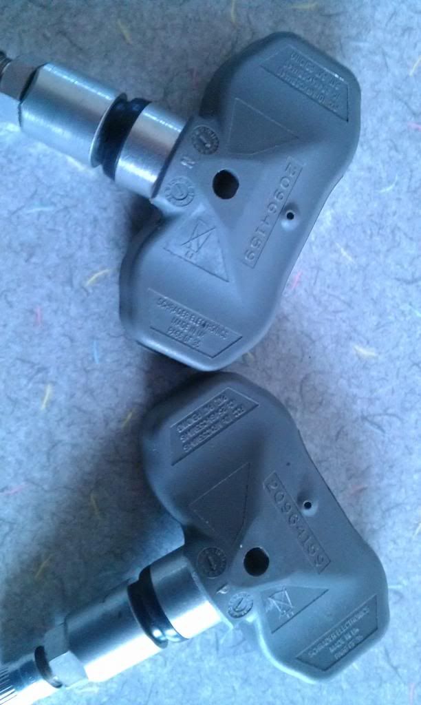

my sensors look like this with an 11mm/7/16" retaining nut below the schrader valve cap.

Thanks for the pic! I'm using OEM GM sensor. I don't remember what kind of stem they came with anymore (bought it from an online dealer as OEM part), but it had the rubber stem like this one:
http://www.ebay.com/itm/Buick-Cadill...pV4o91&vxp=mtr
Did yours come OEM with the metal one? The technician at discount tire said all GM cars come with the rubber stem that I've pictured before, but when I search, I find both kinds available. I wonder what kind of stem they originally come with..
EDIT: Here is a thread for OEM sensors. I suppose they indeed come with the rubber type (at least they did at the time of that posting of 2010):
http://www.camaro5.com/forums/showthread.php?t=66302
Here is another OEM sensor thread, this time from ZL1:
http://www.camaro5.com/forums/showthread.php?t=302085
It also seems Amazon's OEM sensors come with the metal version with the retaining nut:
http://www.amazon.com/ACDelco-209641.../dp/B005OVI6L0

Mine are OEM and all metal like Stephen's pic.

Without digging up numbers there are Cadillacs with metal stems. Both are available, I got metal at some point but it was a long time ago. The tire shop said the metal ones fail faster, I assume from the unions.

I called Discount Tire, and asked about types of stem. They said my sensor only accepts the plastic stem (I provided the TPMS sensors originally). He also said the metal type is usually more problematic, especially when you hit a curb since they don't flex much.
At this point, I'll chalk it up to them using the old stems and closely monitor pressures, using tires at the same pressures.
If it happens again, I'll switch to the other type and try again.

my factory sensors are of the metal variety in the Amazon pic posted above. My 2009 GMC Sierra had ones like you posted with the rubber valve stem. I am still using the factory units and have had tires replaced without messing with the sensors. They may have changed the plastic washer/gasket when the tires were swapped...I did not ask and they told me nothing.
