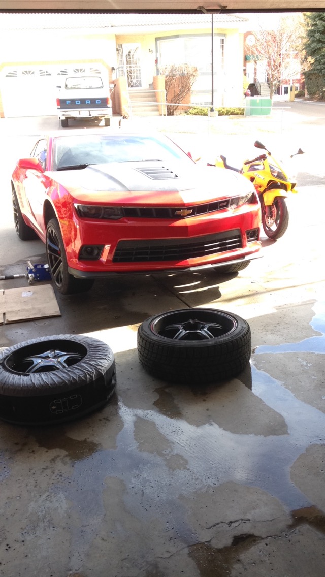

I was switching to my summer tires , jacked the car , put stock rims on , set the bolts and everything, sparyed a bit of WD 40 ( not to rotor or callipers) , brought car down , and then I can't get to move the car ! ��. feels like if you were trying to start with e break on . of course e break is not on but lever feels weak , maybe the e break line broke while it was on ? what can I do if I can get my car to move not even 1 inch ! . anyone went through this ? it's brand new ! I have 7247 miles
****UPDATE**** : so, after reading all the responses in this thread, I rushed to the dealership today at 6am, armed with two jack stands and a lug wrench, and while car was in there waiting to be serviced (which they told me they would look at around 7am) I switched the drivers tire to the rear and viceversa. Everything is fixed now. I went back inside the dealer to get my key back and explained what I did and they had no clue that rear rims are wider than fronts, just like me .
I feel so silly for not knowing and going through all this but oh well, lesson learned. Now I know even 1LE's have same tire size on all 4 cornes, they do not have same size of rim. There was pretty much no damage done except for a small rim rash to the inside of the rim and a slightly scratched shock which of course they cant be seen.
I would like to thank everybody who helped me on this thread to find out my problem and I really appreciate your input.

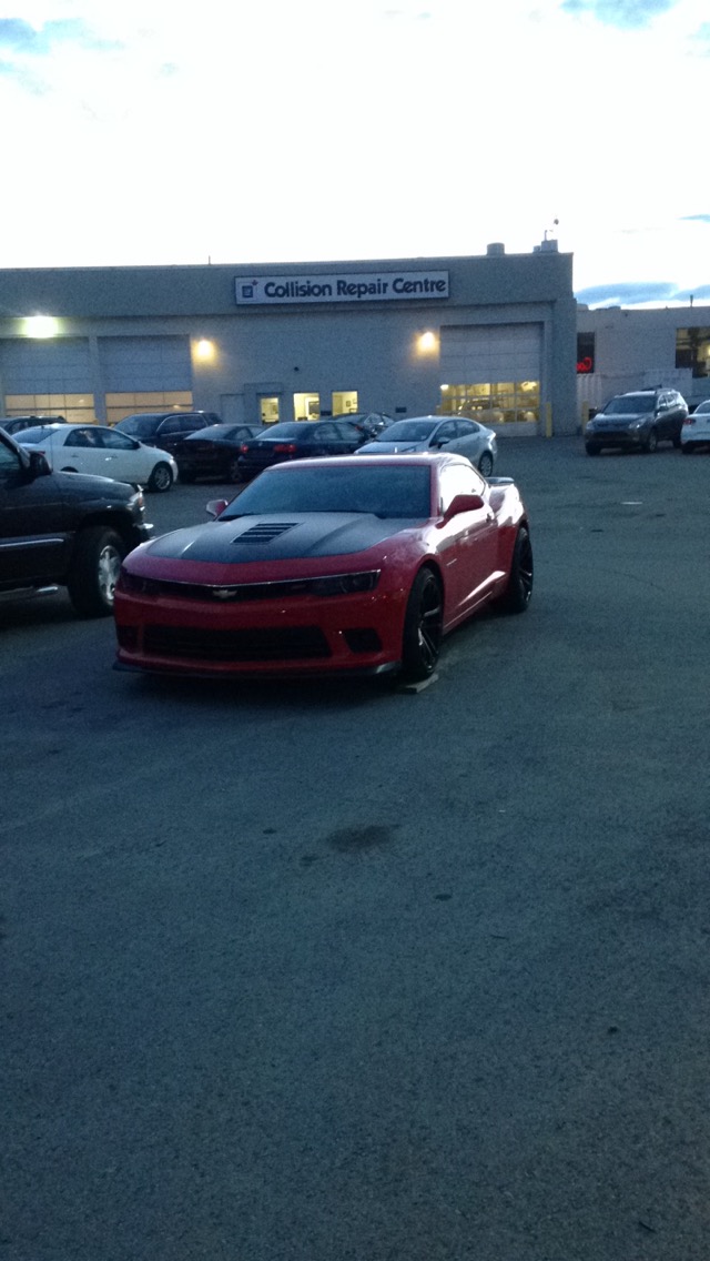

So I called road side , and they sent a flat bed , while loading , all tires were rolling fine except front drivers side . grind drivers side wheel had to be dragged to get to flat bed . I don't really know what could have gone wrong , I have changed my own tires like 4 or 5 times on my previous as and second time on this one . I did absolutely nothing to breaks , just unscrewed tire off then stock rim on and that's all .

now is at dealership , I hope they can find out what's happening and I'll keep updated as soon as I hear from them
