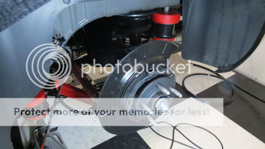

Initial assembly completed on Drivers Rear. Everything seemed to fit real nicely. Torqued specific bolts that are not subject to Bushing Timing (Strut Plate to body, Toe Link, UCA Bushing Saddle Bolts, Bolts at Knuckle). Will tighten those subject to "Timing" after Cradle is raised and bolts tightened, Caliper is loose installed, Rotor, and Wheel installed, and car is lowered on it wheels, and finally ride height is adjusted on the Coilovers. These are the UCA Bushing Bolt, Trailing Arm, LCA at Subframe, and Shock to LCA Bolt. Before I raise the Cradle, I will install my Magnaflow Resonator while the exhaust is dropped slightly, and change the Diff Fluid. May have to go back and forth a few times depending on the access to certain bolts, and the ride height results. As for now, this is some mighty fine looking stuff.

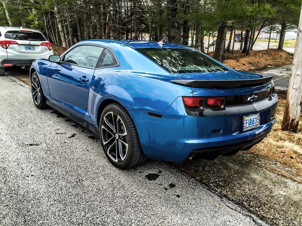

New wheels

Originally Posted by evh5150vanhalen View Post
New wheels
Very nice! Which wheels are those?
