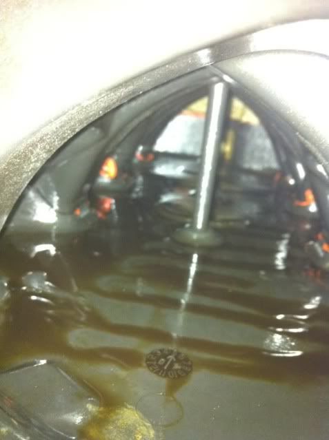

To answer what we missed, most automakers have recently lowered the warranty period on the power train due to some of these issues. GM in fact just dropped from 5 year 100,000 miles to 5 year 60,000 miles (most GDI engines will be running rough, hesitating and having misfires by then so this reduces a huge liability for them)
Most any LS3 or L99 owner just needs to simple remove their TB and shine a bright light inside to see the severity:
http://s1083.photobucket.com/user/tech17/media/Oilinintake_zpsczr8qjpd.jpg.html][/URL]
Now, the average owner that just jumps in and drives and does not log KR and pay attention to excessive oil consumption, this will most likely never be noticed in the old port injection LS engines, but this is doing NO good to anything, and the detonation and increase KR means your engine is always running at less than optimal timing advance. Power and MPG are down then, and this is what causes the ring lands to clog and prevent rings from sealing properly compounding the oil consumption and blow-by issues. As for throttle bodies, plenty of examples of the amount of build-up on the blades and throat. This disrupts flow at the transition when the blade is opening resulting in hesitation and stumble depending on the severity. So dealers also do regular TB cleanings for this. Here are pics to show as well:

All I know is that when I pulled the duct work when I put the new air filter in, there was a puddle off oil in the duct. Again, the Traverse has 225,000 miles on it... That's a hell of a lot of miles. Still runs perfectly, burns no oil, gets decent mileage. I have record of every oil change and the longest I ever stretched it was 7000 miles and that was due to a long trip. I was even more shocked when I pulled the TB... No way did I expect it to look like that!
Here is a picture of the pcv system... And it's clear the intent is for the oil vapor to go into the duct between the filter and TB. The black hose comes from the block. Goes into the top of the check valve, and into the duct. Hot oil vapor meeting cool air is going to change from a gas to a solid. Thus you get raw oil. This is a horribly designed system, but low cost and meets emissions requirements.
I have a catch can on my 1LE and it catches the vapor and converts it to raw oil like it is supposed to do. I believe in it. Why don't automakers do this? Regulations and cost. Working in the automotive engineering world, let me tell you, they nickel and dime things to death and cars are still very expensive.
