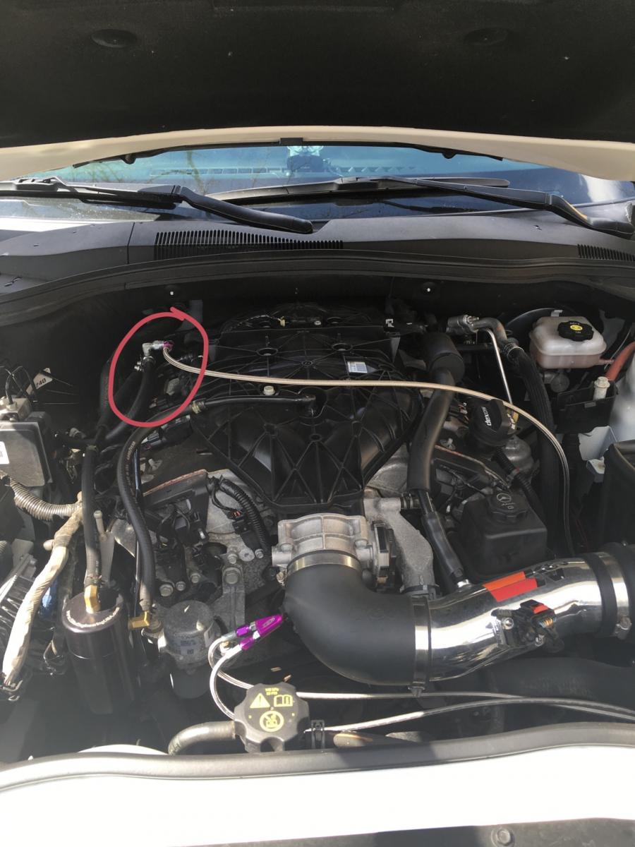

Overkill Motorsports E85 Install
Originally Posted by IneedAZ View Post
good news! i just got around to looking at the fuel connector at the back of the intake and its not the same fuel line connection as the one that feeds the Nitrous fuel solenoid. Plus the new station in my area is carrying e85 at 60cents/gal cheaper then 93, so i am willing to give it a try.
I am curious as to how your nitrous fuel line is. My kit gave me a replacement line with a t in it for the nitrous. I really want e85. There's a station not t far from me but the nitrous is limiting me sadly/:
I'll attach a picture now Name:  Image1461004710.869764.jpg

in the back of the intake you will see a cap in the fuel line. If u remove the cap you will see a schrader valve. I removed the valve and have an adapter to up the size to #6 line. That is where my nitrous fuel feed comes from.

I like that idea. But I also like the Schrader valve. Is it possible to put a T in the lines that will supplies with the e85? I'll ask Will what he thinks, just waiting on a response about some other things as well.
