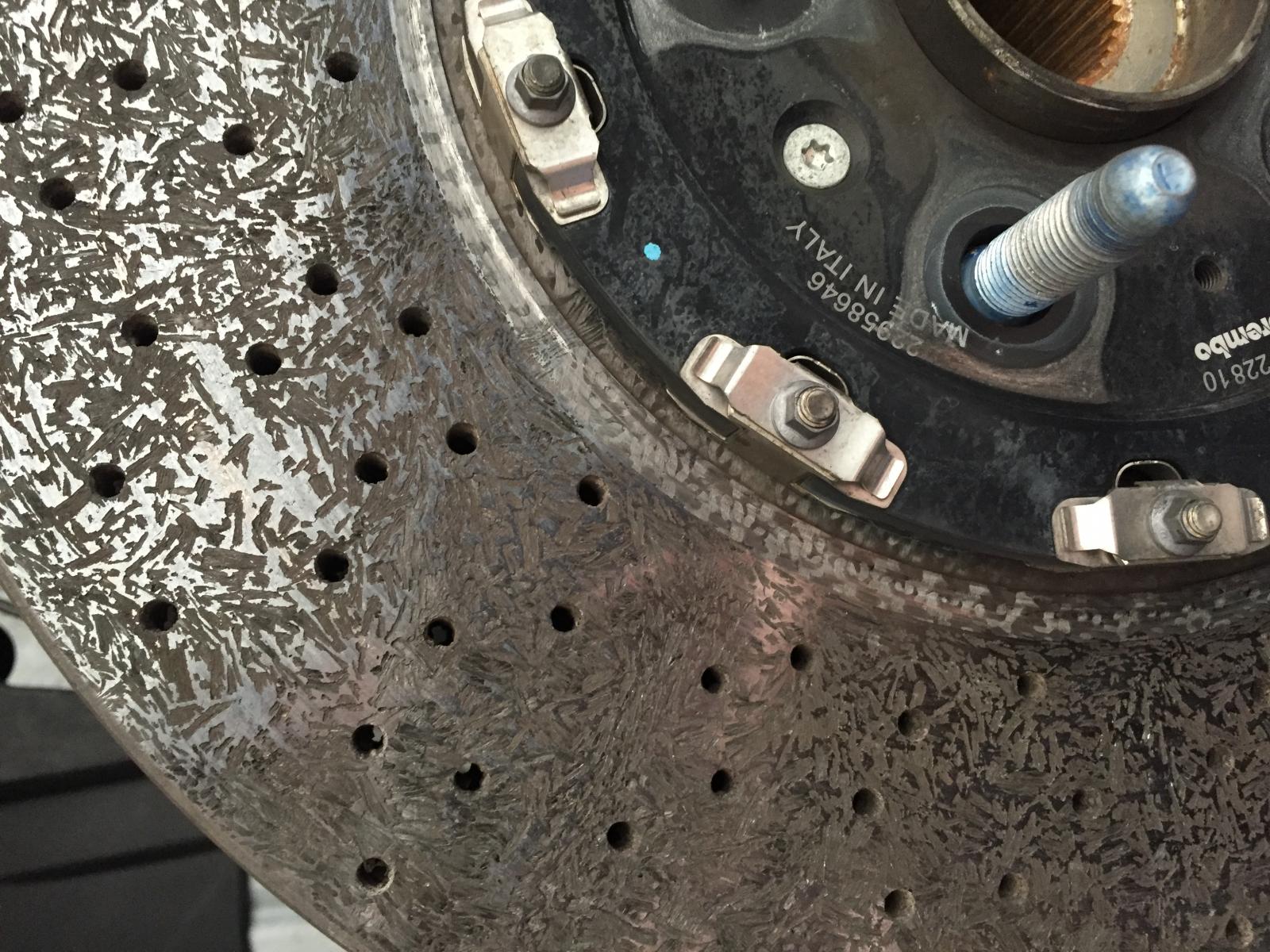

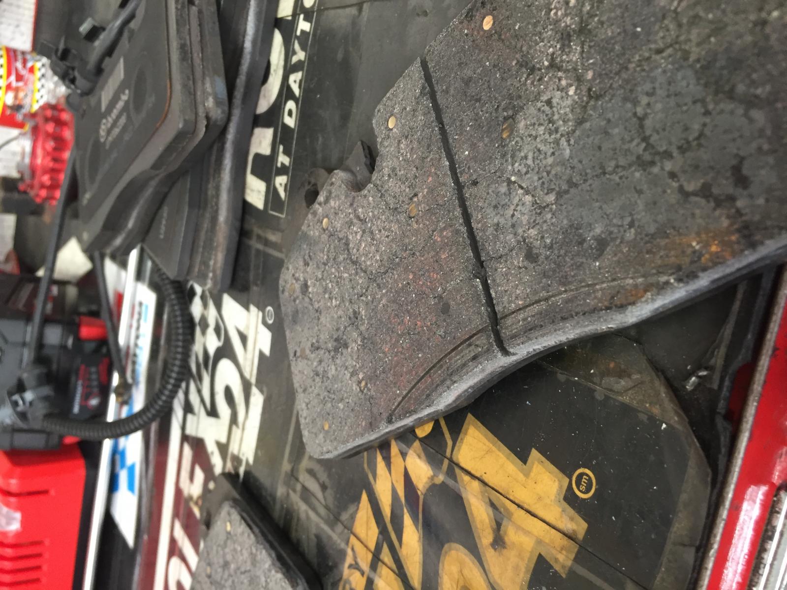

I have changed front Rotor pads once and everything seemed normal. I just changed them for the second time (and first time for the rear) and I noted an unusual indentation into the front rotors - the shiny ring on the rotor right above the hats. It looks like the pads put in a bead into the rotor. (See pictures). This happened on both sides of the rotor and on both front rotors. The result is that the cross section of the rotor where these indentations are is below the minimum thickness of the rotor. Anyone seen anything like this? What is the cause? Is this safe to race??? PS I only wore down the pads to around 5mm.

Mine look the same. I had a stoptech BBK on my M3 that did the same thing, only on the fronts. Have no clue why it does that, but never had any issues.

When you take the wheel off the rotors are marked with minimum thickness and minimum weight. We did not disassemble them so I can't say anything about the weight. However the rotor thickness is slightly higher than minimum except for at the area where these grooves were cut into the rotors by the pads. There it's well below the minimum considering that the grooves are 0.6 to 1.5 mm deep, (each face is different).

Was there any resolution on what caused this? I have the same thing going on after a new set of pads were installed.
