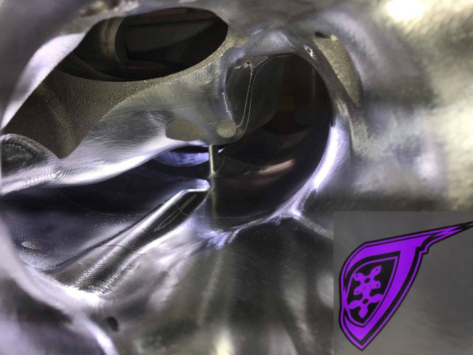

Good news! Brett from Jokerz Performance said my blower is done!
EATON rebuild kit, 90mm snout port, blower ported (not the runners) 2.45 griptech pulley with belt!
Can't wait for the pictures....

First photo from Brett @ Jokerz:
More to come!

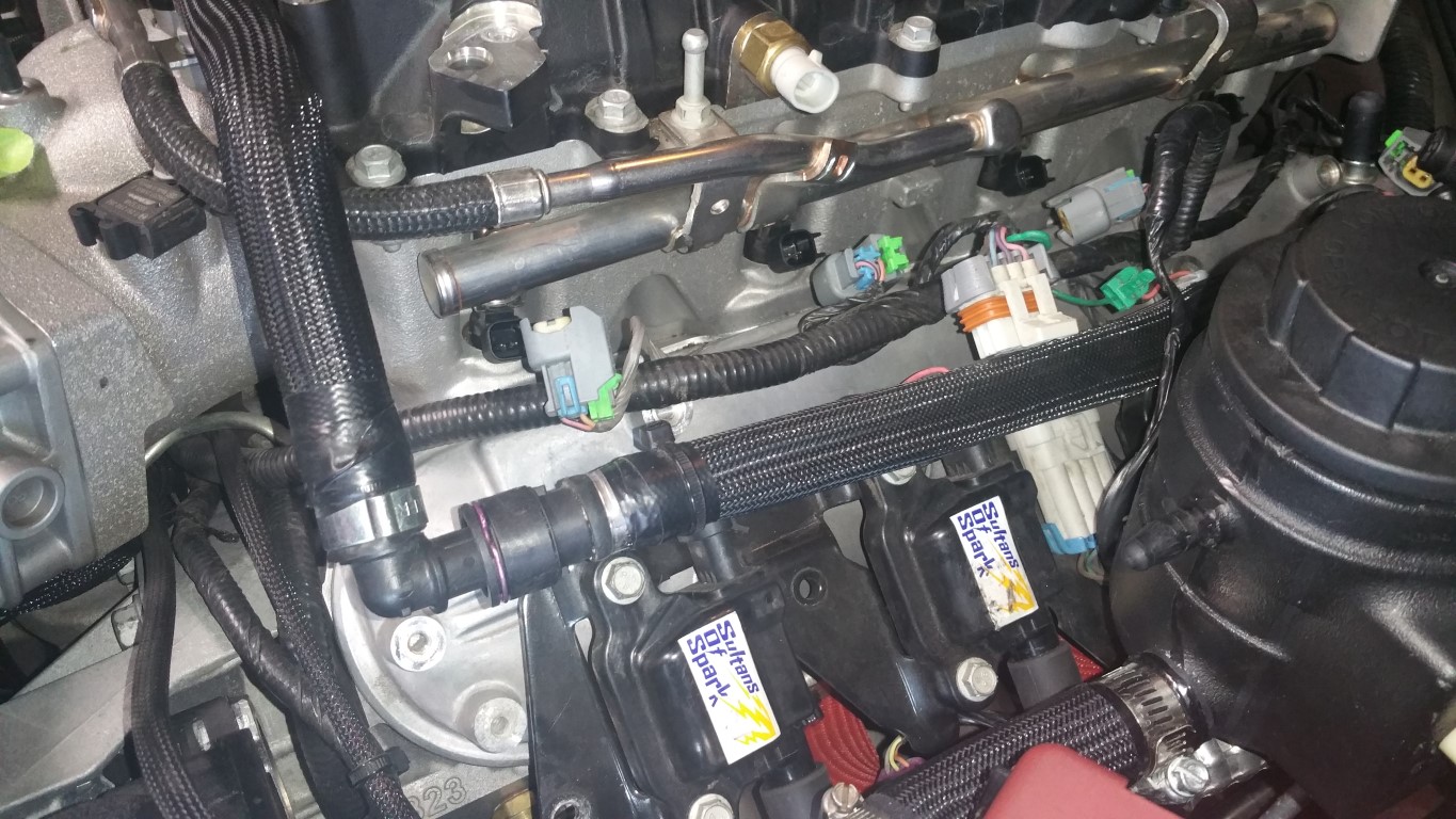

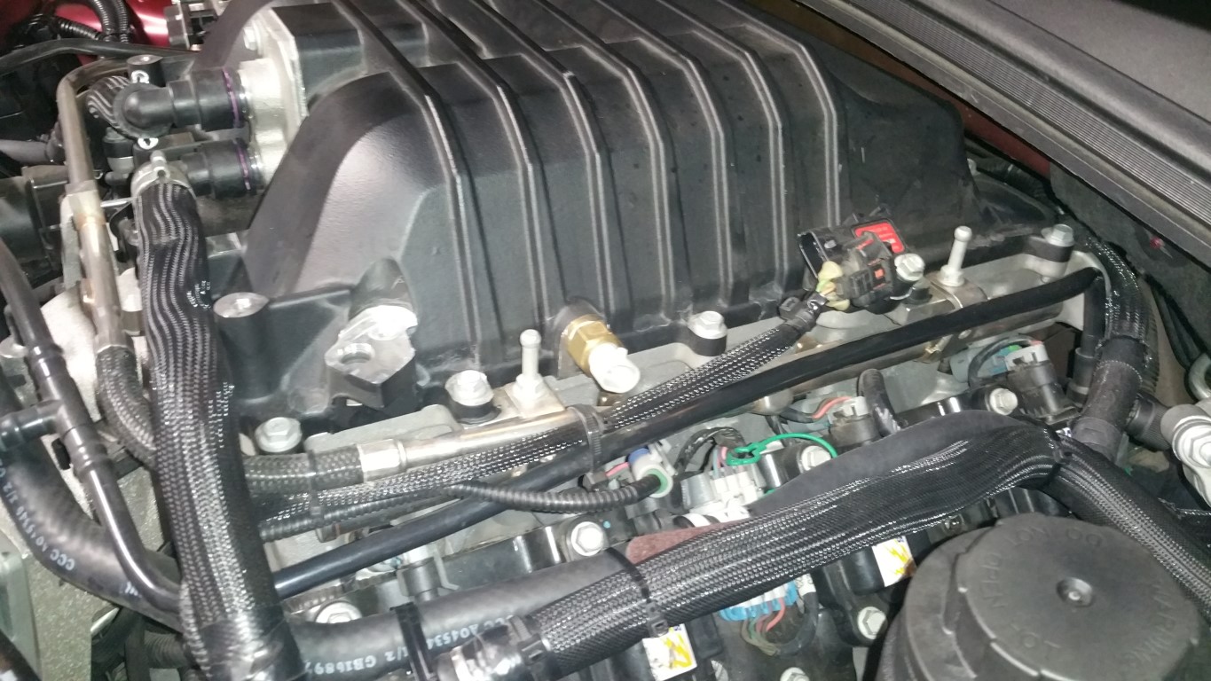

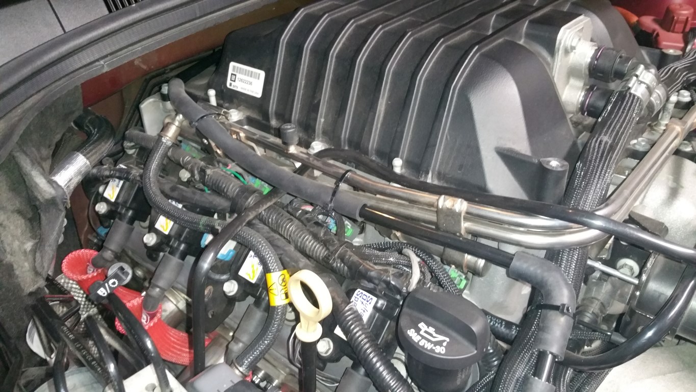

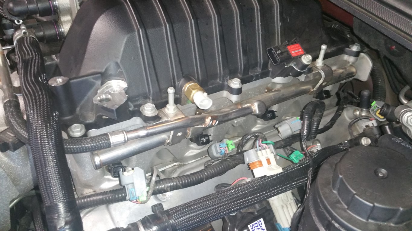

Jokerz Blower Install Part 1!
So, started the disassembly (of course, bag-n-tag and journal the disassembly):
Removed the connectors, brake booster hoses, coil packs, and noted where everything is:
I'll need to get the vac out and clean the area of the lower manifold to remove all the debris so nothing gets into the intake ports.
More to come...

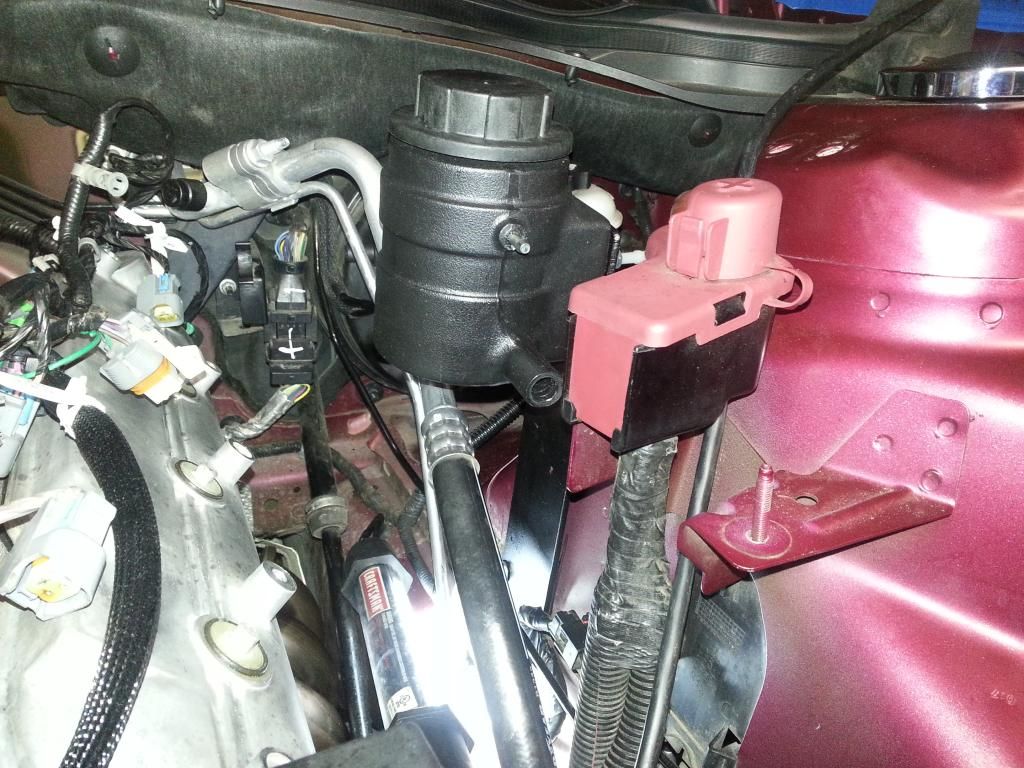

Originally Posted by hammdo View Post

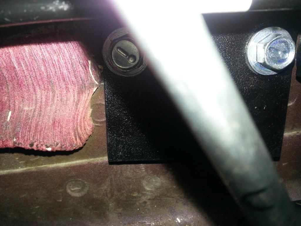

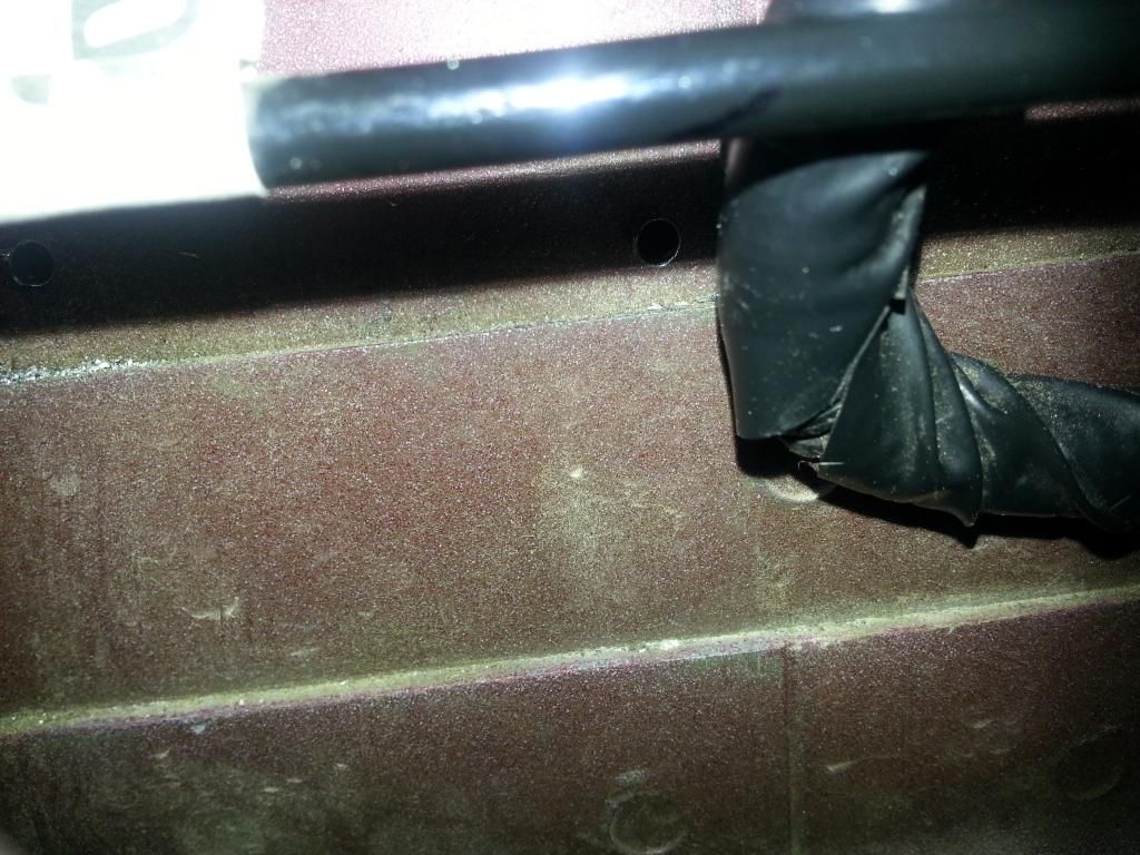

That was in the body already... There are 2 body holes from the factory, one above it also in line ( like this -- : )

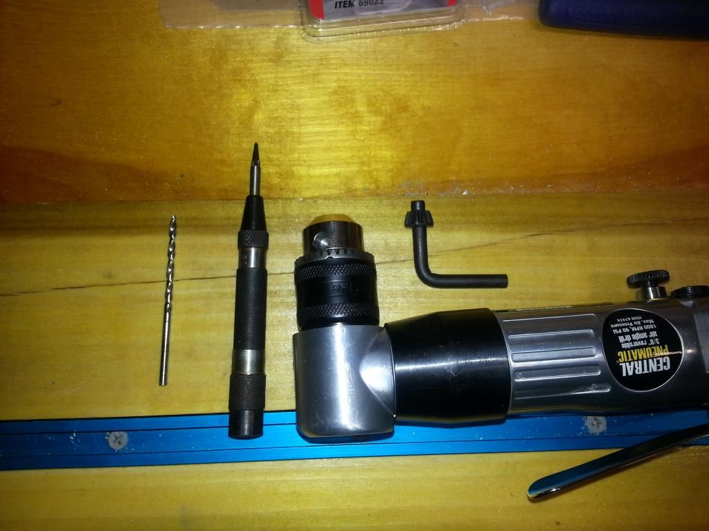

Now, with the following tools (small drill bit, automatic punch, 90* drill, time to drill the pilot holes:
Once the pilot holes were drilled, I then chased the holes with a 5.5 mm drill bit. Then, I used the self drilling screws and finished it the rest of the way (I did use a 3/8 air ratchet to assist with that):
Holes drilled:
Bracket in:
I have it 'offset' to allow the hose going forward to be exposed and to give me enough clearance for the strut bar:
Now, I did drop the headers so I could get better access to area to drill and also, be careful around the lines (ac, etc.). I saw the opening where I could put a longer bolt and a lock nut on the end. May wind up doing that just for a stronger fit...
I'll show that when I get to that point....
-Don

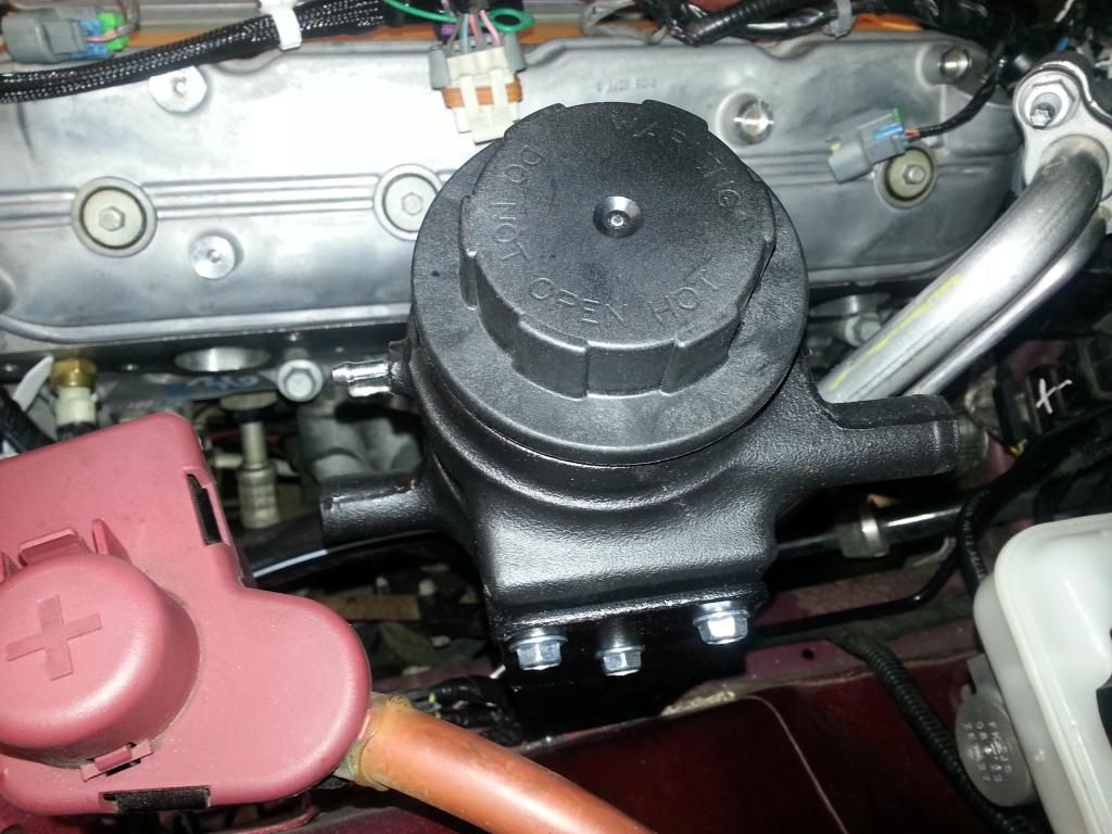

Don I'm consfused sorry, if I don't have a strutbar can I use the 2 pre existing holes down there to mount tank????
WhiteDevil is offline   Reply With Quote
Old 03-11-2017, 04:50 PM   #1148
hammdo
'It's an experiment'
hammdo's Avatar
Location: Dallas TX
Posts: 8,709
The reservoir needs to be the highest point in the coolant system. If they are higher and you have the right bolts, yes, but make sure they allow the reservoir to be higher...
-Don
747 RWHP 794 RWTQ
