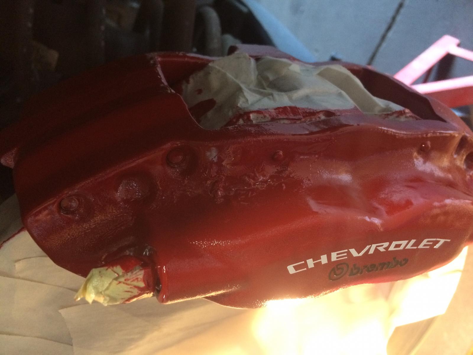

Not sure if this is noticable on the pic nut can anyone tell me what i did wrong. I used Dupli-colour caliper paint and then the next day i sprayed VHT caliper clear over to protect the stickers as i have read to do so. The paint started to bubble right away. Do i need to strip this caliper amd start all over now? And what is the best clear coat to cover them wih now?
Attachment 873307
Ah man, That sucks. What did you use to clean prior to painting?
I used the supplied brake cleaner that was in the Dupli-colour kit. Sprayed, scrubbed, sprayed and wiped clean. Then 3 coats of paint. Im thinking it is the difference in paints.
That looks like what happens when a clear lacquer is applied over enamel.
If the clear is also enamel, you missed the "apply within xx hours or wait xx days" window.
Regardless, time to start over.
