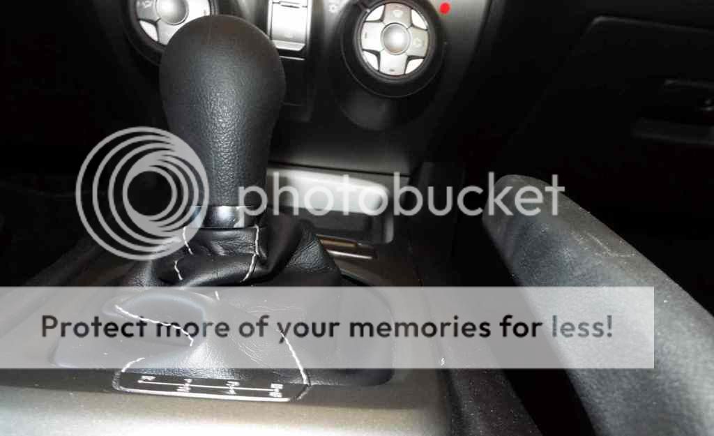

Anyways, I thought I'd try a ZL1/SS short throw shifter (part # 24260334) on it.
Had it delivered yesterday and my car up on the lift today. I started with the stuff from inside. Need fingernails or plastic trim tool for bezel around shifter & front pocket or gauges. T25 screw was in my '15's handle, 7mm's around shifter boot, and 10mm's around the shifter itself. 5/16th's allen wrench for centering spring bolts.

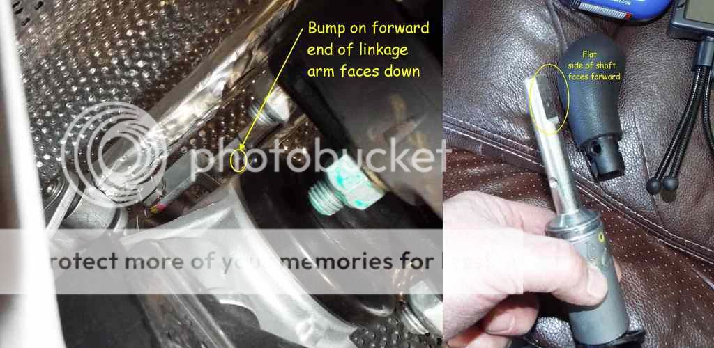

A couple tips that might save someone from having to get out from under their car to look up into on Google:
When putting the new shifter shaft up from the bottom, make sure the flat side where the knob goes is towards the front, and if you remove the connecting rod from the shifter to the trans, there is a small "knob" on the bottom of the rod, and it goes towards the front. Also, be careful of the O-ring that is on top of the bearing/ball as you put the shifter into the aluminum housing.
