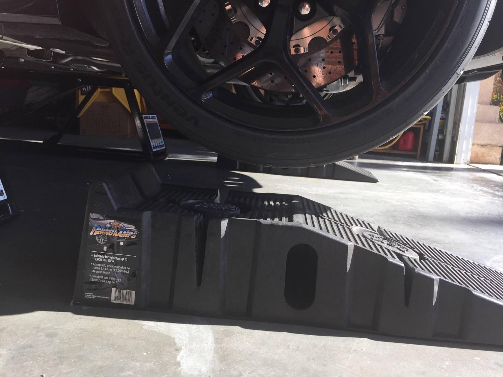

got the 7k model and it slides right under my Z. definitely much more room than ramps or stands

Attachment 856130Attachment 856131
lookin good man.. can't wait for mine. where did you put the rubber jack pads at for jacking it up?
i used the ZL1addon magpad on the jacking pts and lifted from there.
