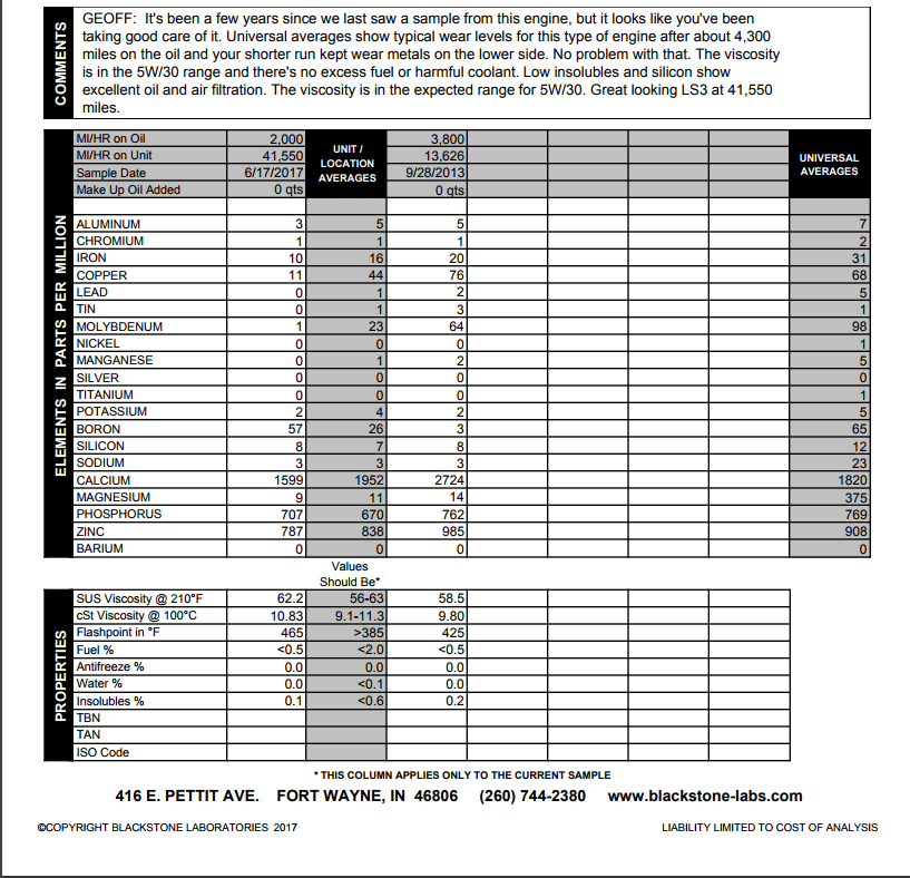

Here is an oil report that includes 2 track days. Pennzoil Euro L 5w-30 (Dexos2). Oil temps where consistently just over the 3rd tick on the gauge. Ambient was in the upper 80s. About 2000 miles on the oil before I changed for another track weekend.
