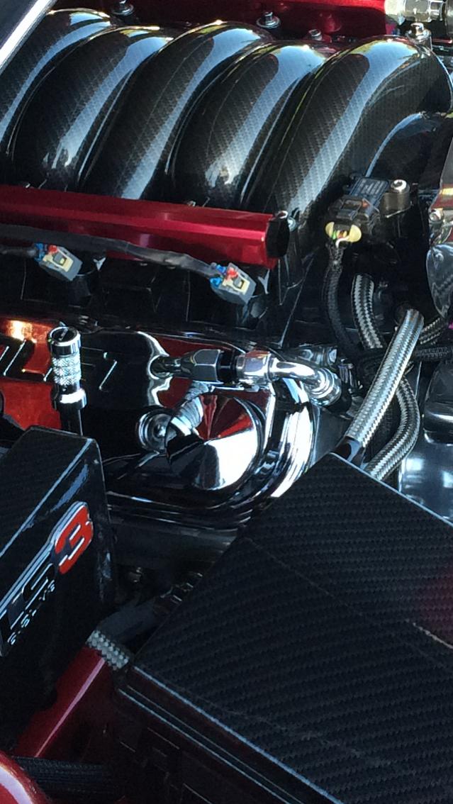

Here's the catch can...

Here's the oil cap I need to mod so I can get a clean air unit on similar to the factory big plastic one..I gotta take the plunge and buy the Elite clean side and see what I can come up with..
