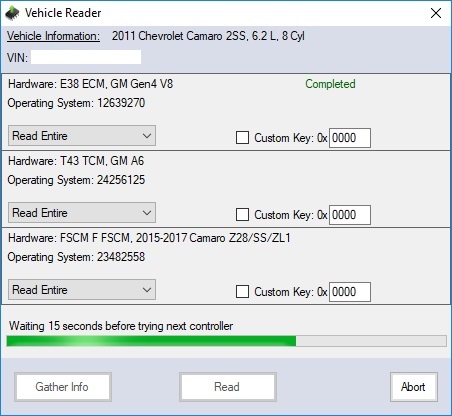

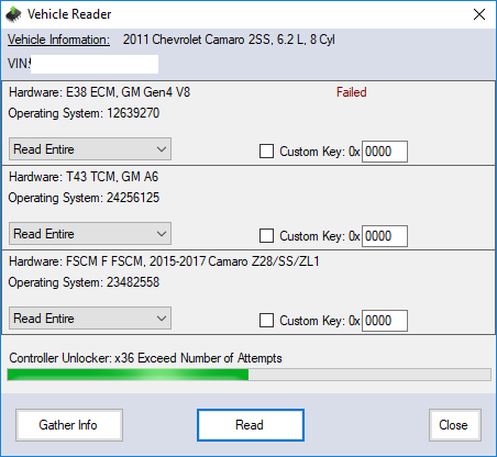

Well, my new install of HP Tuners is giving me this when I try to 'Flash->Read':
HP Tuners in their forum says its a locked ECM. Ryan has used HP Tuners and he does not lock the tunes.
Send a forum messages to Keith @ HP Tuners -- hoping he can lead me to what might be the issue.
Latest HP Tuners 3.6x, new hardware, can see it communicating, waited for 15 to 20 seconds before reading...
Hope to find out!
-Don
747 RWHP 794 RWTQ

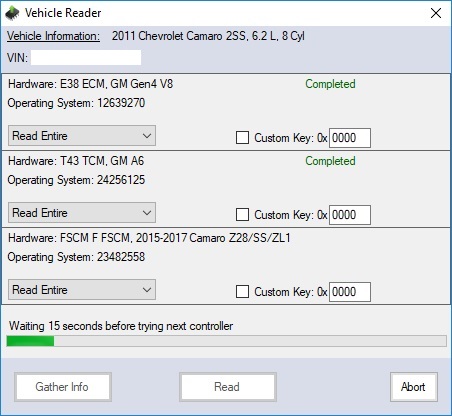

Don, select do not read, for the FSCM, and try again. I know it says ECM failed tho. I've done around 12 cars with mine and never had a glitch. You don't have to license the fpcm if you're not going to make changes to it. It will save you a $50 credit.
Did the A and B drivers install correctly for your MPVI during set up?

Yep, both installed correctly. I opened up driver manager while the unit was in the USB port to verify.
Ryan is checking to see if my autocal may have locked the file based on file type.
I'll try the FSCM... just to make sure. Thanks for the tip!

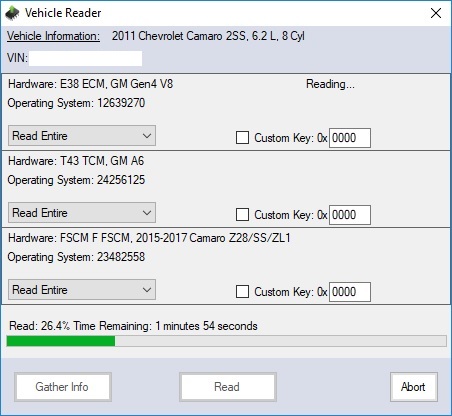

HP Tuners Working!
Success!
It turns out that AutoCal/EFI Live 'lock' the file (not the ECM), thus no other software can read it -- appears to be on by default -- I asked Ryan if he could send me the files unlocked -- I uploaded them, and finally HP Tuners could read:

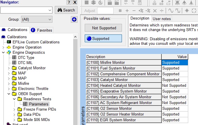

Now, to find the OBDII Readiness Monitors in HP Tuners -- Like EFI Live has:

Under the DTC tab, set whatever you're looking for to NO ERROR REPORTED. Should show ready after that. Is this for inspection purposes? just curious

Yes, I don't have an EGR System, and for some reason, its on. I did check the DTC and all of them shows not reported, however, the readiness tests shows 'Not Ready' vs 'Not Supported', which in my case should be 'Not Supported'.
Thus, why I needed it to be set to the correct setting. I had it done in the past with EFI Live. EFI Live has features HP does not...
Thanks!
