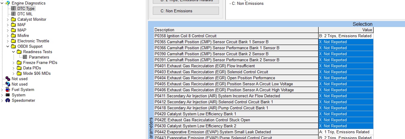

Hmm. Ok, I gotcha Sarah's car is VVT. A quick readiness test just shows incomplete on hers. I guess that is the same as "not ready" ?? Her stock tune file has all EGR DTC's set to no error reported. From what I've read it's built into the grind of the vvt cam itself and no physical valve. Just trying to wrap my head around it. Lol

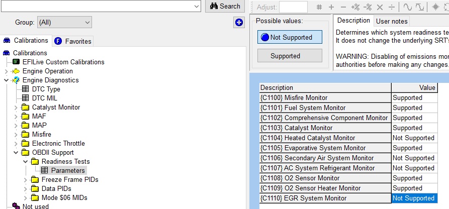

Incomplete is not ready. In Texas, 2 not ready means fail. She is in the same boat as me if you can only have one not ready. So no egr system with new cam. Set it to not supported, problem solved... I have EFI Live coming so I can resolve the no EGR present by setting it to Not Supported... LS3 and LSA don't have that ;o)

Here is my 93 tune that was correct (before the updated blower from Jokerz, ID850s, and Corn):
Notice {C1110} EGR System Monitor? It's set to 'Not Supported', which is the correct setting....
That is what I need for this tune -- and EFILive can do that for me...
Not sure how it was set to enabled, as you can see, it was off...

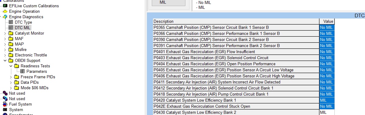

FYI, here are the DTC Settings on the 'correct' working tune:
And MIL Settings
Probably should set to NO MIL the 2 that have MIL and not reported.
Those are all off in EFI Live...
