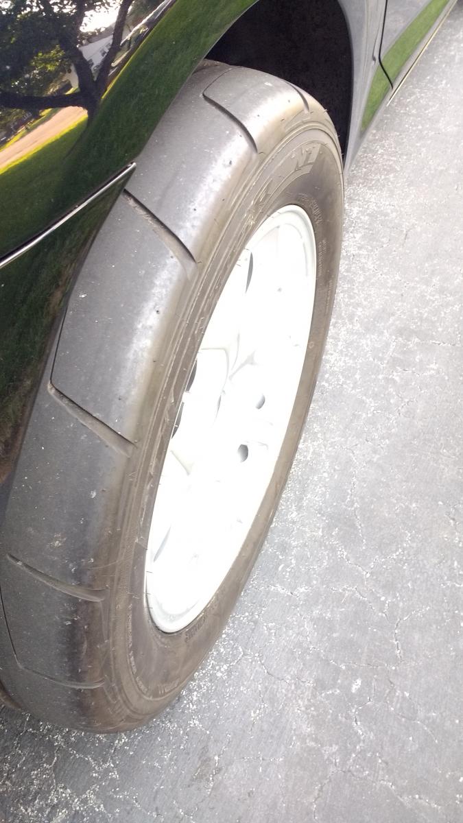

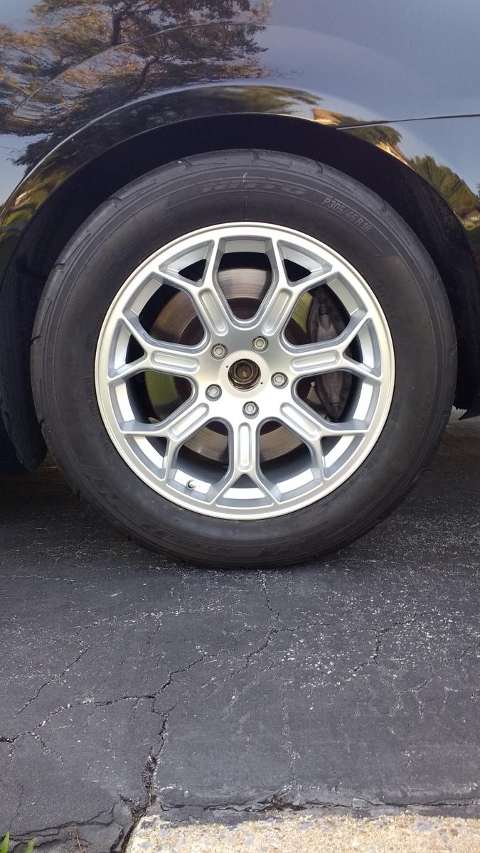

So patience pays in the end, $600 worth of Nitto DR's for $180(barely used lol) and new Motegi MR120 18x9.5($110ea Amazon) so for $400 I will now get to see what she can really do. This and the great advice and info from fellow C5'rs and peeps at the 'fest(plus hopefully my improved driver mod!) will make this next trip a real eye opener hopefully.
My local tire guy(fellow drag racer too!) mounted the DR's using bead sealer(can't use screws) to address any possible rim slip and road force balanced the pair for $70 total!
For the visually gratified pic's follow..and GMS, I am using the same H&R hub adapters I had on the front on the rear also..puts the tire about 1in outside the fender('bout perfect IMHO)...

Like the new rims. The look is cool!

TKS! They are actually 'vette rims made back in 2012(!!!) guess that's why they went for such a low price..at 21lb fairly light IMHO(but very stout design!) and if the combo works I guess I will have to start lookin for front skinnies! I use H&R 30mm(!) hub extenders(not spacers) on all 4 corners so I can get away with the 56mm offset on these rims(will not fit without) and zero clearance probs on calipers or control arms...just tie the e-brake cable back and good to go..have about 1in clearance on the inside of the tire so no worries there....and with the 9.5 rim and this tire size when I drop the psi(will get close up pics at the track) to 20 or less should get a nice fat contact patch with good sidewall flex...at least that"s the plan!
