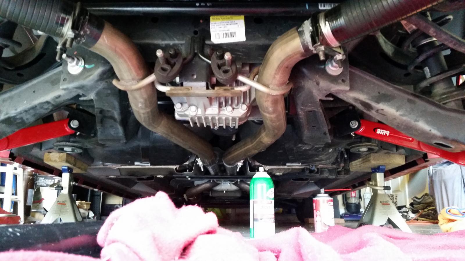

Installed BMR trailing arms and BMR outer poly bushings. Test drive tomorrow!

Nice! How difficult is this mod?

Bushings are a bitch to install. I remember the freaking pain it was, and my shop has a press that I used to get them out.
If you're going to swap bushings to BMR and haven't already, definitely recommend you swap out the front end lower control arms, radius rod, and steering rack mount bushings for outstanding stability on the road. Add an undercarriage chassis brace (I'm wearing the hotchkis) to avoid that ass from hopping around like it loves to do on these cars, and your car will feel like a rock on rails.
BMR bushings are great. A great improvement from the stock sets. Recommended.

Not gona lie the worst part was probably the bushings, i had to use a utilty blade to knife off the entire outer flange on one side, so the the press could push through the eyelet. I also ran into the issue of when i removed the stock trailing arm the entire hub assembly settled downward an extra quarter inch or so, so had to use my jack and lift back up until top eyelet on the bmr trailing arm lined up and then install bolts back in. Not too many steps, just some of them are quite tedious.

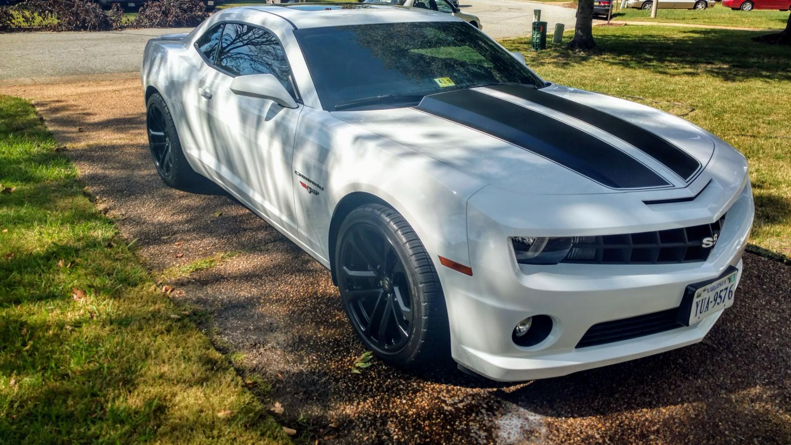

Decided to leave work early. Came home and washed it.

Don't mind a stupid question but to what end?
