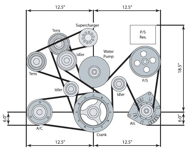

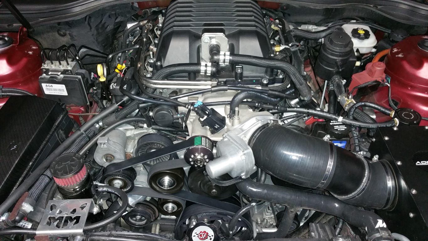

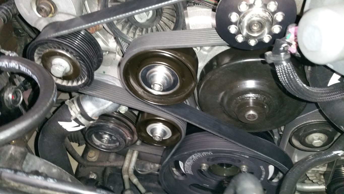

Update the idler pulleys
So, updated the idler pulleys:
Before:
After:
GM Diagram:
More belt wrap for the upper pulley!
-Don

That idler fixed also makes the turn from the crank pulley alot better since you have the big ring.
Very Nice man.....

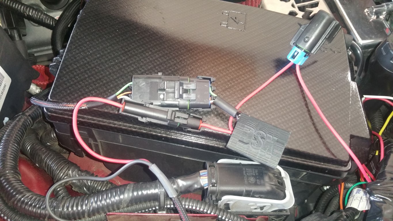

Did the 500 mile oil change -- drained BR30, put in DT40 (hit 98° today!). Re-torqued the sandwich bolt (I'm doing this every time I change the filter -- just to be safe), Installed the UPF48R oil filter (saved the old one so I can cut it open).
Installed the replacement Aux Pump module from DSX -- used the 1 Bar Sensor with key on to test -- worked like a charm! I did add some connectors to the module, just in case I ever need to remove anything in the future (like for upgrades etc). Here is how I have it now:
All good to go!
