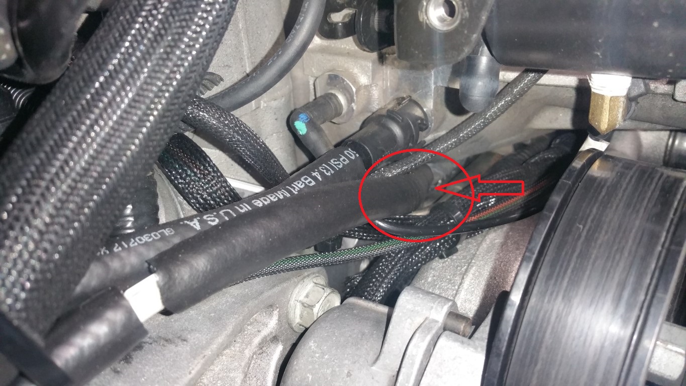

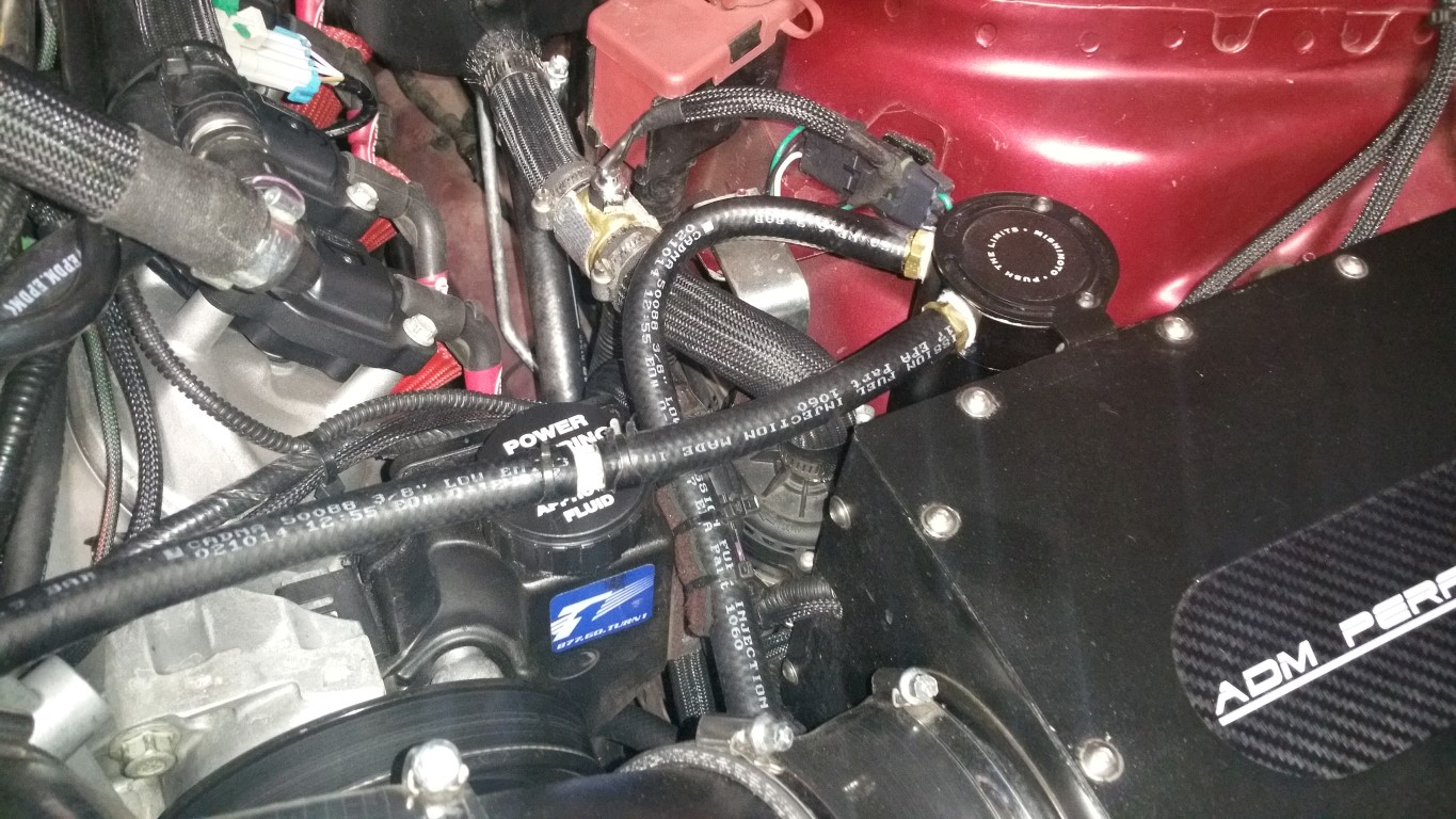

I am not so sure on how to set up the PCV-system and the catch can. I read once that you rerouted your catch can. Could you please help me on that?
At the picture below you can see that I already have on catch can preinstalled. Would you use a second one for the valve covers?

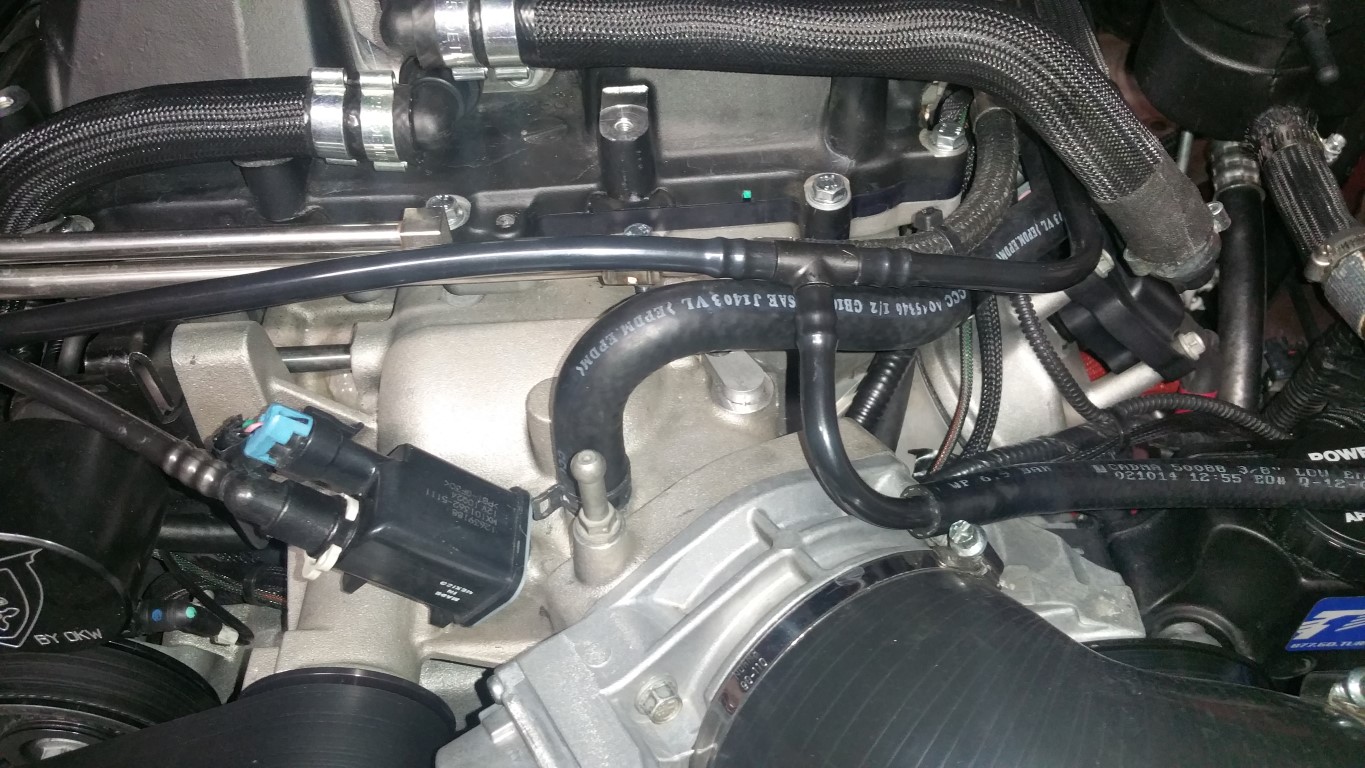

Well, I have the MightyMouse PCV version, so I'll go by that.
This is the "PCV" side and goes to the SuperCharger Manifold:

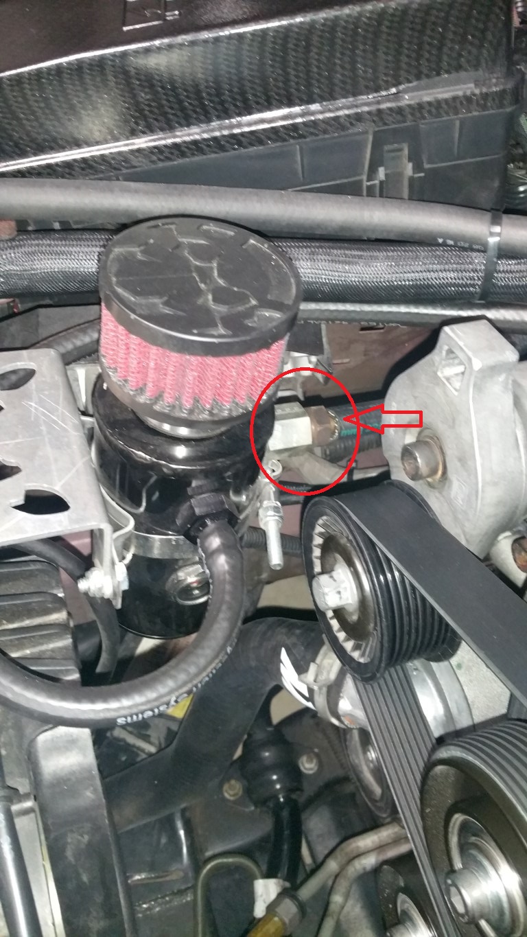

The 'valley pan' connections:

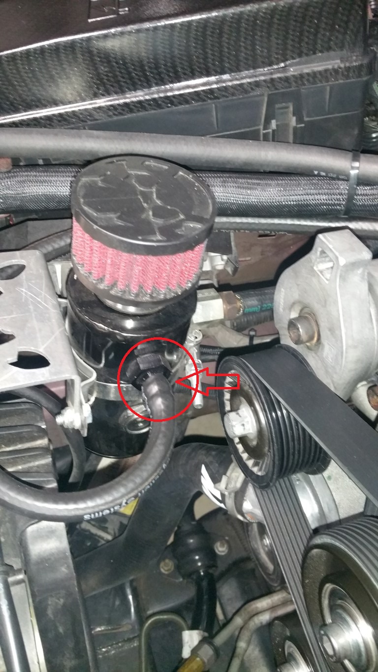

Now, I also ran the LSA valve cover setup like the ZL1 -- to its own catch can:
This way, I can 'vent' only when under boost and still trap any oil that may get by. I prefer this to an 'open' vented valve cover...
I know this works as I've not had any oil really sneak by -- very, very little...
