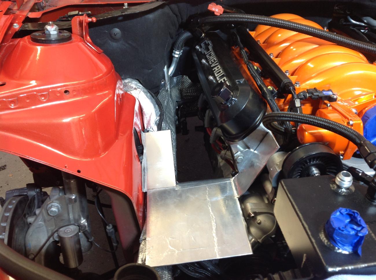

A little more done
Made a heat shield for a little more protection for the wires. And got the right injector connectors from FIC to get rid of the stock ones and adapters. Still have another 12 hrs or so to finish this thing up.

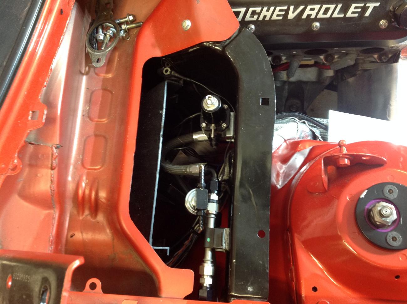

Posts: 251
The abs block,fuel regulator ,hob switch and flex fuel sensor all fit in here. And yes the cabin filter goes back in.

Old 11-11-2017, 01:22 PM   #37
That's awesome what a good idea
Powder coat it black
did you re do the lines for the abs block? or just kind of bent them into place?
They all had to be shortened and reformed to make it work. I've seen it done by just unbolting the block and forced there. But that doesn't get it compacted in the space as well.
