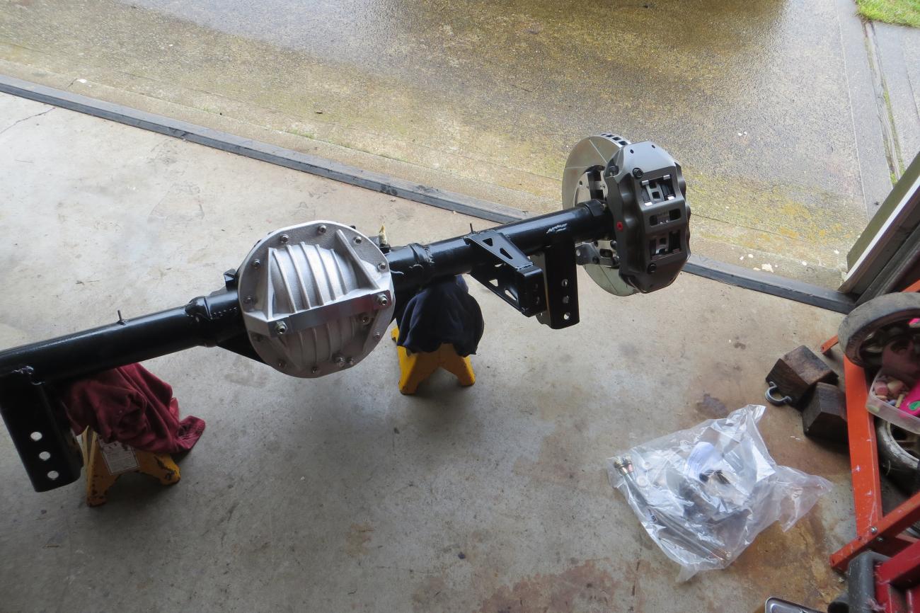

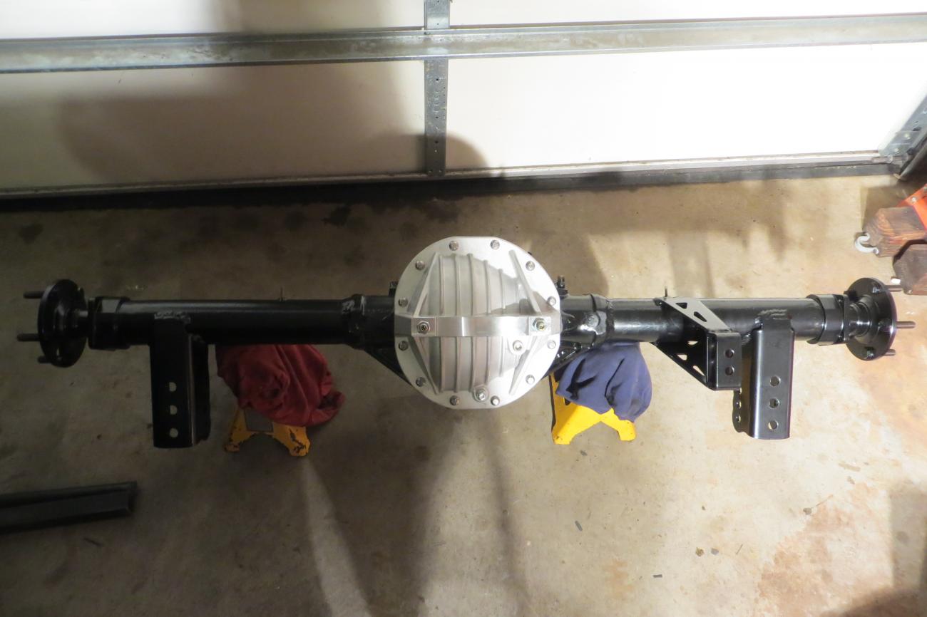

Finally got the rear end set up.
3:55 gears
33 spline Moser custom axles
Eaton Truetrac
12 bolt support cover
3:55 gears
Eaton Truetrac
Attachment 595330

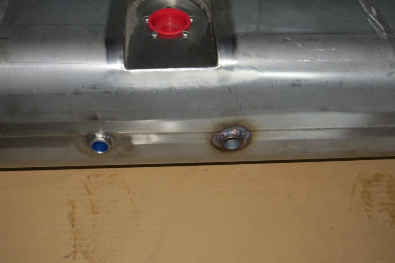

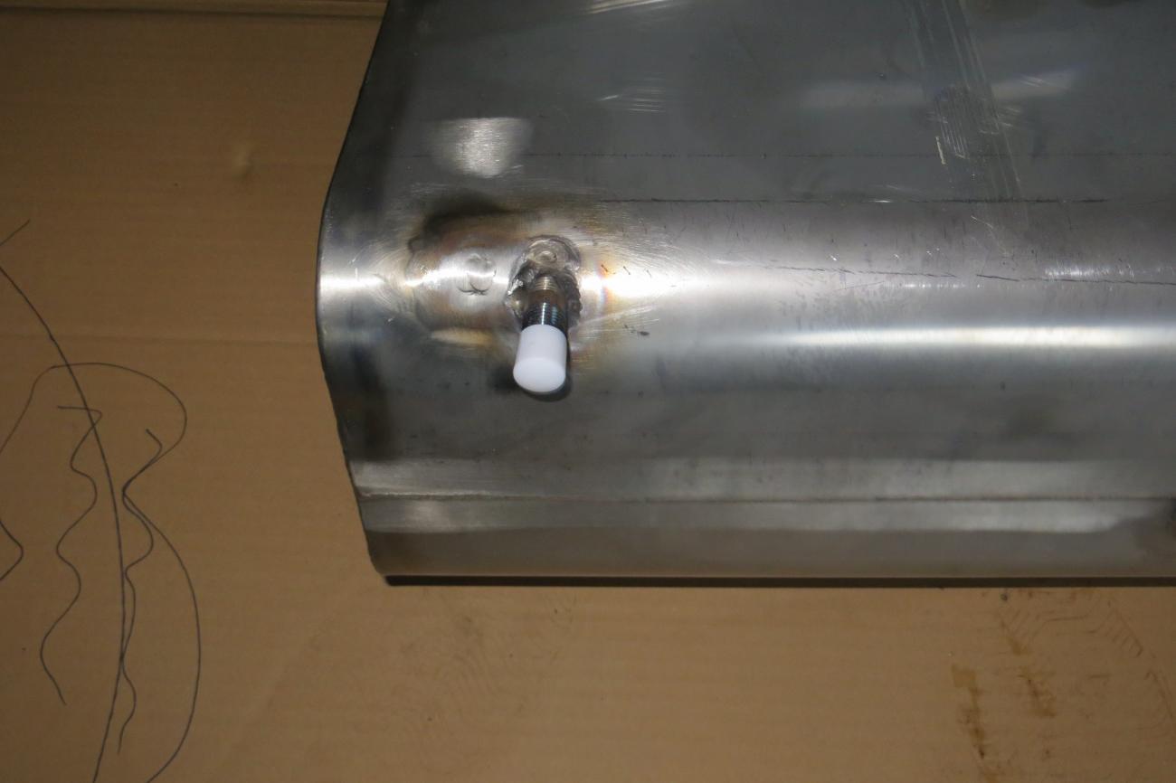

Took some time to get the stainless tank fit with an extra bung and threaded vent tube. So if I ever change to fuel injection it's a simple pug and play option. The threaded end is so I can run AN fittings on my future vent set up.
Setting everything back up so I can get a rolling chassis
for some outside work that I'm not set up for. Plus it get it out of my garage and into my shop when it returns.

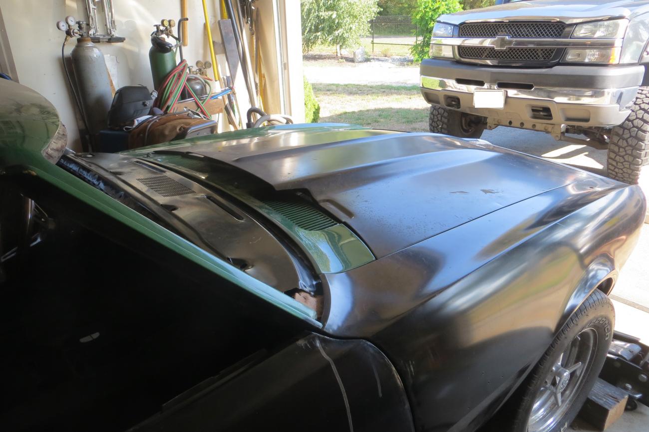

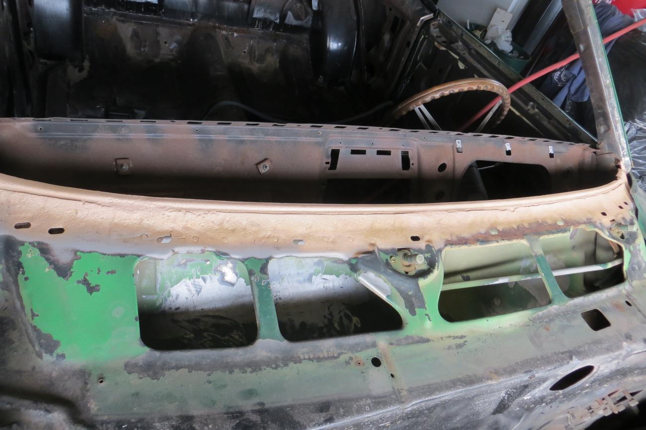

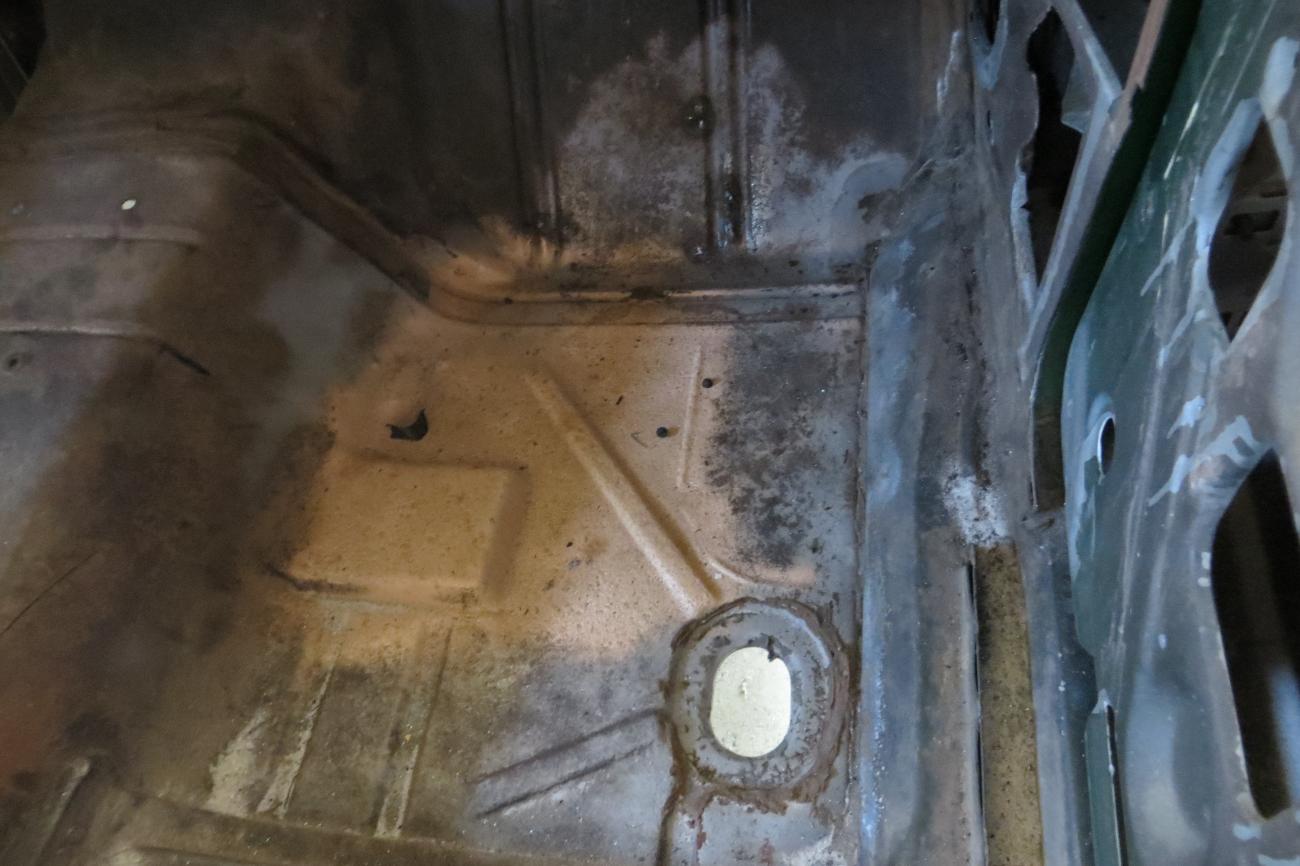

Arc spray work.
Name:  zzzz3 003 (2).jpg
The work goes on.
