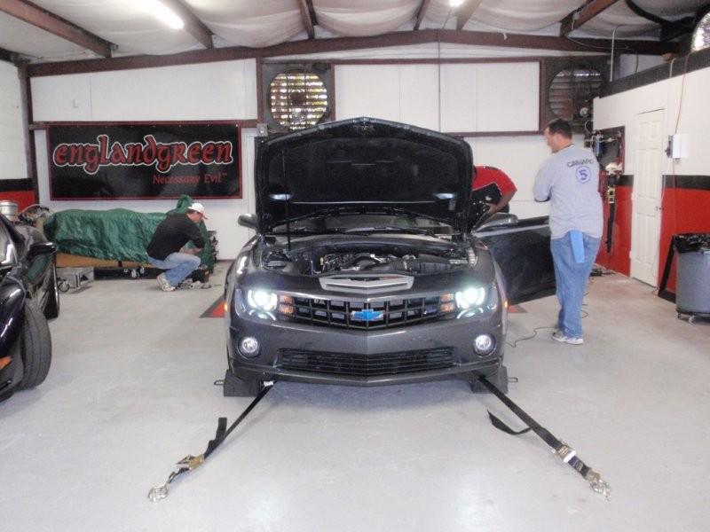

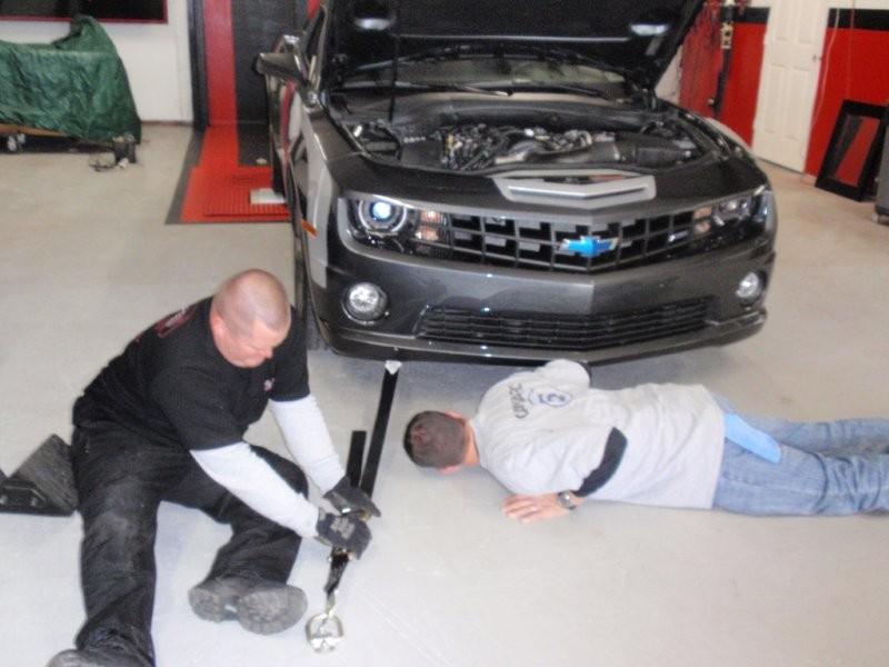

Here are the pics I took... Robert is the young mans name who is strapping down the car...
