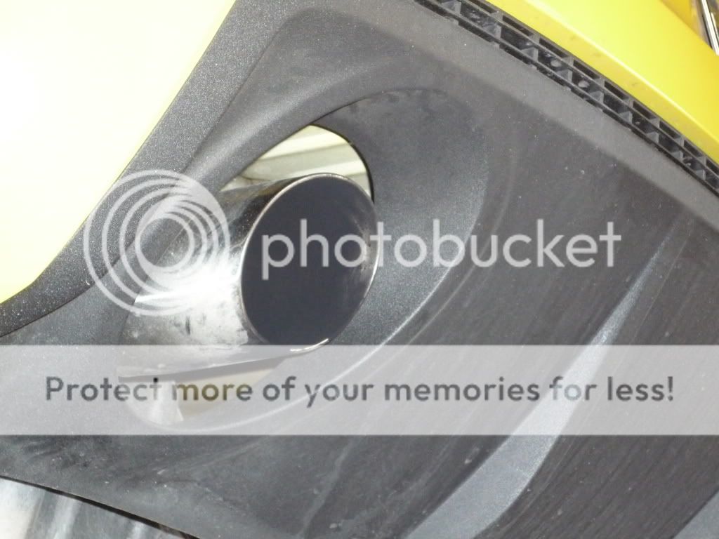

Pictures and Video of V6 Manual Cat Back Exhaust Kit

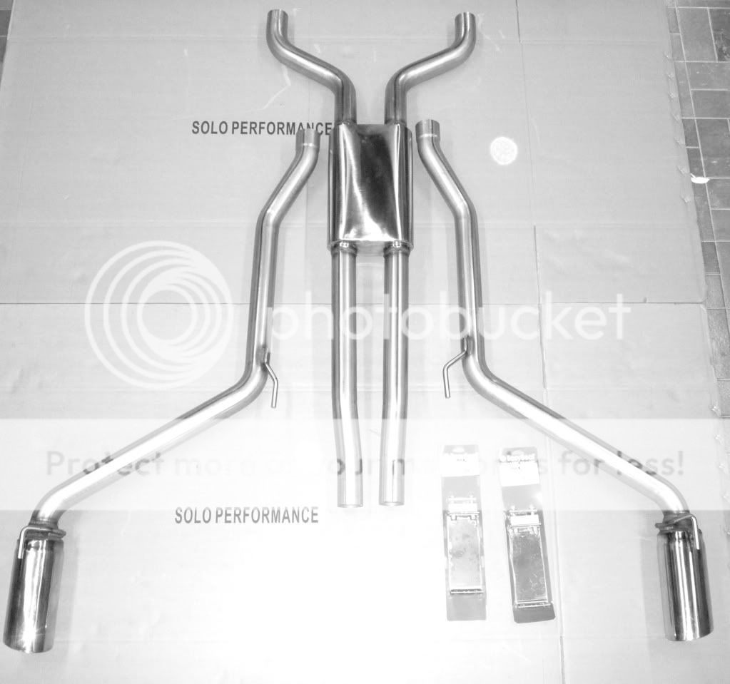

This kit is very similar to the V8 Automatic. The difference is that to eliminate drone and get it to sound good at rev, we had to use 2 1/4" pipe behind the muffler. GM does this too. 2 1/2" is what we tried and it fluttered and sounded terrible. 2 1/4" for the rear section is definitely the ticket on the V6's.
Tips from GM Stock Exhaust

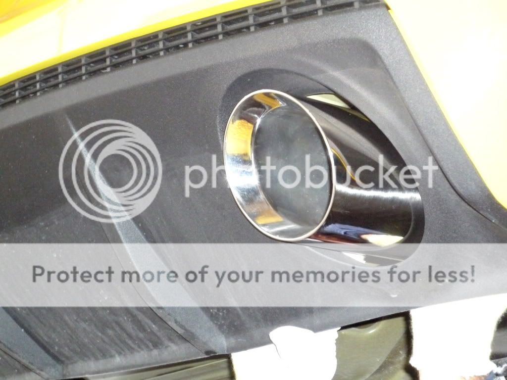

Our 4.5" Tips on the V6 Kit

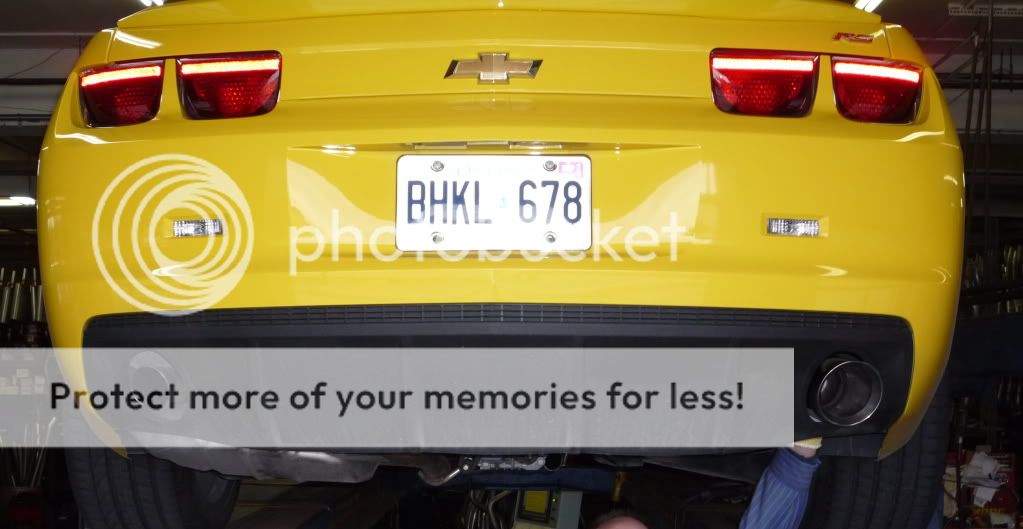

Comparison of OEM vs. Solo Performance Tips
Final Kit Will Look Almost Identical To This
