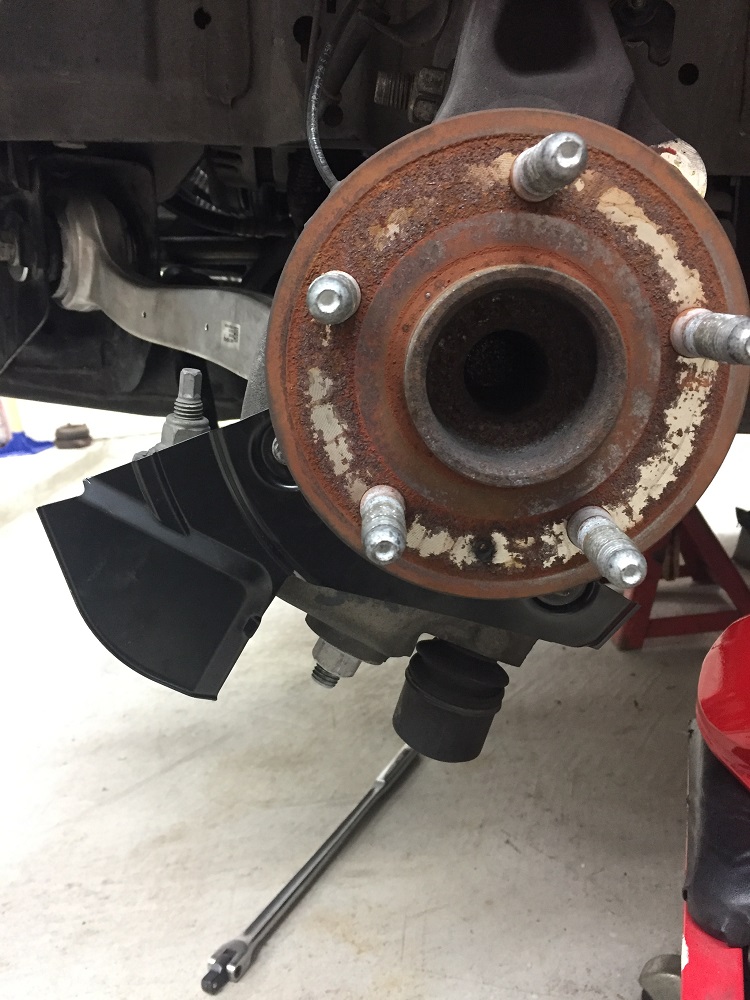

My OCD was not comfortable with zip ties holding the deflectors in place, so I decided to try to use the 6th gen arms. They are aluminum, much lighter and about an inch shorter (will increase caster)...........both good things. They did need to be modified slightly in order to fit. The piviot bolt hole was smaller than the 5th gen bolt and the bushing was narrower. A 9/16 bit and drill press opened up the hole, I used 3 steps to get the hole opened up to keep it straight, using bits I had (12.5mm --> 13mm --> 9/16). Then made spacers for each side of the bushing, I kept them the same OD as the aluminum center section.
Since the 6th gen arms are shorter, I made plates to lock the pivot bolt in place.
The 6th gen SS cars come with front brake duct deflectors installed, some if not all come with a "track" deflector kit in the trunk.
Part numbers for the 6th gen radius arms: FE4 (SS 1LE): 84051641 (L), 84051642 (R)
I went ahead and got new ball joint lock nuts too (11516382)
Street deflector numbers: 23383583 & 23383584
"track deflector kit": 84145204
Deflector mounting bolts: 11589012

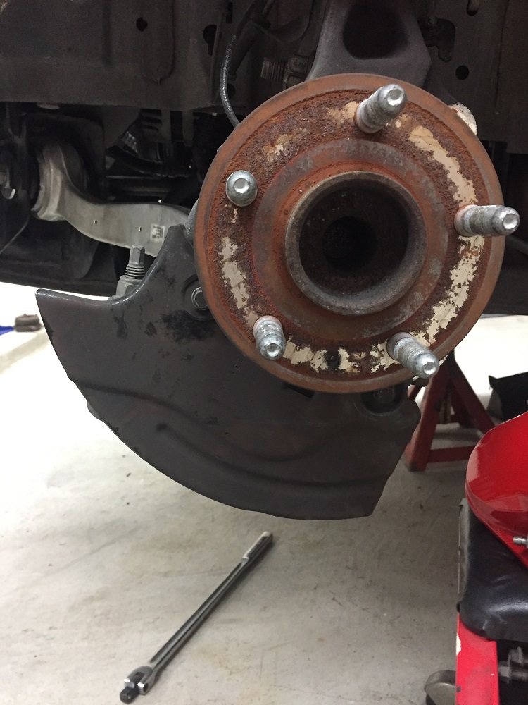

6th gen track backing plates
The track deflector kit includes smaller backing plates. I don't plan to change them on track days, so the new ones are on! Probably not necessary since the 1LE backing plates are small compared to both 5th & 6th gen SS backing plates.
The mounting holes needed to be just slightly opened up with a rat tail file, apparently the mounting on the 6th gen is slightly narrower.

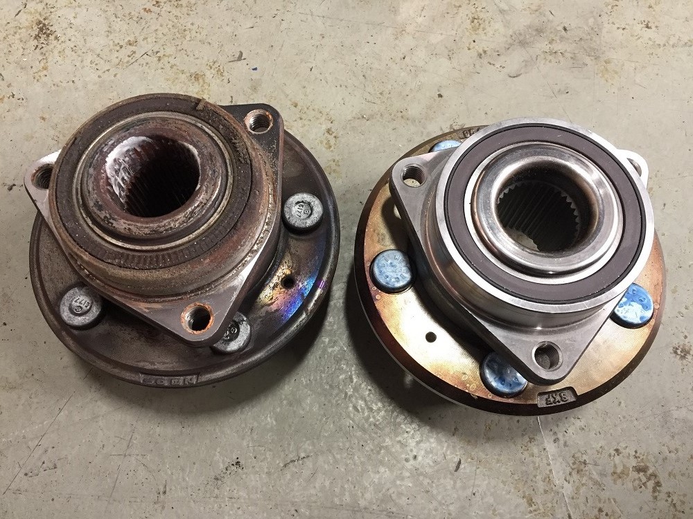

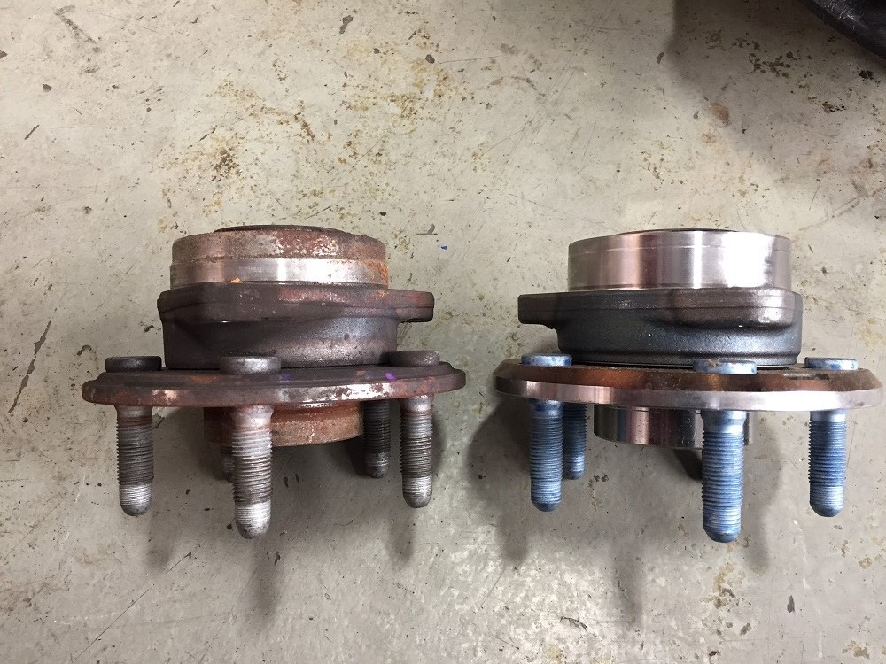

I took the car out for a spirited run with some friends and blew the outer passenger side CV joint on my new (had them for quite a while) axle. Worked with my parts guy to get a replacement. It turns out that the 1LE axles are on galactic backorder......... So, I went ahead and upgraded to Z28 axles because they are available. While there I went ahead and upgraded to the Z28 hubs (25954415 / ACDelco RW20-119). Thx to AG1LE for the tip to search eBay, I got a fantastic deal, so changed all 4.
Discussion here http://www.camaro5.com/forums/showthread.php?t=518429
There is a noticable difference in the hubs, but nothing obvious with the axles.

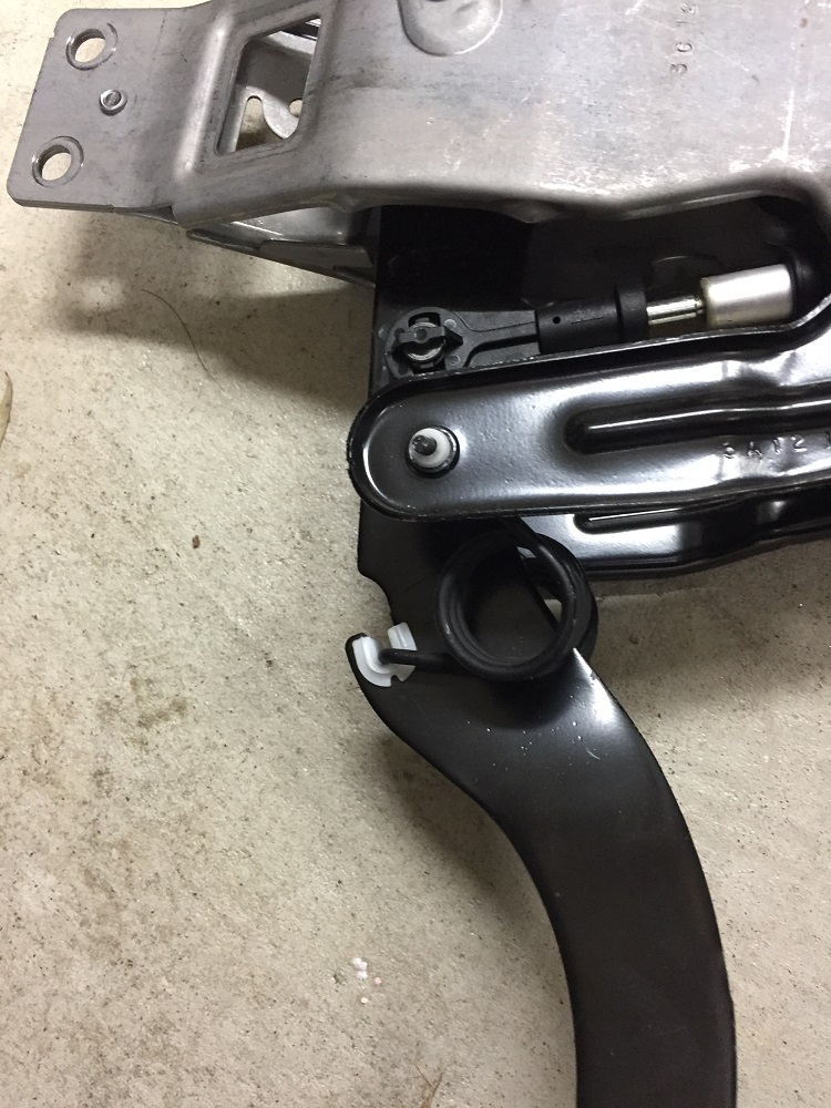

Clutch Pedal
The last several times that the clutch has been bled, the pedal return has been weak/poor. It took many pump cycles to get the pedal back. This started before the trans/clutch maintenance.
I suspected the master cylinder and made plans to replace it. While there I decided to update the pedal assy to the ZL1 version according to a June 2016 TSB.
One of many discussions here http://www.camaro5.com/forums/showthread.php?t=456908
Thx to Freddy G for a copy of the TSB
There seem to be several differences with the new assy. The over-center return spring is larger and stiffer, a straight tension return spring w/ bracket has been added and the master cylinder attachment is now a different color plastic. I removed the ZL1 pedal cover and put the rubber one back on.
Bled the system and the pedal was firm quickly. The pedal is just slightly stiffer, not obvious. Engagement is in the same place and seemed smoother last night.........this may have been because it was a warm evening and the fluids got to temp quickly.
