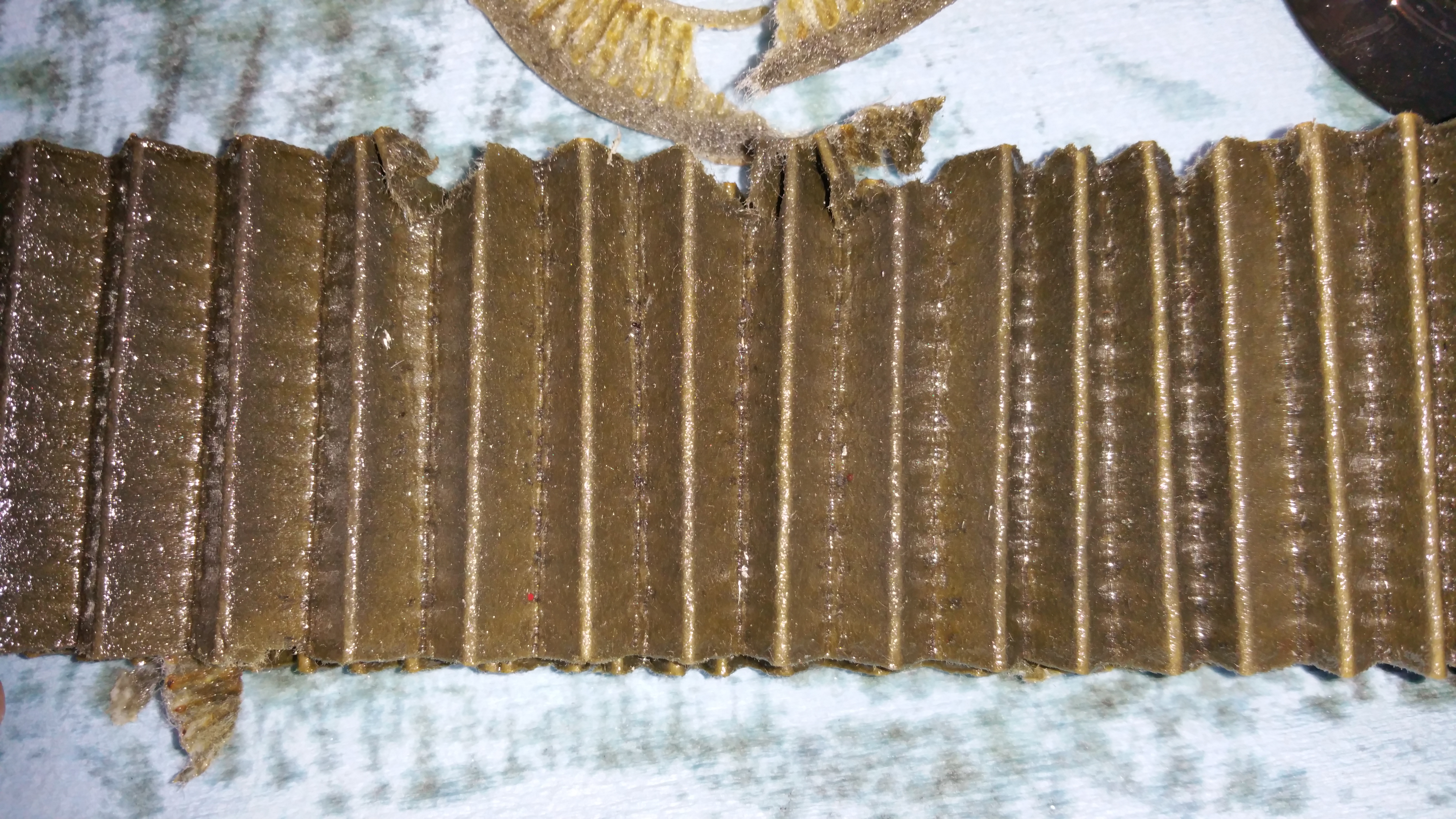

First Oil Change Filter Check HI REZ!

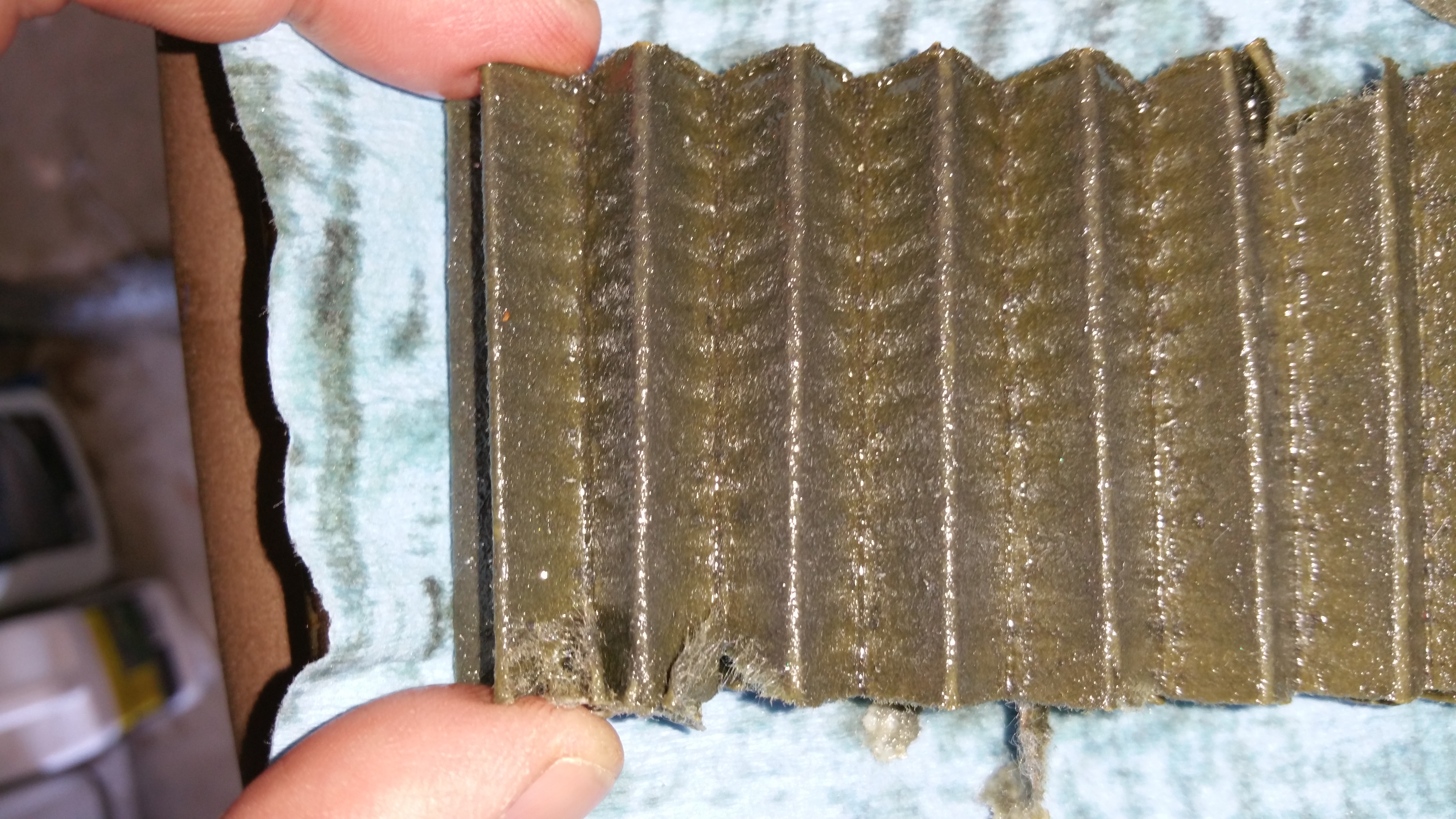

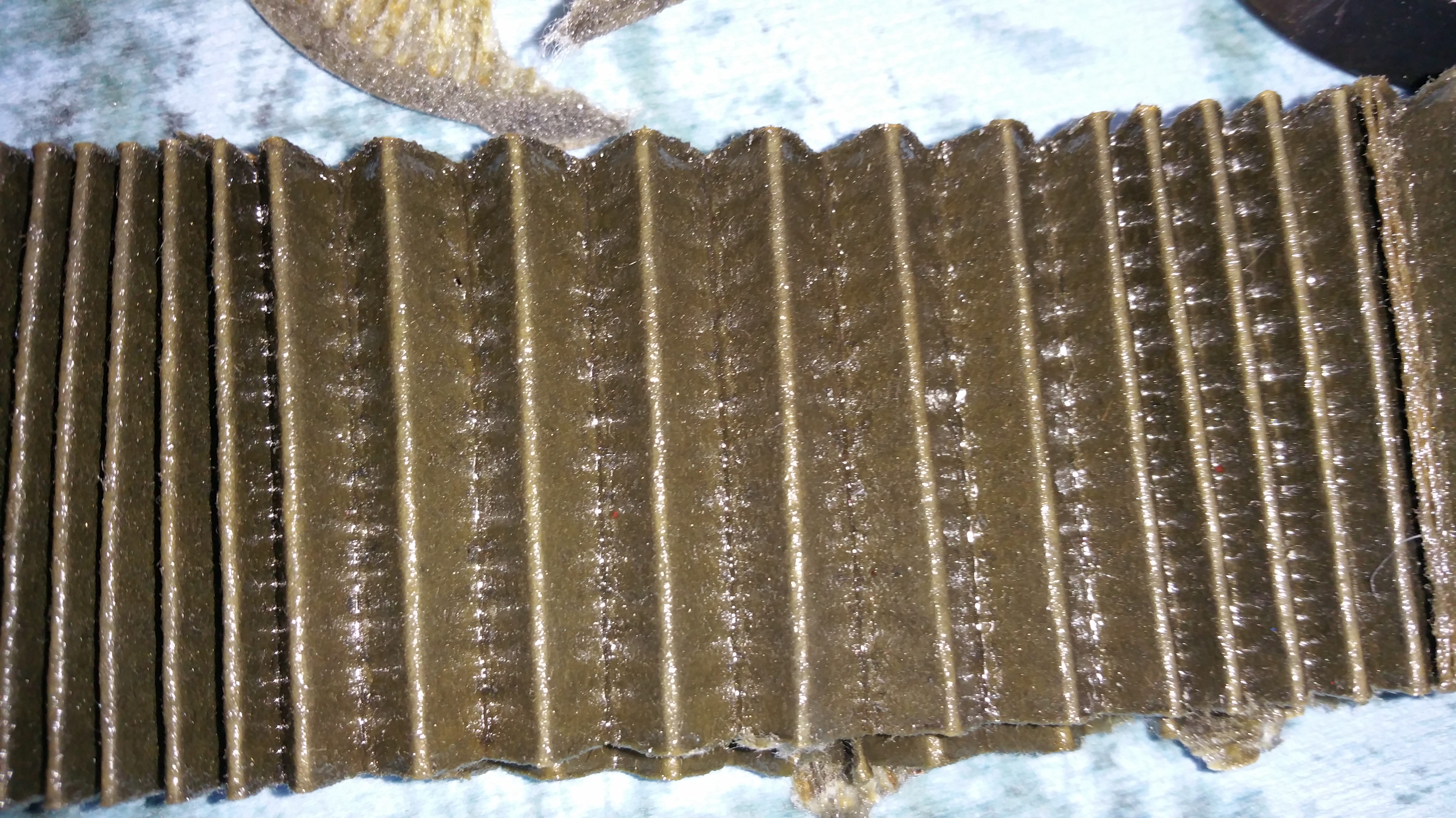

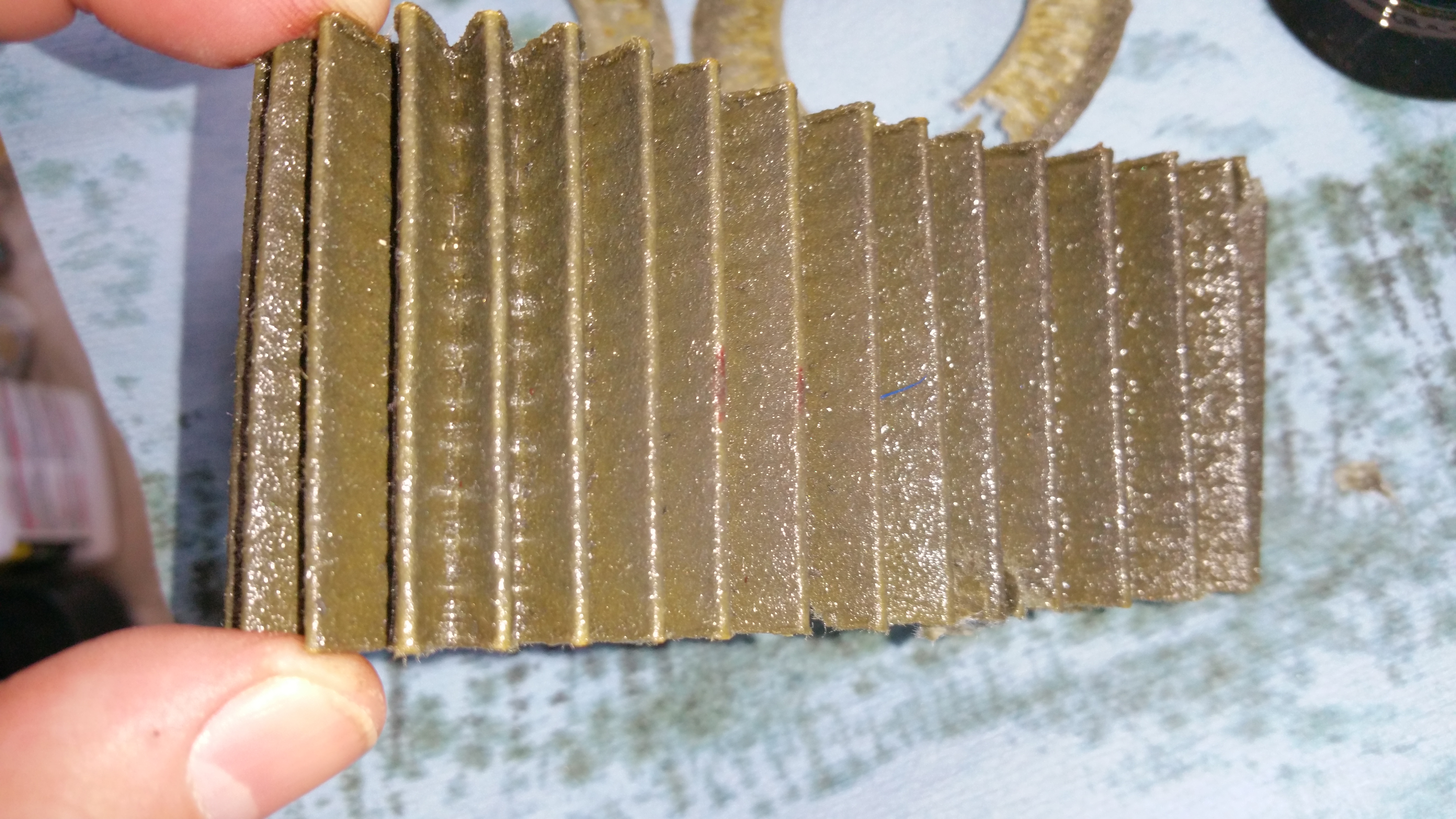

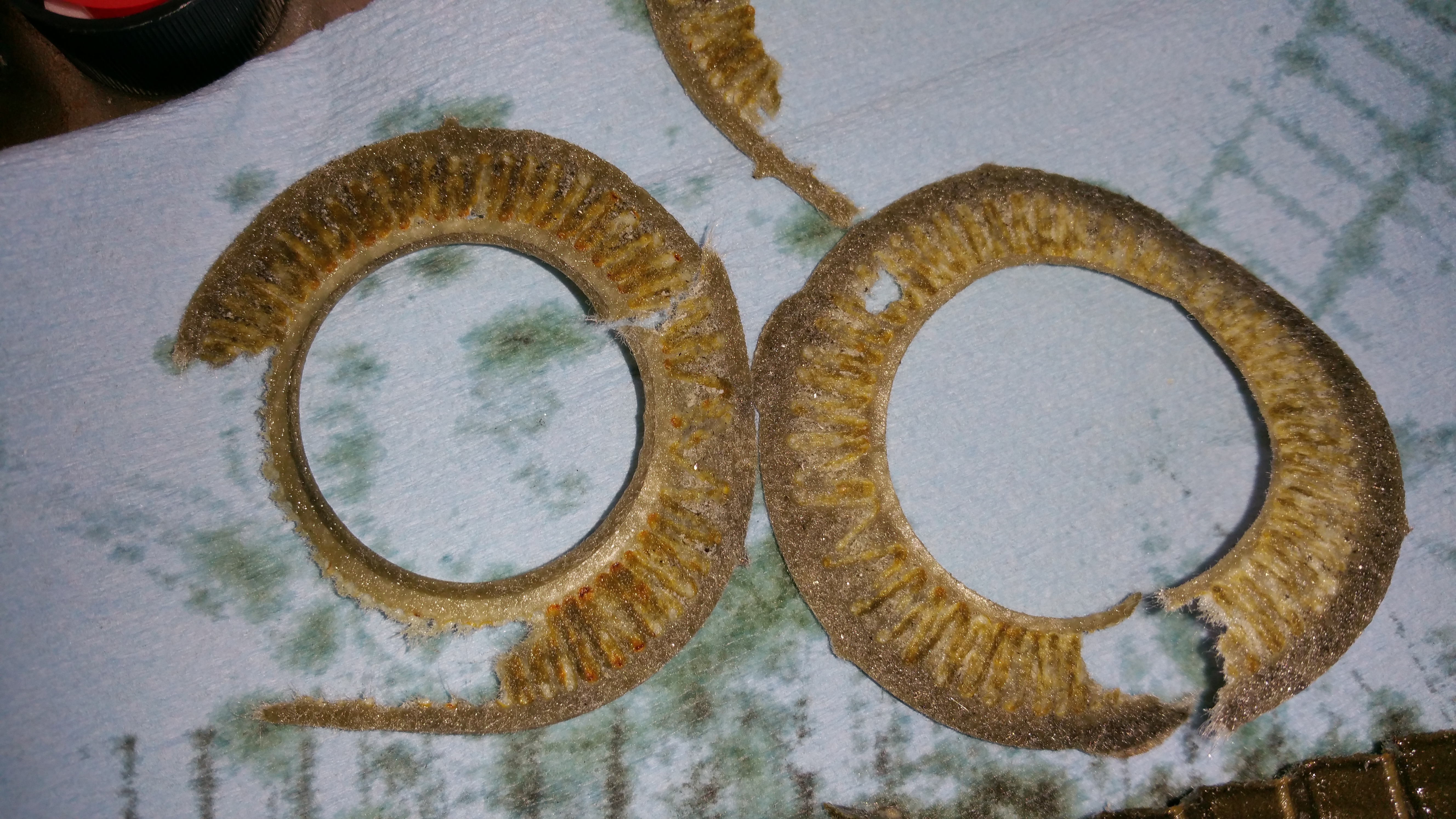

Today, I cut open the PF48E filter after the first oil change -- just validating what I expected -- some metal, etc for an initial setup up. Looked typical and no big parts ;o)
Here is the cutter I used:
Filter element:
When I cut the filter open, you could see the 'silver streak' that comes out after an initial break in of an engine. When I drained the engine oil, I did not have a 'magnetic' plug, but, didn't see any big material. I'll add one the next time -- did order the Blackstone kit to test it from here on in.

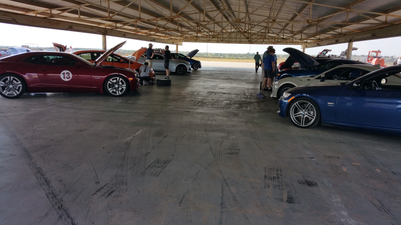

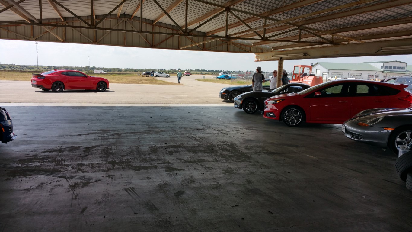

TNiA MotorSport Ranch Cresson Texas
Here are a few pics from tonight's session -- really was fun:
Pavilion where we all parked (early bird wins here ;o):
Just some of the cars that raced today:
New ZL1:
My last session of the day (10 minutes!) as the heat finally got me (over 100° today! Learning a new track and the updates to the car at the same time):
So, everything held up -- except the trans temps got up there -- let it cool down, last session, she did much better on the trans temps. Will need to add more cooler for it (Mishimoto oil cooler REALLY worked well though!).

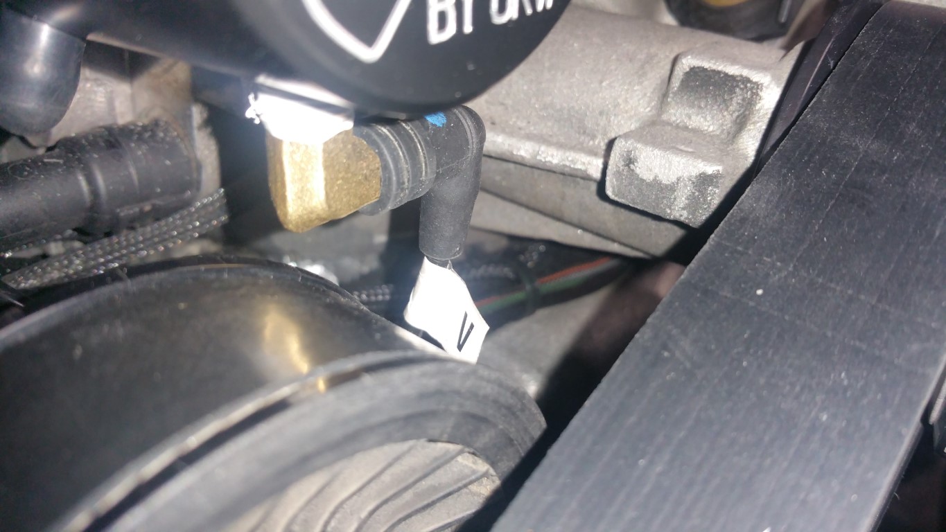

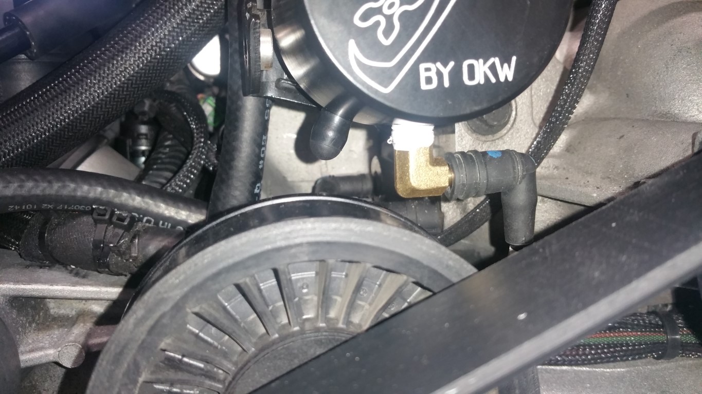

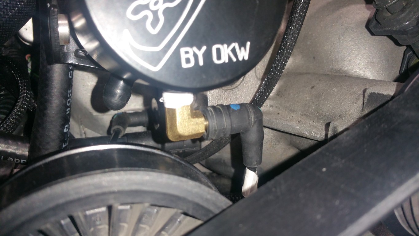

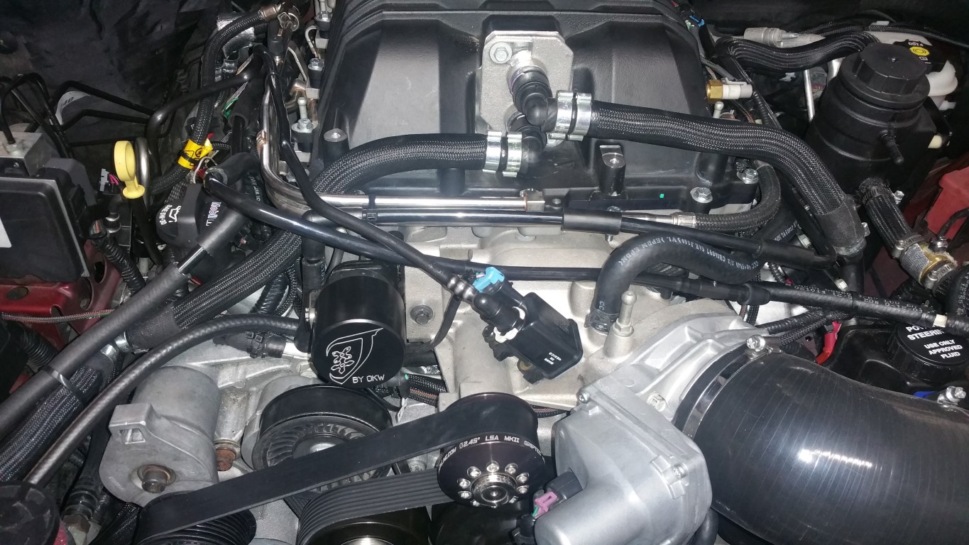

Jokerz Booster Valve Upgrade

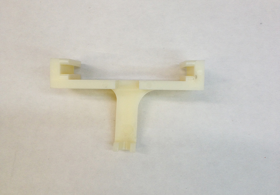

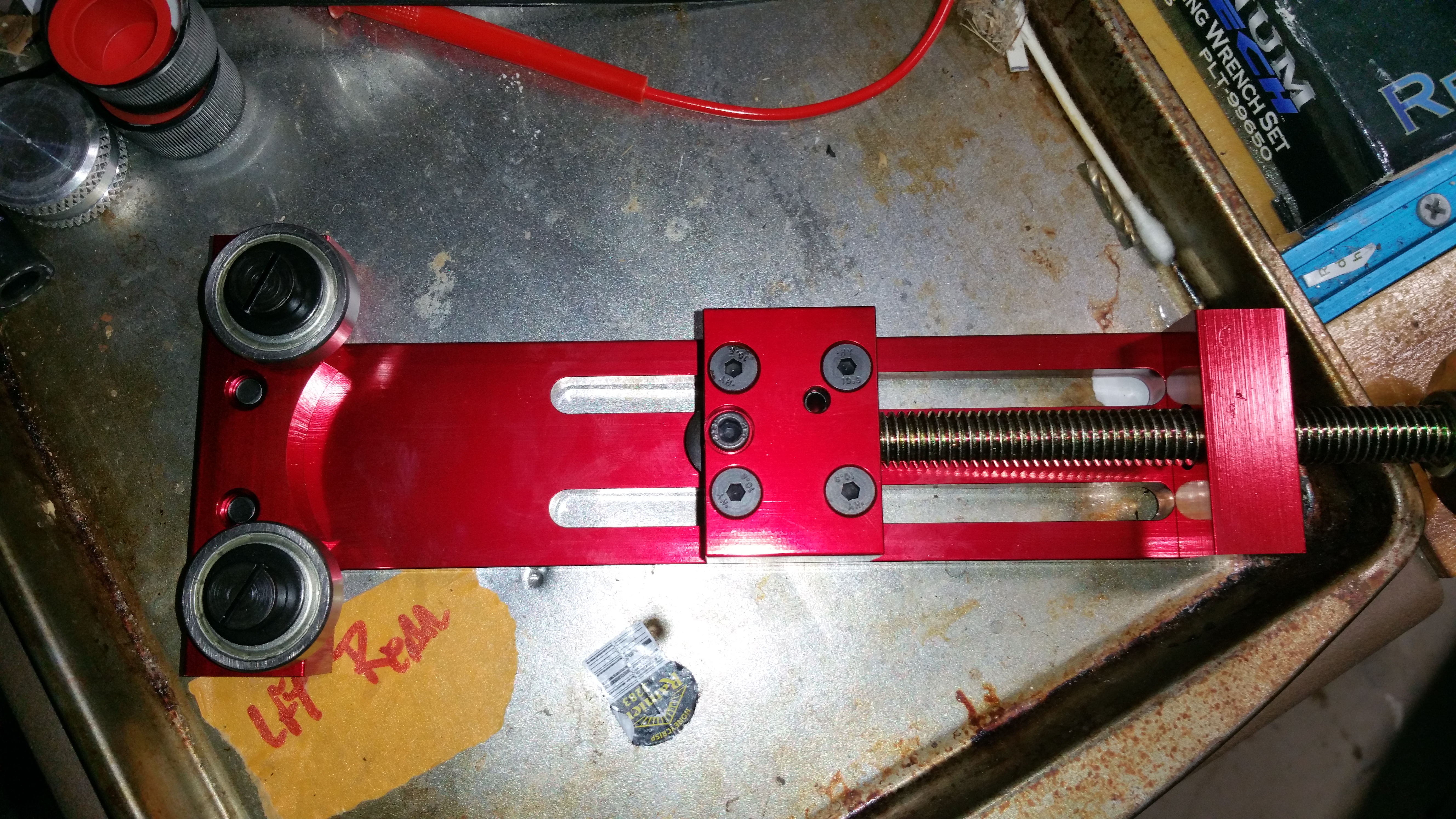

Finally had time to put on the Jokerz Booster Valve -- this really went on with no problem.
Using the alignment tool I purchased from Lingenfelter:
http://www.lingenfelter.com/product/ETN86063.html
I was able to align and set the depth as per service manual. Fit perfect and adjusted the 'step' on the valve to just make contact and 1/4 turn:
Plenty of room and clearance!

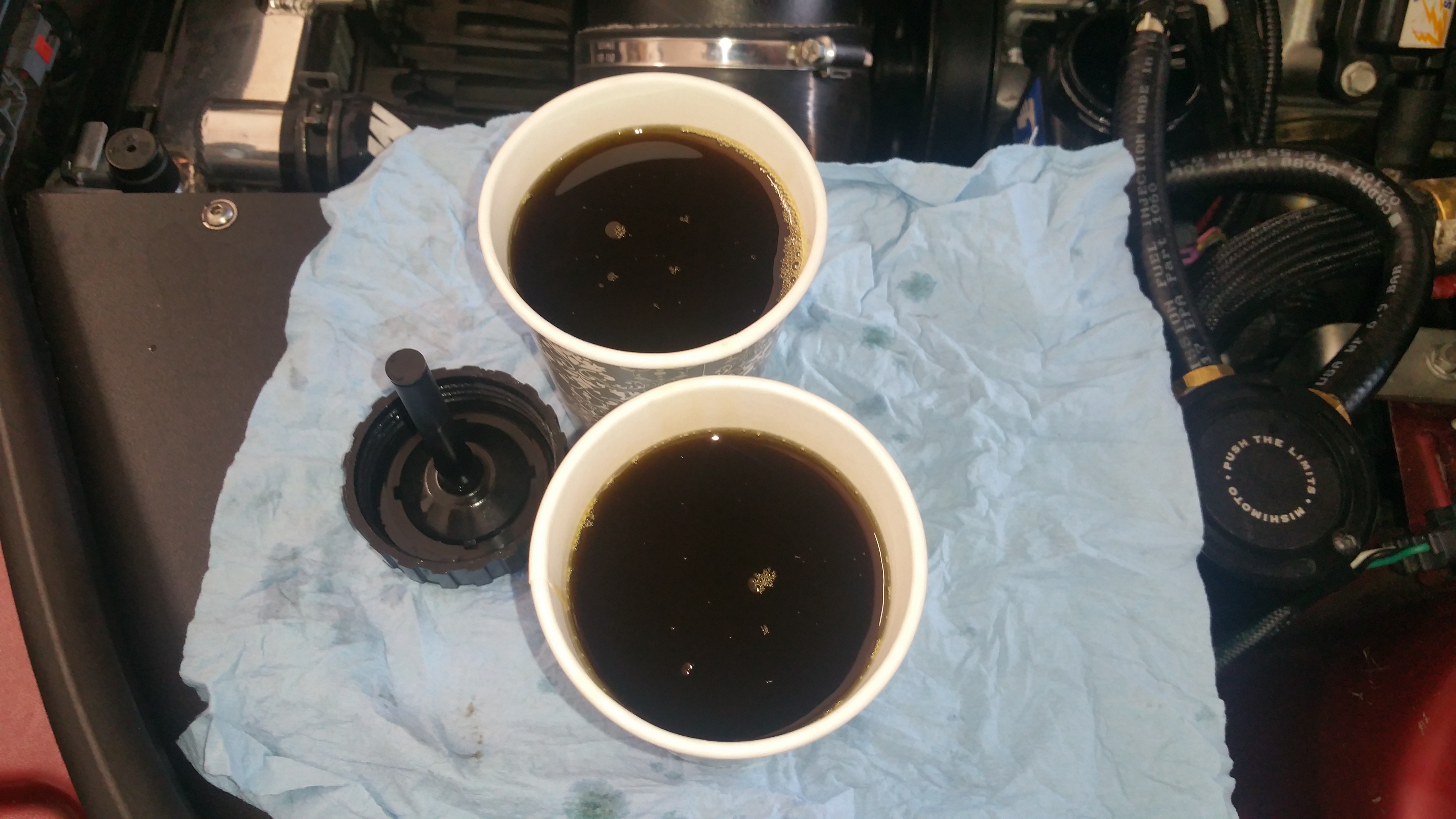

Today, changed out the transmission fluid (10K miles and track days, so it was due) and the power steering fluid.
Trans fluid was fine color wise and no burning smell.
The power steering fluid was in need of change -- after a year:
This is Driven PS fluid -- which is normally clear -- I changed it last year when I did the second PS cooler.
So, looks like every year -- would be a good thing to change out.

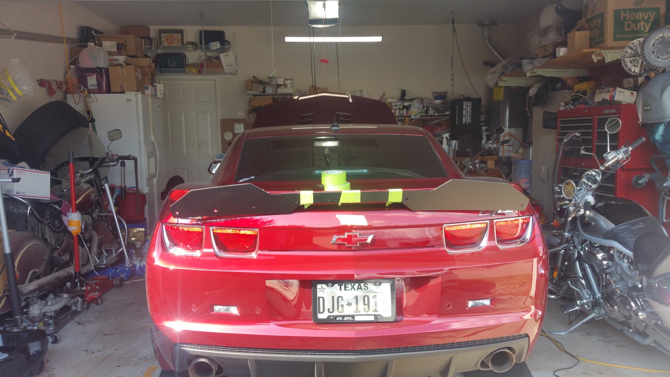

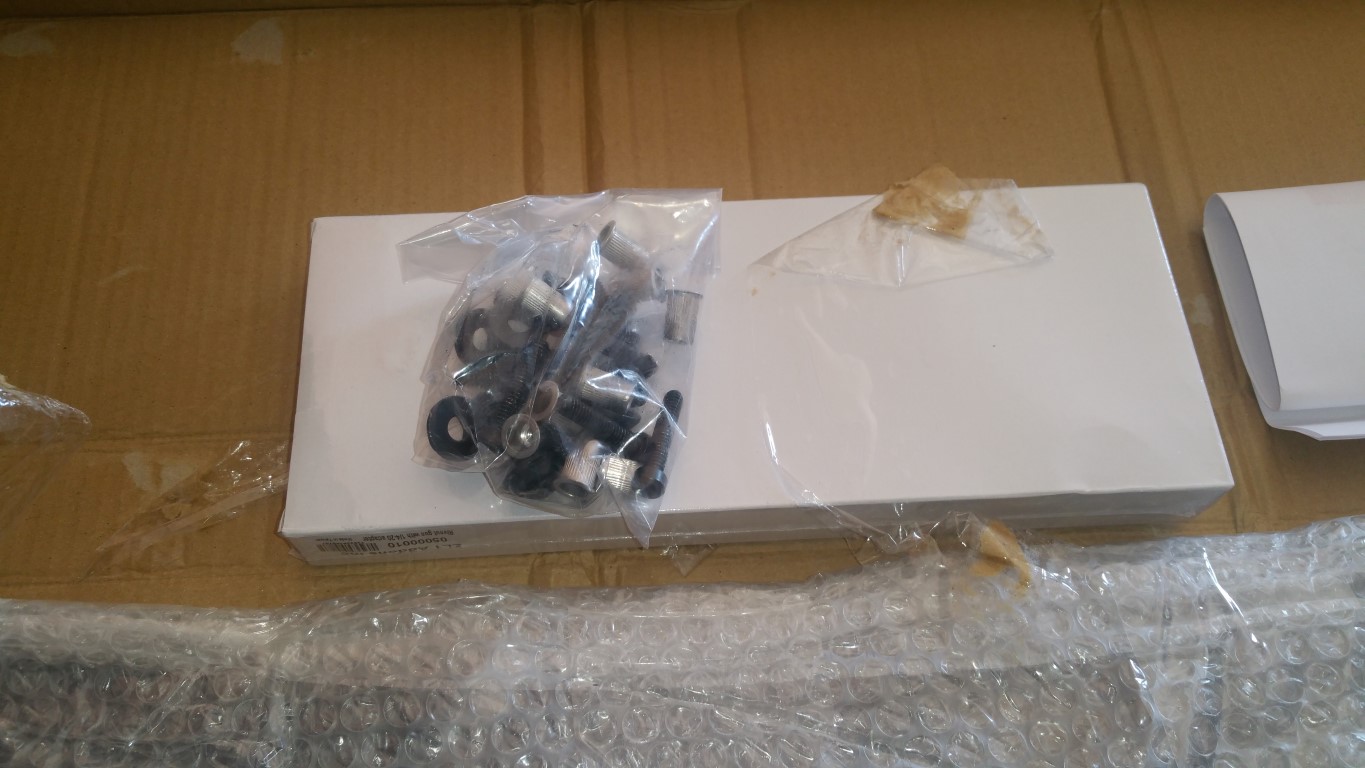

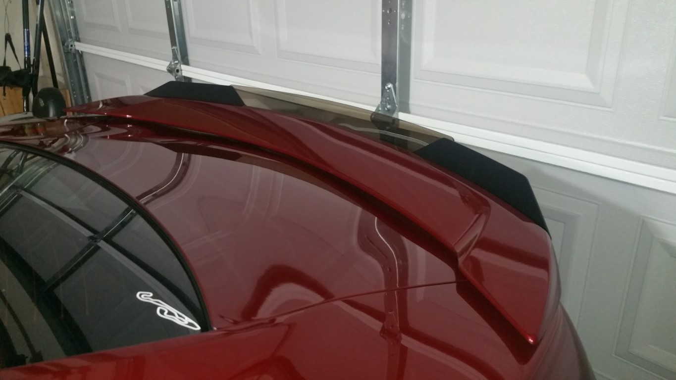

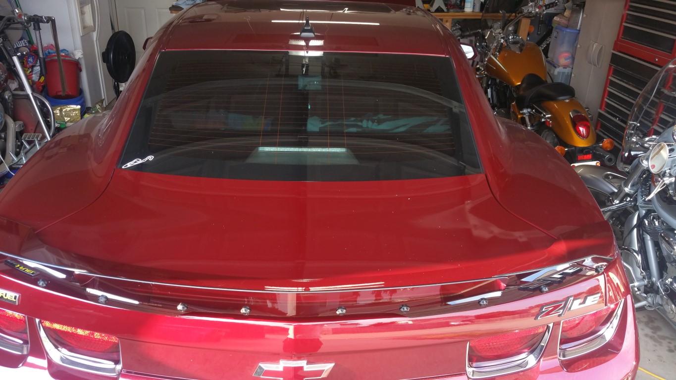

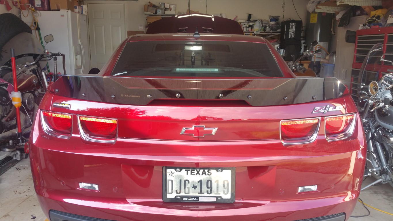

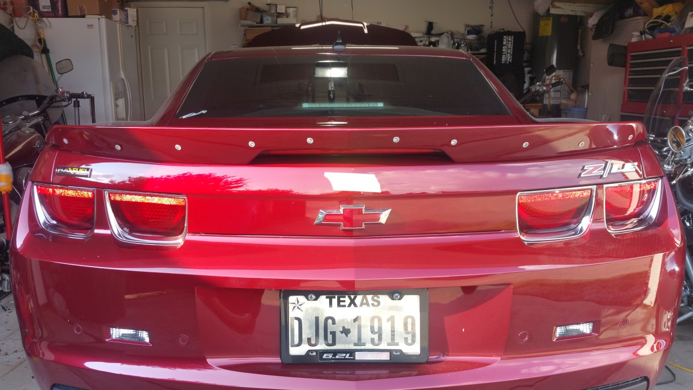

ZL1 Addons Wicker Bill!

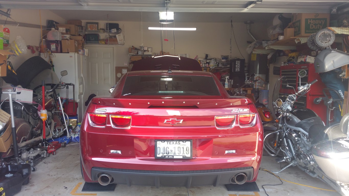

Wicker Bill is on!
If you 'measure twice, cut once' its a very easy job -- I took my time, had it done in under an hour.

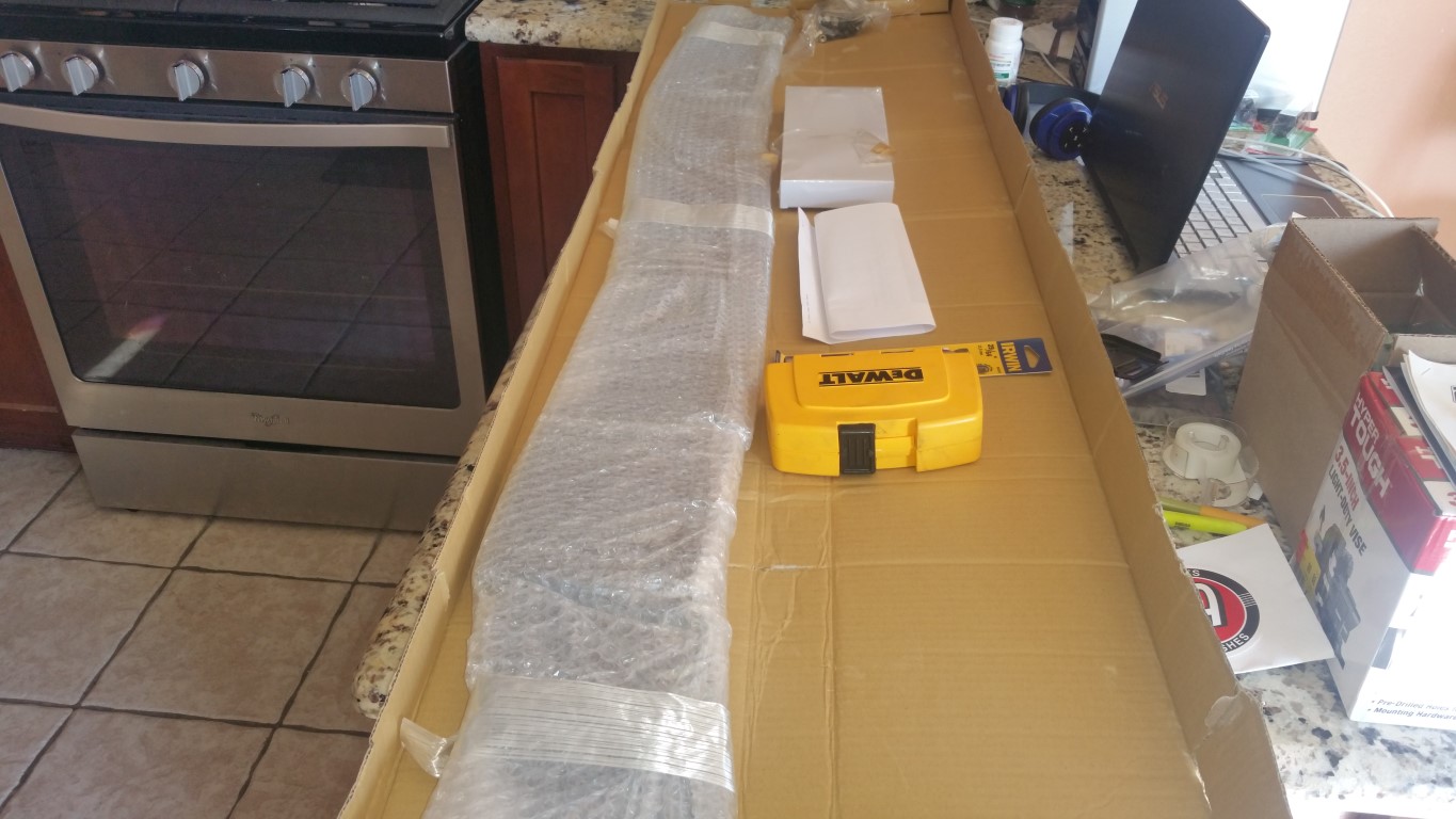

Unboxing:

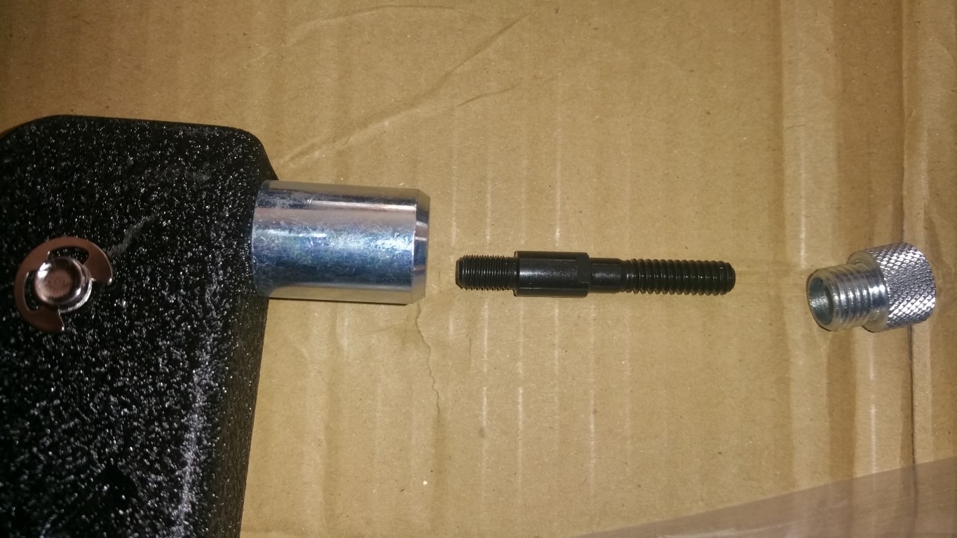

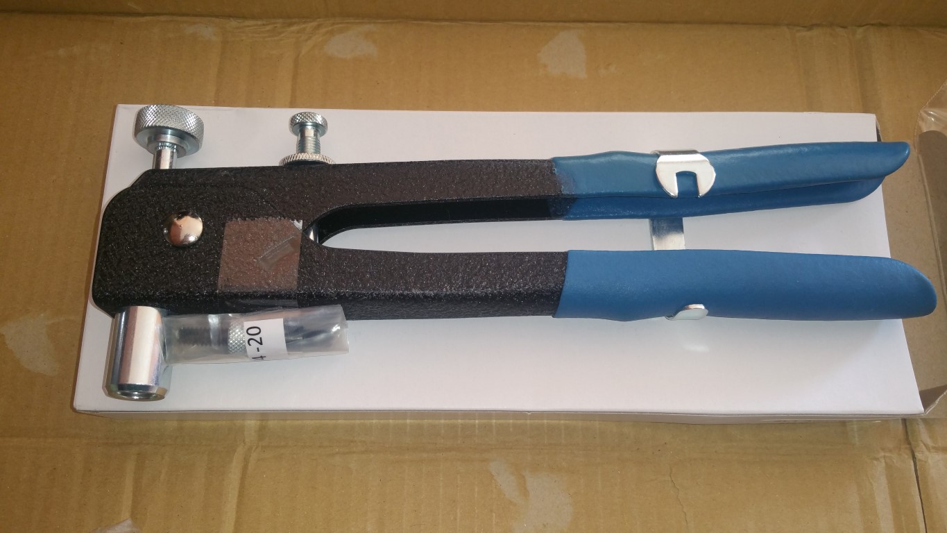

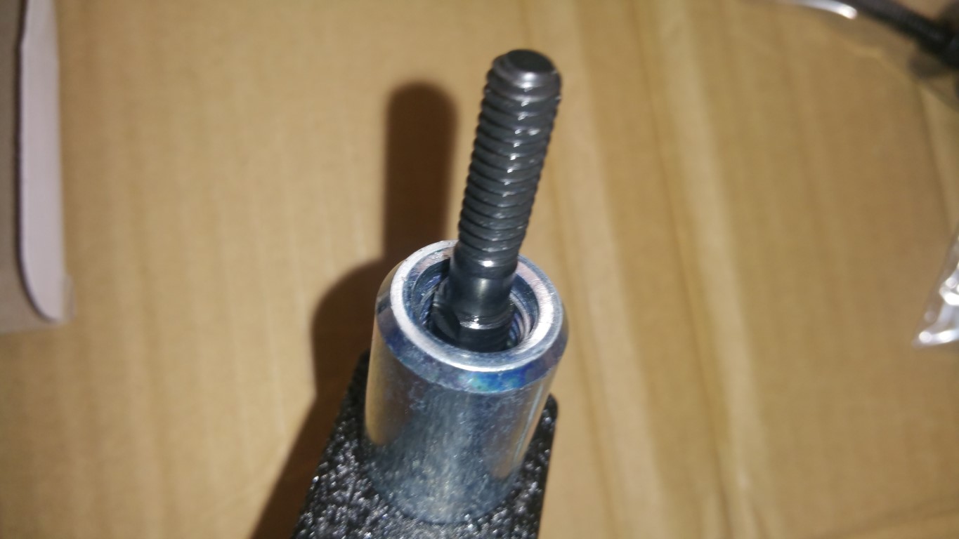

Here is the riv-nut tool and how its setup:

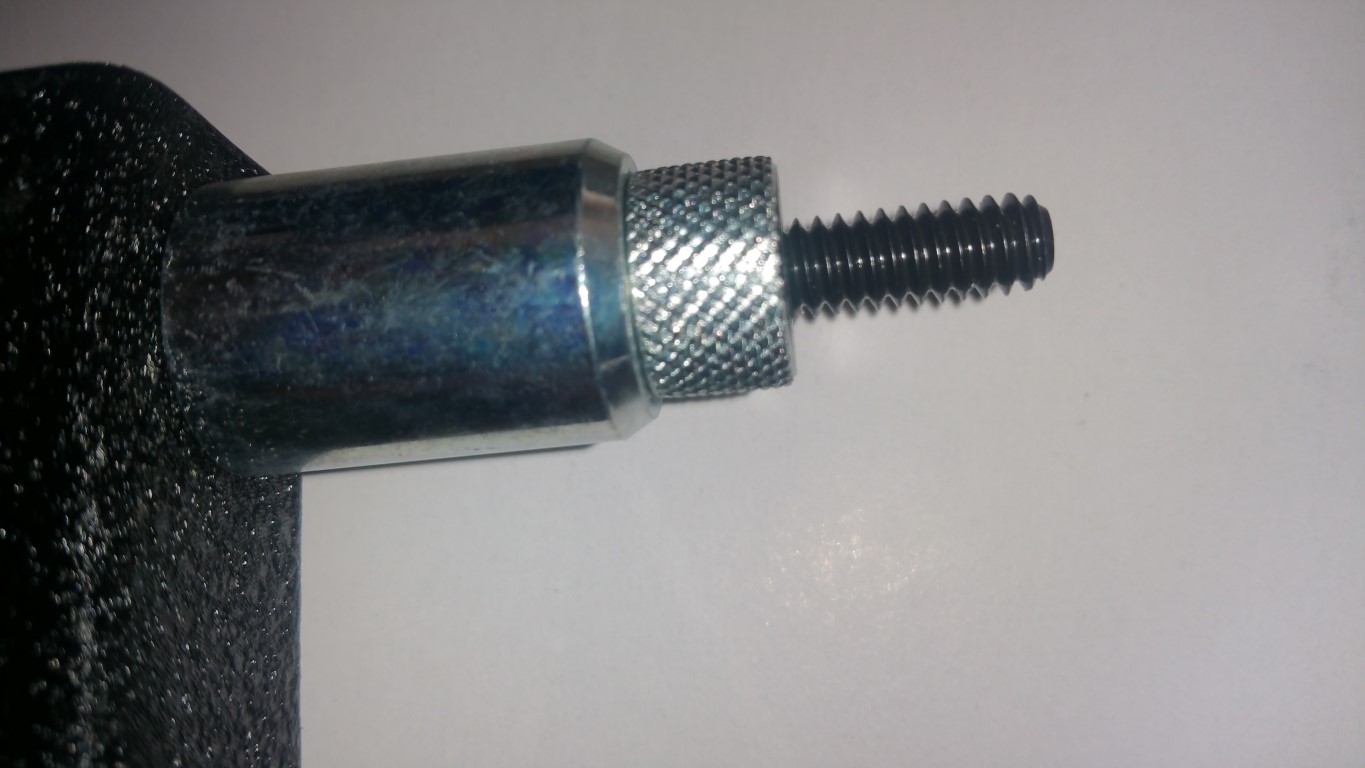

The 'bit' that goes into the riv-nut gun is left hand threaded so keep that in mind:
Riv-Nut on the 'gun':

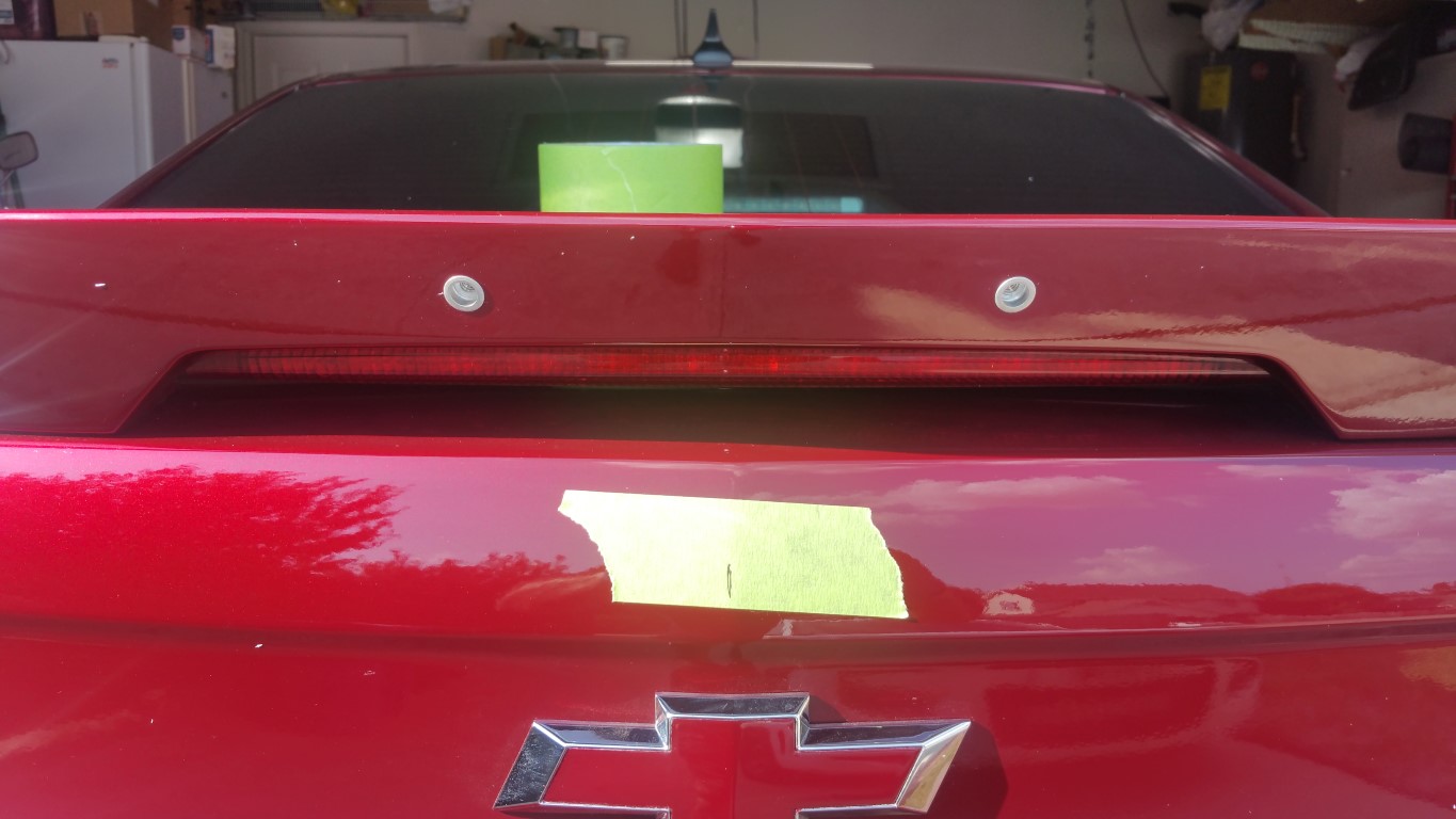

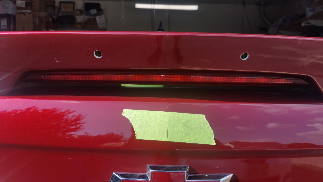

Here, I measured twice then, drilled a 1/8" pilot hole on just the 2 center marks:
Opened them up (25/64 bit or 9MM) then just size them enough to fit the riv-nut:
First two are on!
Now install the wicker bill (just on the 2 riv-nuts) and then mark and then drill the 'Pilot' holes first. Remove the wicker bill, then drill out the rest of the holes to size. Once that is done, work from inside to outside installing the riv-nuts -- this tool makes it very easy to install them!
Check to make sure none of the riv-nuts move -- if they do, tighten them down just a little bit more using the riv-nut gun -- you'll feel it.
After all of the riv-nuts are installed, remove the protective cover off the lower wicker bill, and install that side facing the rear of the car. You'll install the left 2 outer and right 2 outer bolts/hold-downs - just loosely snug. Then install the 'clear' bill over-lapping the lower wicker bill -- then install the bolts and after that, tighten from inside to out equally (1 right 1 left -- back and forth) to ensure the wicker bill will 'equal out to the ends'. Tight up and you're good to go! Mine took a torx 30 bit to install them.
Follow the directions (it says how 'high' up it should be - about 1/4" above the deck lid).
Here it is in all its glory:
Excellent product!
