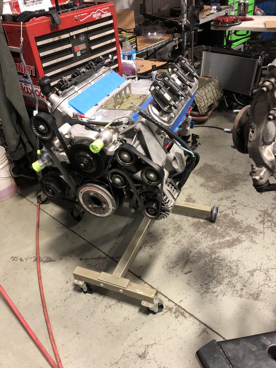

LS7 into an SS
In order to make life easier, and not as costly, I elected to convert the LS7 from dry sump to wet sump. This meant that all of the SS/LS3 accessories and mounts could be retained, no need to get an oil tank/hoses and the radiator/fan assy did not need to be replaced. Basically it becomes a simple LS replacement.
The front snout on the crank is longer on a dry sump engine, but you can run a long snout crank on a wet sump engine and retain the wet sump accessories with a simple/inexpensive spacer from Skoggin Dickie (SDLS7SPCR). The only requirement is that you need to use a dry sump crank bolt. The LS3 front cover is used along with an LS3 oil pump.

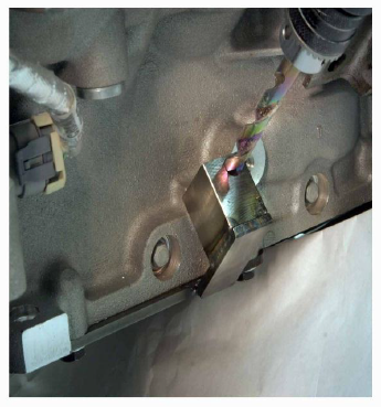

The LS3 oil pan, pick-up and windage tray can all be put on the LS7, again, EASY! There is a "gotcha" though with the swap, the dipstick is in the oil tank of the dry sump LS7 and machined in the side of the block of the wet sump LS3. Luckly I'm not the first person to do this, TechAFX makes a drill guide for the wet sump dipstick. It bolts up to the block with two of the oil pan bolts. The boss is cast into all of the blocks, it is machined out for the wet sumps and left alone on the dry sump blocks.

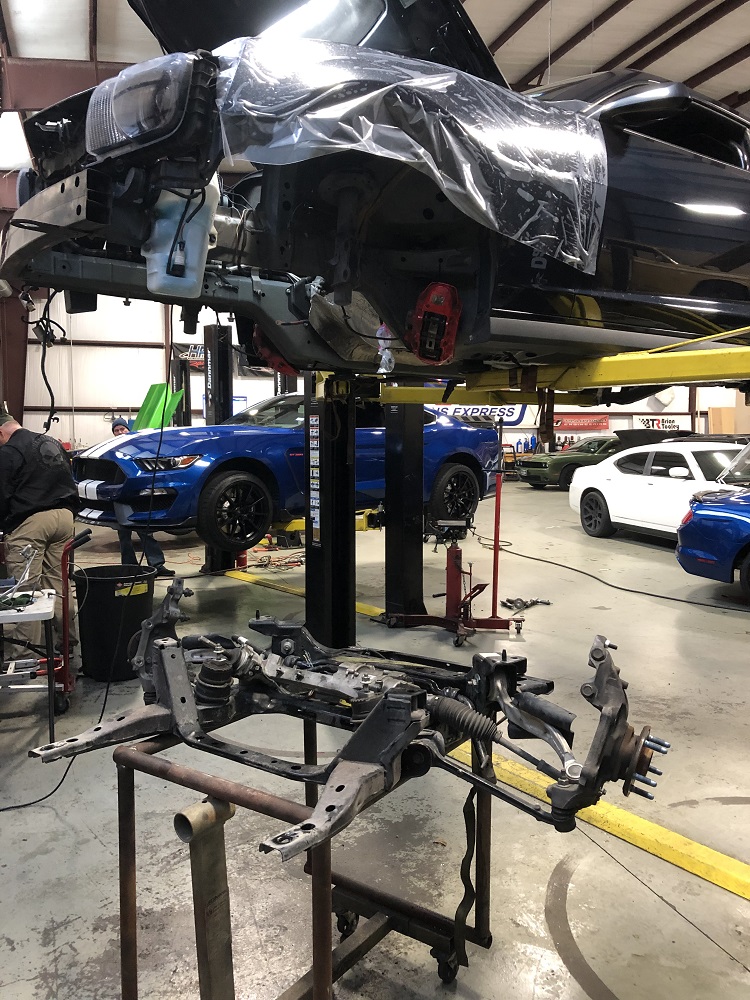

I removed the engine out the bottom, dropping the front sub-frame. This gave me the opportunity to take care of some maintenance/clean up items in the engine compartment. Cleaned up some of the wiring wrap, put in new firewall insulation and do a perminant repair to a short in the main power cable that runs between the jump post and the engine compartment fuse box. It was causing intermittent steering failures, only when in hard left turns at speed.........not the best time for the steering to go out!
Insulator part #s
92195864 Insulator, left, outer, upper
92230866 Insulator, right, outer, lower
Positive Cable, Front 6.2 liter 22925607
This was MUCH easier to replace with the engine out of the cradle

While the engine and cradle were out, I went ahead and modified the rear cross member to be removable. I hope I don't need it, but if I do it will be much easier now
Thx to CFD:
http://www.camaro5.com/forums/showthread.php?t=363173
look at post #10, I believe he still makes the flanges.

The engine can be installed with all of the accessories, headers and harnesses. Basically complete, less time bent over the fenders.
