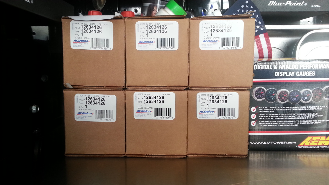

Not taking any chances...

Old 01-07-2015, 01:25 PM   #165
crc91
crc91's Avatar
Drives: '14 1LS
Join Date: Apr 2014
Location: Mandeville
Posts: 2,166
Well that's certainly the way to fix it!

My boost controller finally showed up today! I thought it was lost in the mail. I ordered off Amazon Dec. 20th. It shipped on Dec. 22nd with 2 day shipping and never showed. Was in the process of getting a refund so I could order from somewhere else and low and behold it showed up today. Stupid USPS... Now I have everything I need to finish this project up. Just need to get some time to reinstall all these injectors and intake.

Looking good. Sux hearing about the injector issues... Hope you get that sorted out soon...

Those gauges are beautiful!
