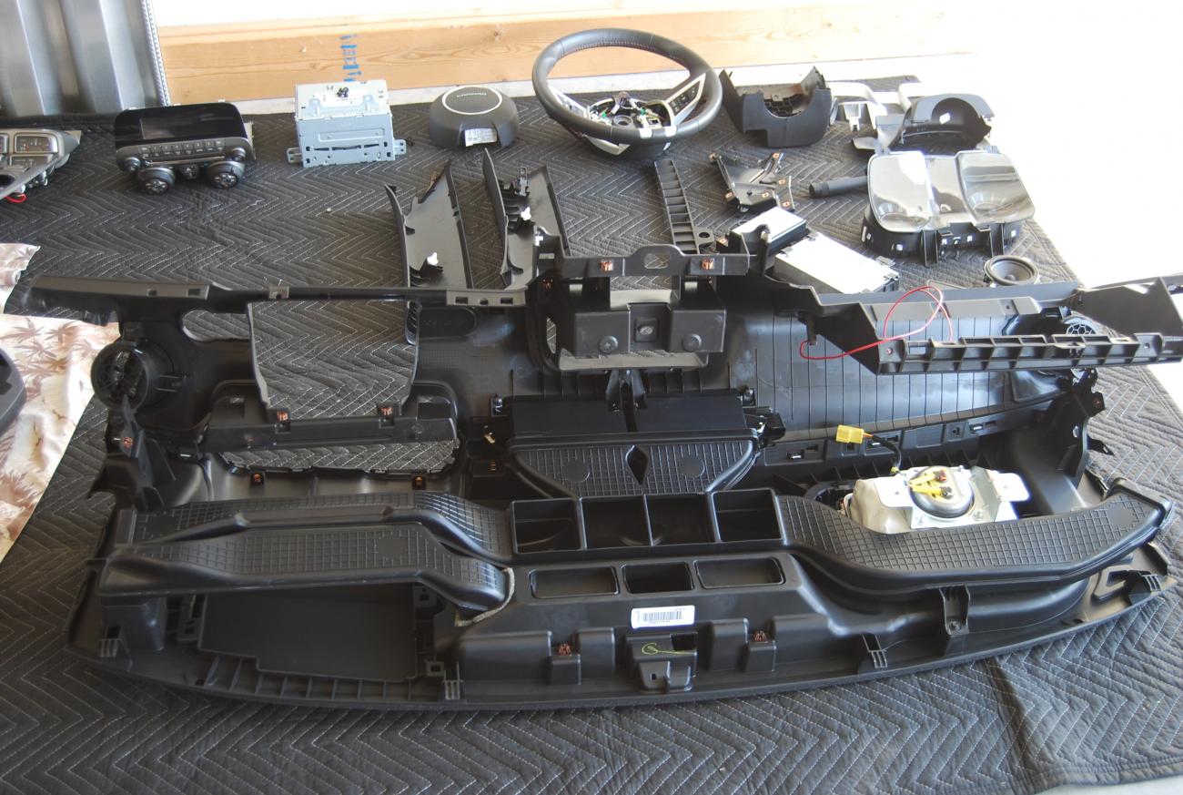

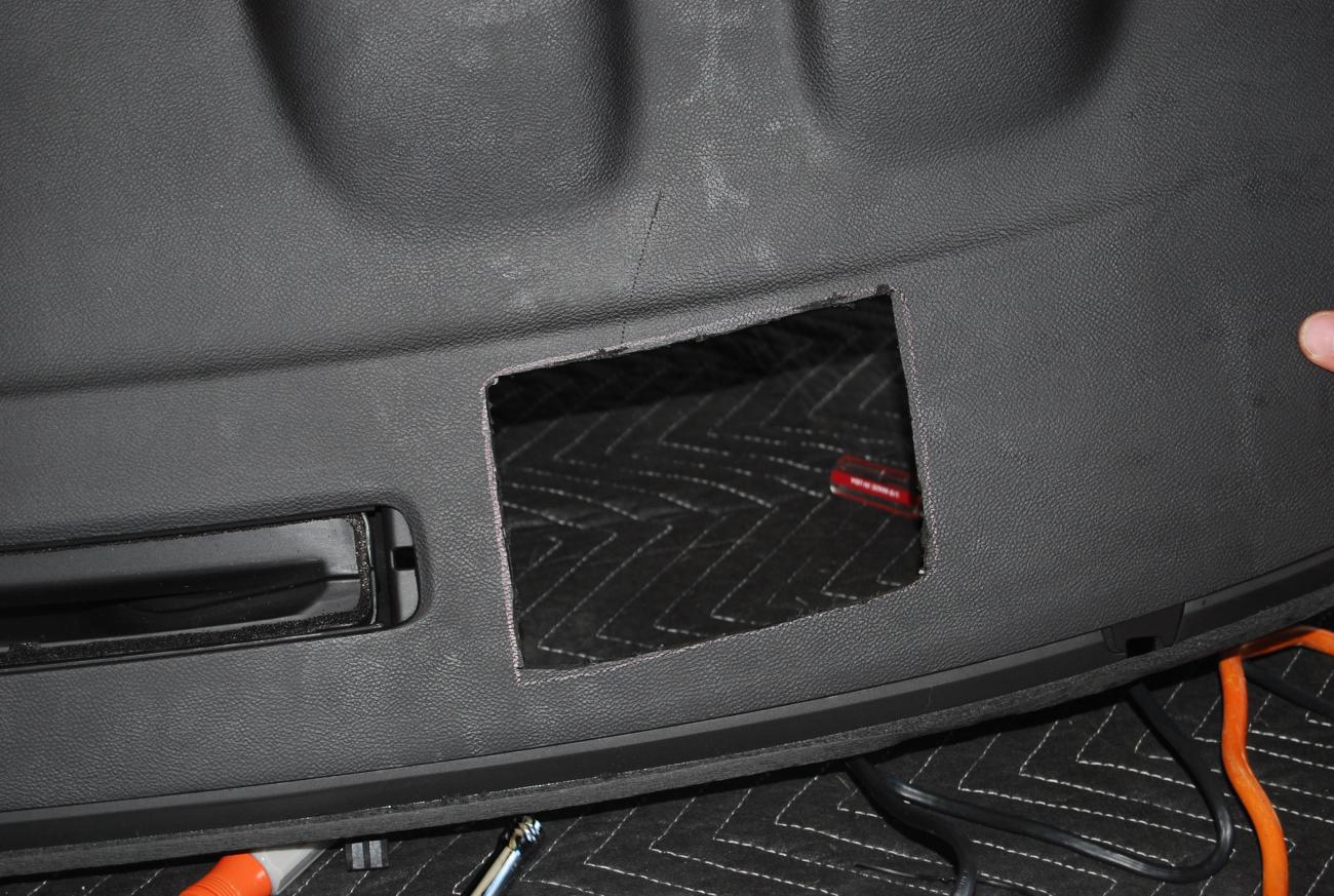

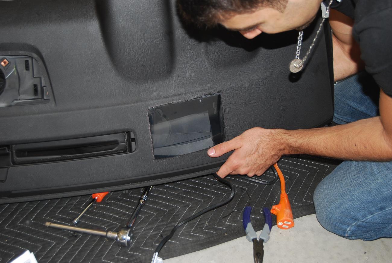

cal's bee neatness counts,,,get a big area set aside for the dash, tools , screws, etc,, lay out some old sheets on floor, so nothing get scratched. possibly you need a person to help you take the dash out and get it back in.. when you cut the opening try to use a dremel tool,,and "trick" turn blade backwards, it will make cutting dash easier. go slow, measure 2-3 times then cut,,, you will see it better if you turn the dash over and temporarily install the HUD so you can see out line of hud installed.. contact ofer for more info if you get stuck...good luck and post picts...
rydahog is offline   Reply With Quote
Old 01-06-2012, 04:41 PM   #1687
rydahog
rydahog's Avatar
Drives: camaro ss
Location: usa
Posts: 2,166
ryd hud
here ya go,,neatness..
