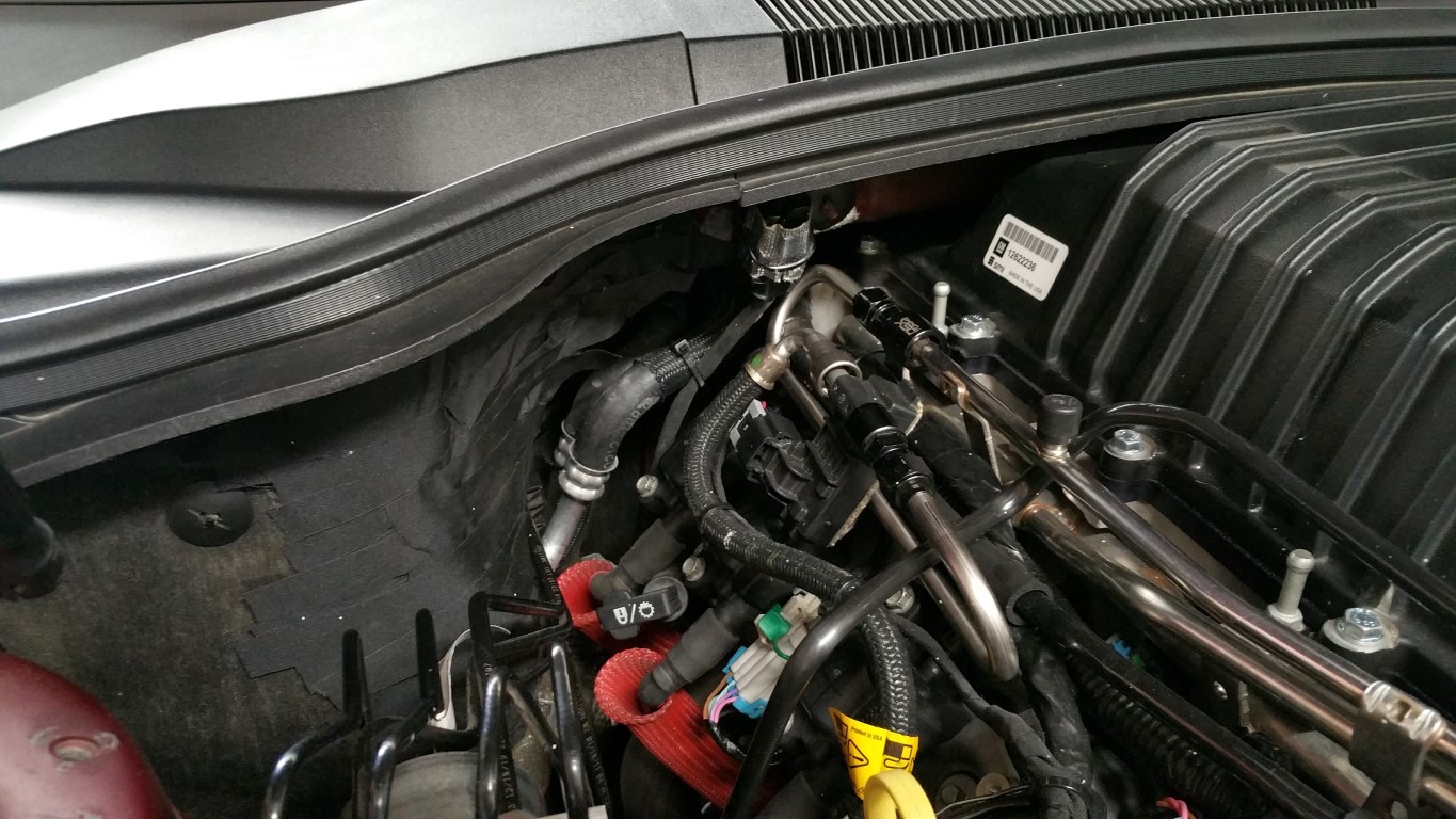

OK! Sensor is in place. Nothing special except had the bung welded as required by AEM. Routed the wiring -- except for the heat tape, very stealth:
In action!:
Just need to trim up the pod as when turning right, the steering wheel 'just' kisses the gauge. Gauge has a 'larger' trim so should be a heat/re-position the pod

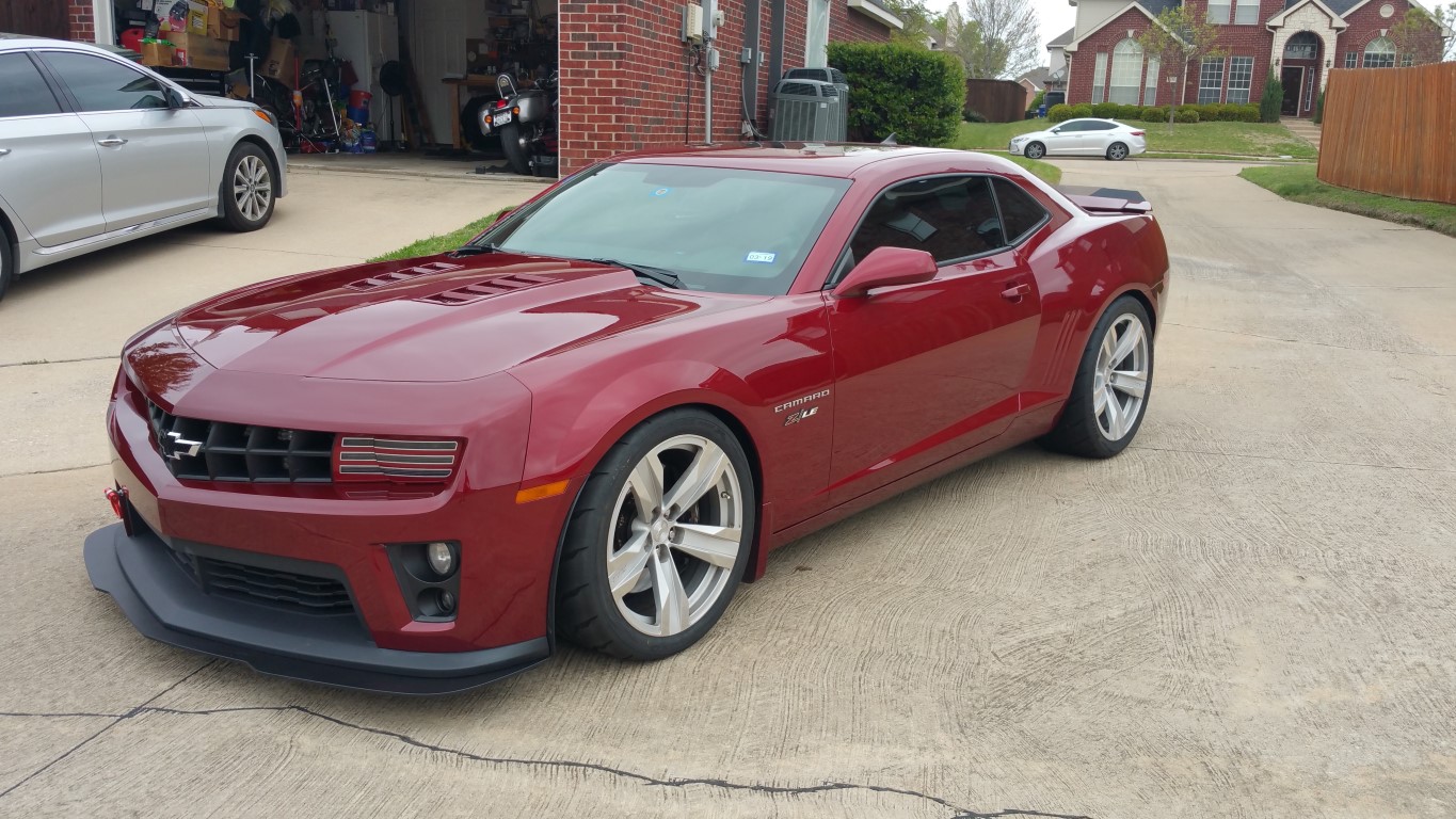

Gave her a bath today, track wheels on, getting prepped for the next Eagles Canyon date!:
I have the JPSS Caster Locks left to do so that will be sometime in the next week. Then alignment!
Took it for a drive -- AEM working great now that I repositioned it with the heat gun. I did notice the lambda is .65 to .59 when going into boost (not even full throttle). Will have to log that over the next week and send it to Ryan to get his assessment.

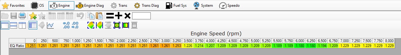

EQ (Alcohol) looks fine in HP Tuners:
Following the 'math', it should be 1 (Lambda) / EQ Ratio so:
@ 2500 RPM I would take
1 / 1.251 = 0.799 and that would be in the range. I have the Bung in the mid-pipe just behind the header @ 30° angle in bank 2 (passengers side) near position 1 -- well within the range.
I'll hookup HP Tuners, add the wideband and see what I get from there.

That table is only for wot.
Your MAF scaling determines how close you are to the commanded.
Edit, just read your post above for the decimal. That's rich, won't hurt tho.
It can be tricky trying to get both normal gas and alcohol commanding what you really want. Sometimes you gotta give or take with one table or another
I hope your new AEM kit ain't a dud.
Me too...
Yep, that is what I was checking for -- WOT -- since I'll be testing that part out and validating
Gotcha on the MAF. I'll make sure the resistor trim calibration is still selected in the gauge...

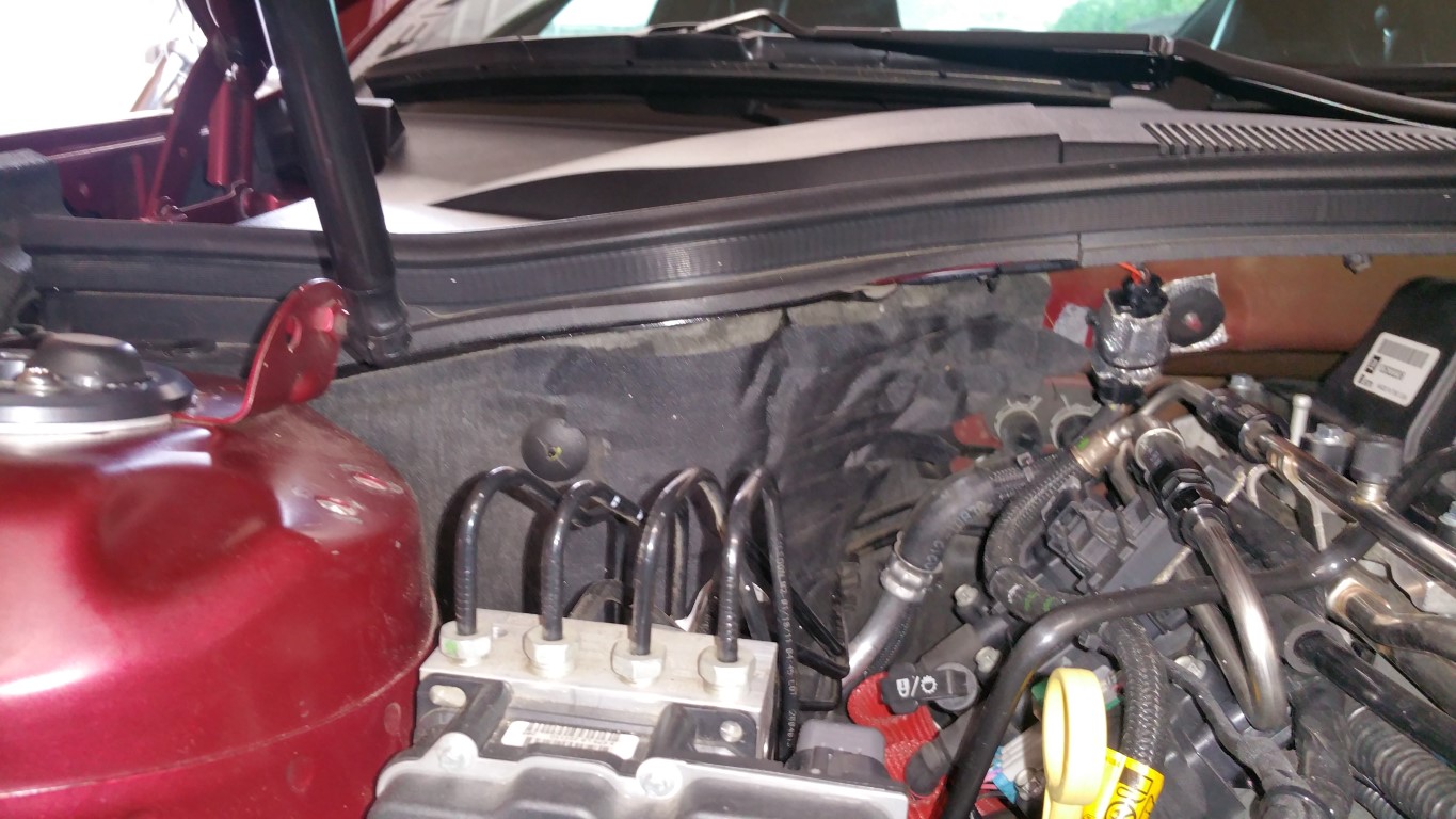

Had no choice but to put it in the right bank.
There was very little to no room on the left to run the sensor up to the cabin. Just had to make the choice as how to route it.

Ah, that is a good location!
I used the Cabin air filter grommet as that allowed me to use my fuse box for power and route all the wiring inside nicely.
I heard that bank 2 runs richer, didn't know how much. Yeah, Ryan put a nice safe tune in it, as I told him I'd only race with E85 (never 93) and mostly drive with E-85 except where unavailable.
Edit: I’ll see if I can get a bung on the driver’s side and re-route. Rather be consistent with location...
