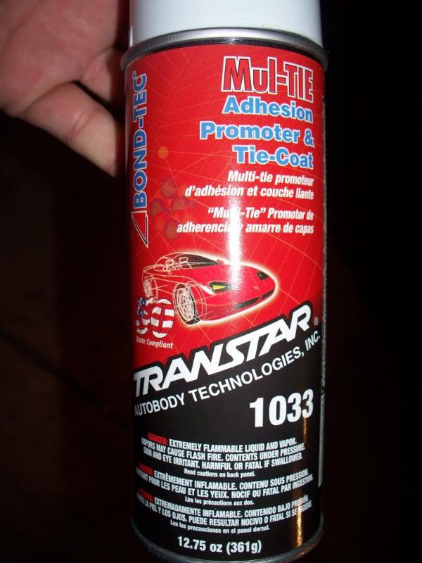

The clear paint adhesive is called Bond-Tec Mul-TIE Adhesion Promoter and Tie Coat. It says Transtar Autobody Technologies INC 1033 on the red/black can. It goes down like a clear coat, but makes the paint stick to the panel. Also, I can bend the inserts and there is no spider webbing....YET...which I why I do my absolute best to keep it straight!
Thanks Doug....... I used regular clear coat, but it still caused me some grief. I had to apply many " VERY " light coats ( mist ) before finally adding a nice thick one ( too thick all at once, and the clear would develop cracks ). This Bond-Tec is something everyone needs if they attempt to repaint their trim

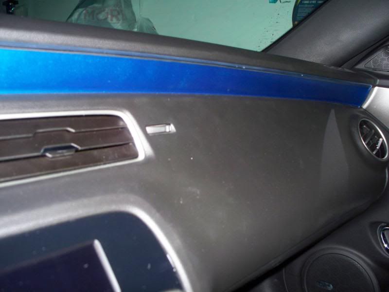

Need a few minutes...but I can't wait to do the write up for ya'll. This install is by FAR the most gratifying thing I've done...and I did it all on my own with the help of some great members by posting THEIR experiences.
You guys are going to love this. AND, the install is PERFECT. LOOKS PERFECT....DAY AND NIGHT. Be back in a bit to answer a few questions...just got home.

Originally Posted by camarorick View Post
Excellent.... Glad you figured it out
What was that paint adhesive called ?
[IMG][/IMG]
Pictures are so much easier...
You are welcome! And, I think this is where the shop that painted my door panels SCREWED UP. I think they used clear coat (or none at all) on the inside of the door panel (WHERE IT SHOULD HAVE BEEN AND WHERE I TOLD TEHM TO SPRAY)...... Ugh....This Bond-Tec is AWESOME and like you said, is a MUST for ANYONE doing this mod!!!

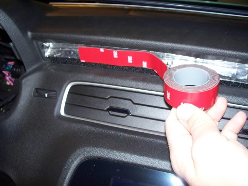

Originally Posted by tightchevelle69 View Post
tag, i got another question for ya! how are you reapplying the clips? i assume youre using somethin like 3m double sided adhesive tape, but how are you actually applying them so it all fits back together straight? i was thinkin maybe putting the clips back in their places on the dash with the adhesive on them and then putting the plastic strip on so that im sure to get it lined back up correctly. let me know how youre doin it or if there is a flaw in my idea!

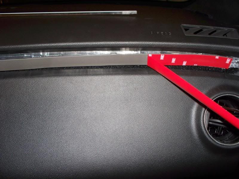

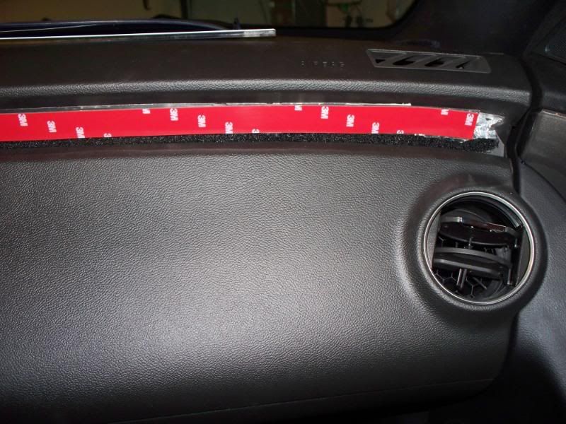

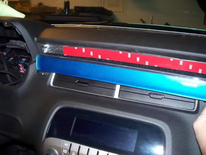

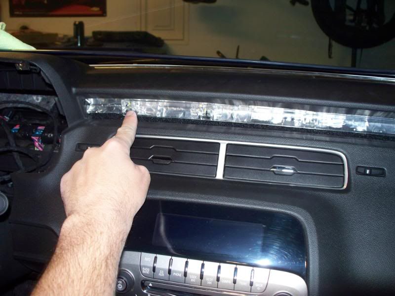

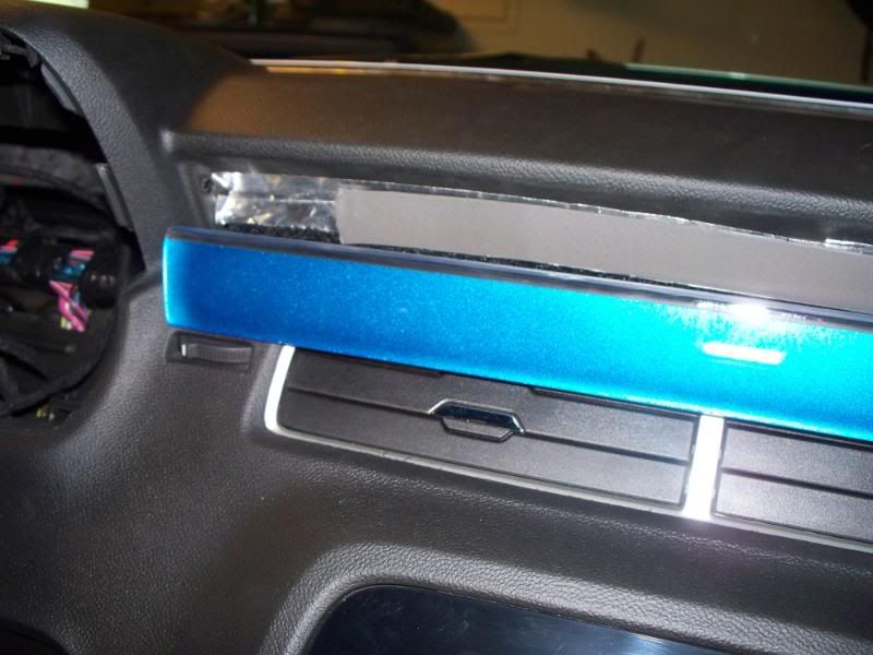

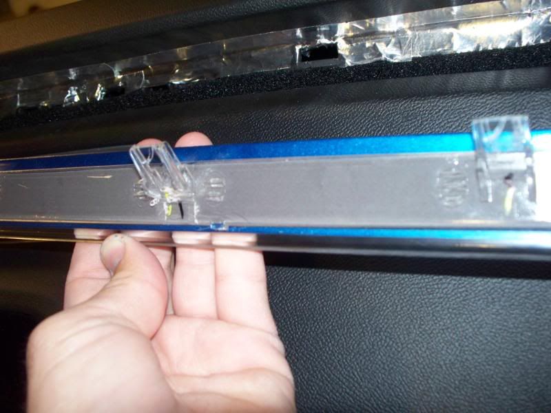

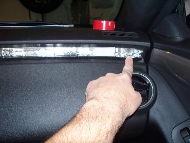

You are a smart cookie! Here ya go. This is what I did.
Shows backer in place.
LEAVE THESE TWO METAL CLIPS IN PLACE! It'll hold the ends of the insert in so that it'll be aligned for the applique when you attatch it. One on either side...

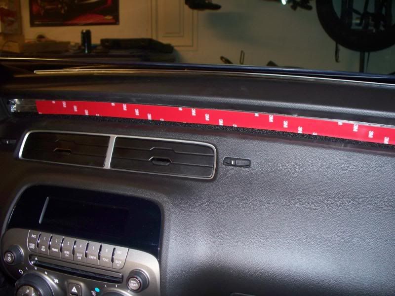

Then, grab your 3M double sided automotive trim tape. VERY easy to find......ANY parts store has them
Basically, you have the backer and the applique separated. After you clean both the applique and teh backer of the double sided trim tape, you take off ALL the center backer's clips. Take those metal things off and leave only the side metal connectors in place. That way, we can have a good refrence point and it won't be difficult for you to take off after you get it started.
You can see how I pulled it back off and it was easy...the clips are missing.

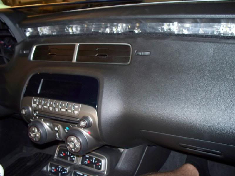

Wow Tag,
Can we get a picture of the whole dash?
That color looks awesome!

Pix of the entre dash will come soon. I want to show everything at once.

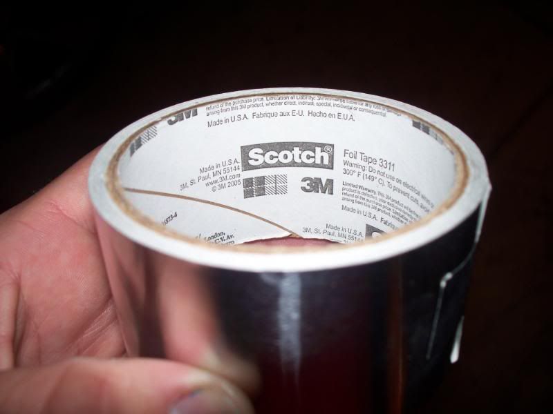

Also, you must be VERY careful at how high you put the foil (mirrored) tape. If you put it too high, you can see the shiny tape through the sanded, clear topped insert. Once you put it on, hold your insert up to the dash and see if you can see the tape (this is w/out the backer on it). If you can see the tape, it peels up easily and you can just fold it over and push it back down to a lower position. Thumbnails work just fine on it. You'll see.
