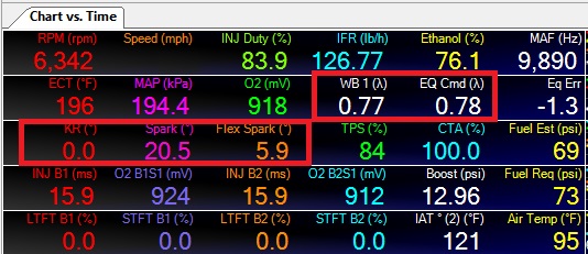

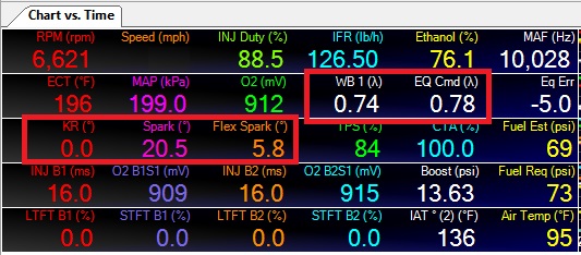

So, here is the first range Mark and I changed:
Note its a bit 'lean' in the 8.7k Hz range -- this was up to 9.1k Hz so I added 2% to the MAF Calibration g/s to give it a bit more fueling.
Then, for the upper range that was a bit rich, I removed 2%:
Note the boost and the IAT2s!
No knock, 3° timing added, fuel rich, Duty Cycle better -- thus adjusting the MAF ;o)
NOTE: 1° temp increase in 900 RPMs! Temps will be better once I get the Lambda consistent...
You can see it was rich so I had to adjust the g/s in the MAF to account for the lean then rich changes.
I also added some additional items to the graph -- Mark noted I could get the Flex Fuel Timing added so I added that and the Fuel Pressure Requested and Estimated.
I may update the BAP just to have a bit more range for the fuel pressure.
Lots of info in the logs when you add them...
-Don
747 RWHP 794 RWTQ

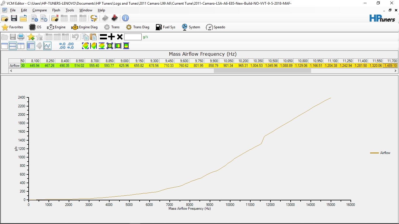

Wanted to show the current MAF curve (above 11.55k Hz we didn't change since I don't get near that):
Getting there!

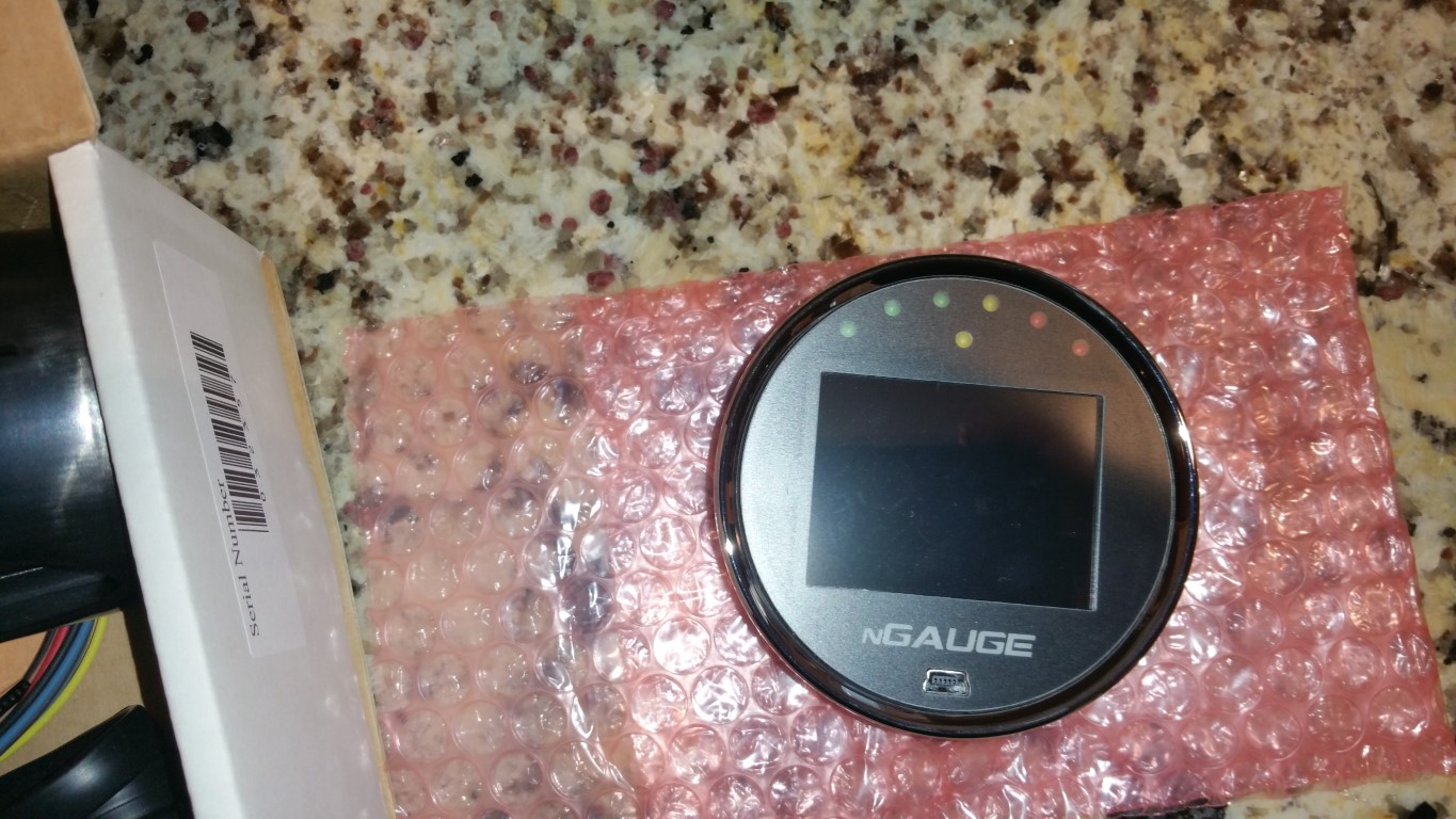

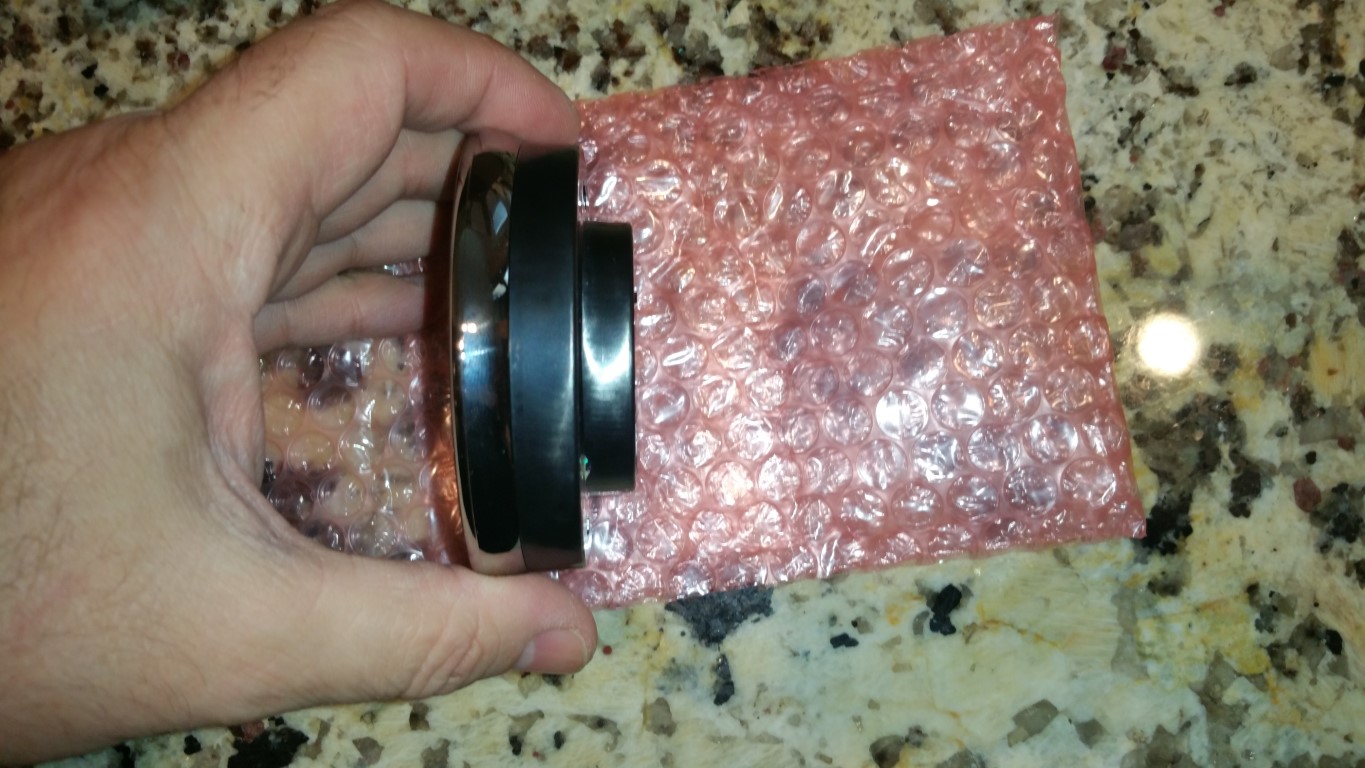

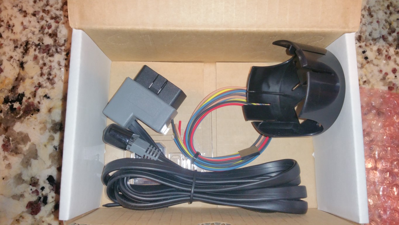

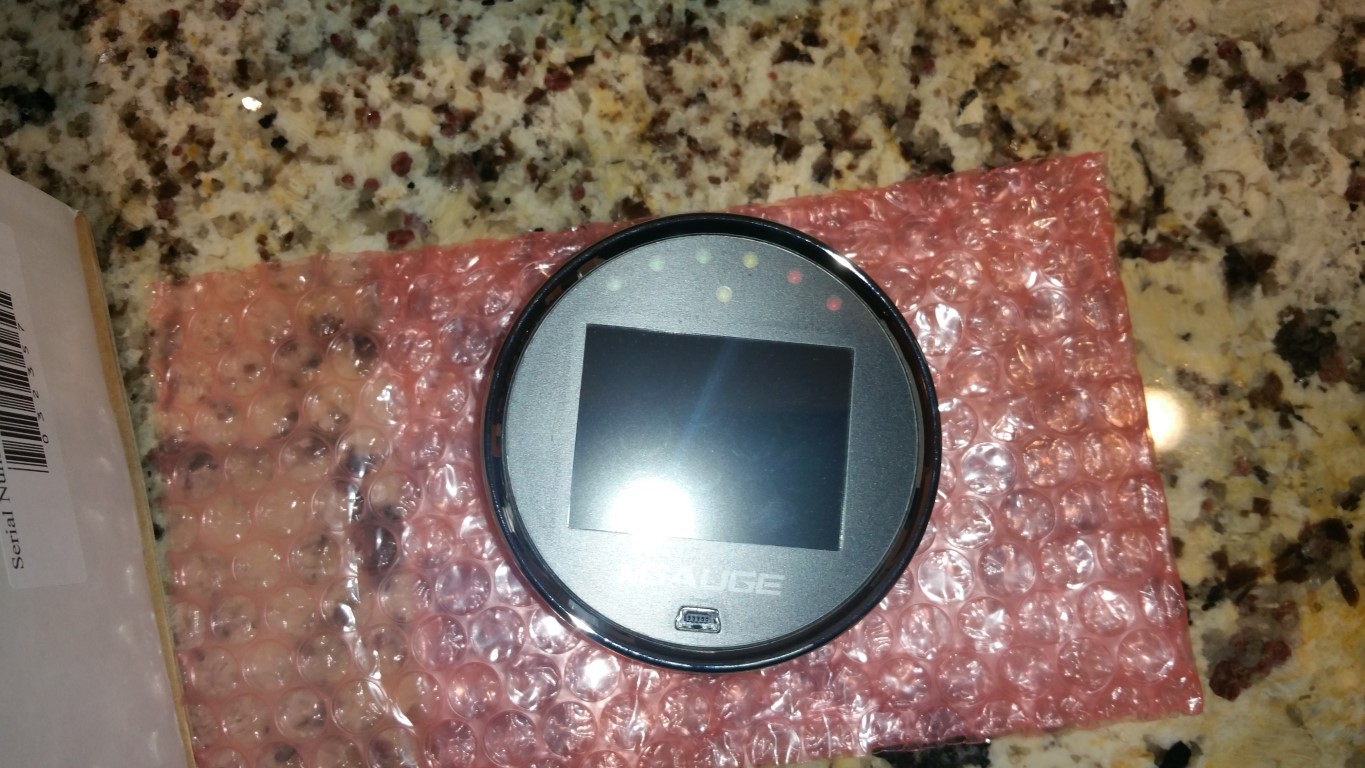

nGauge
Got the nGauge from Dave @ DSX (DynoSteve dropped them -- issues?). So, I'm expecting those have been resolved by now and will utilize this gauge.
Lots of nice features so I'm 'hopeful' everything has finally been addressed...

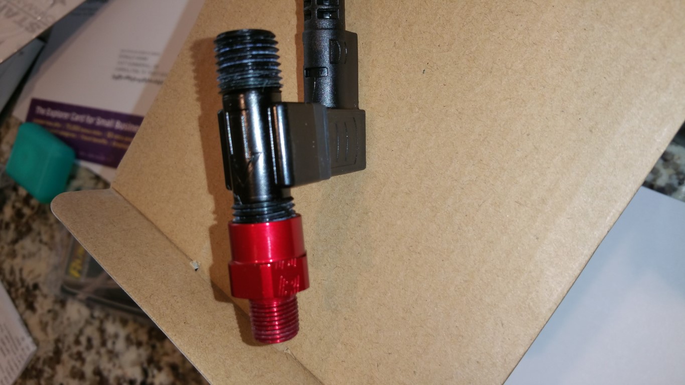

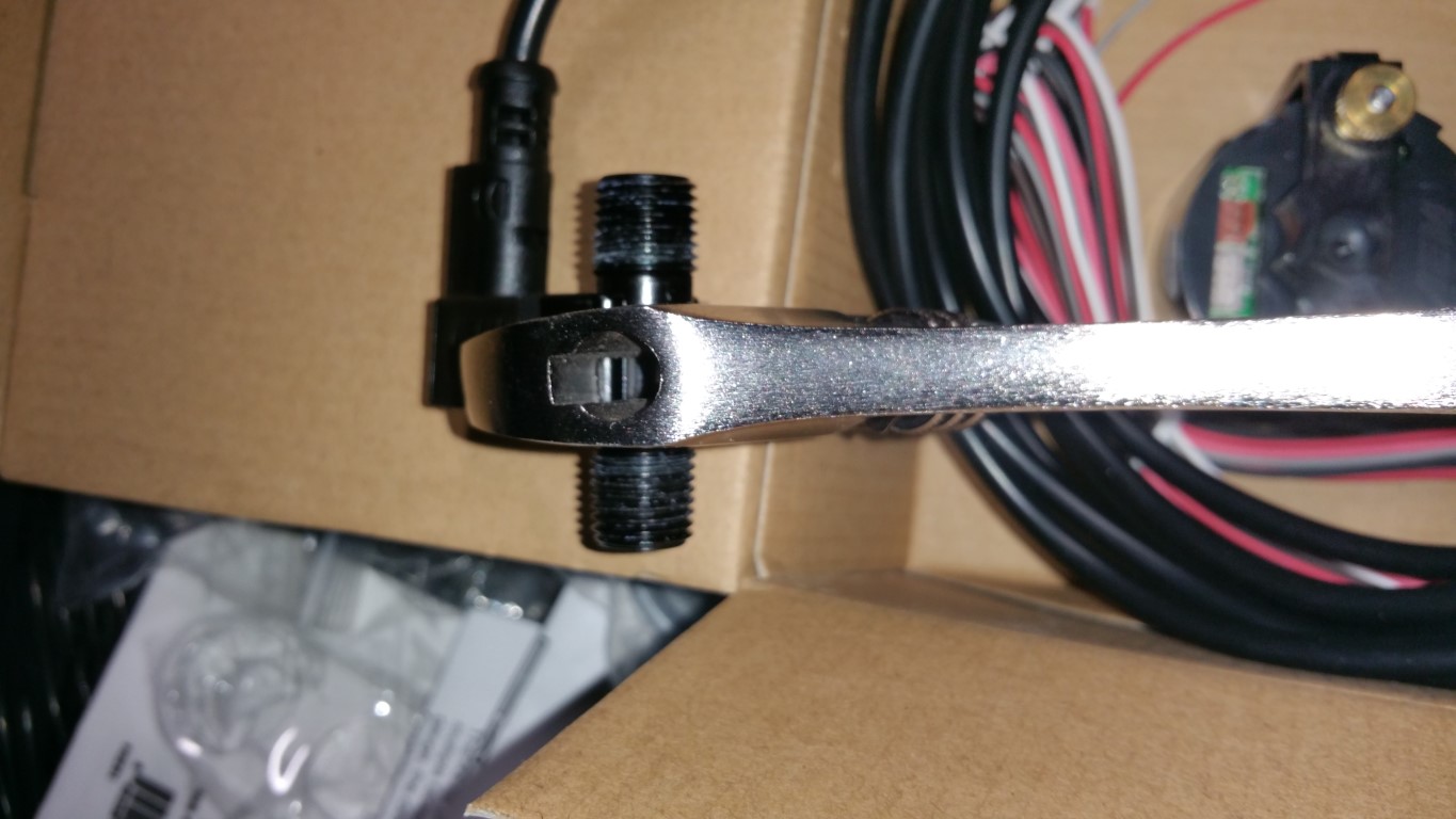

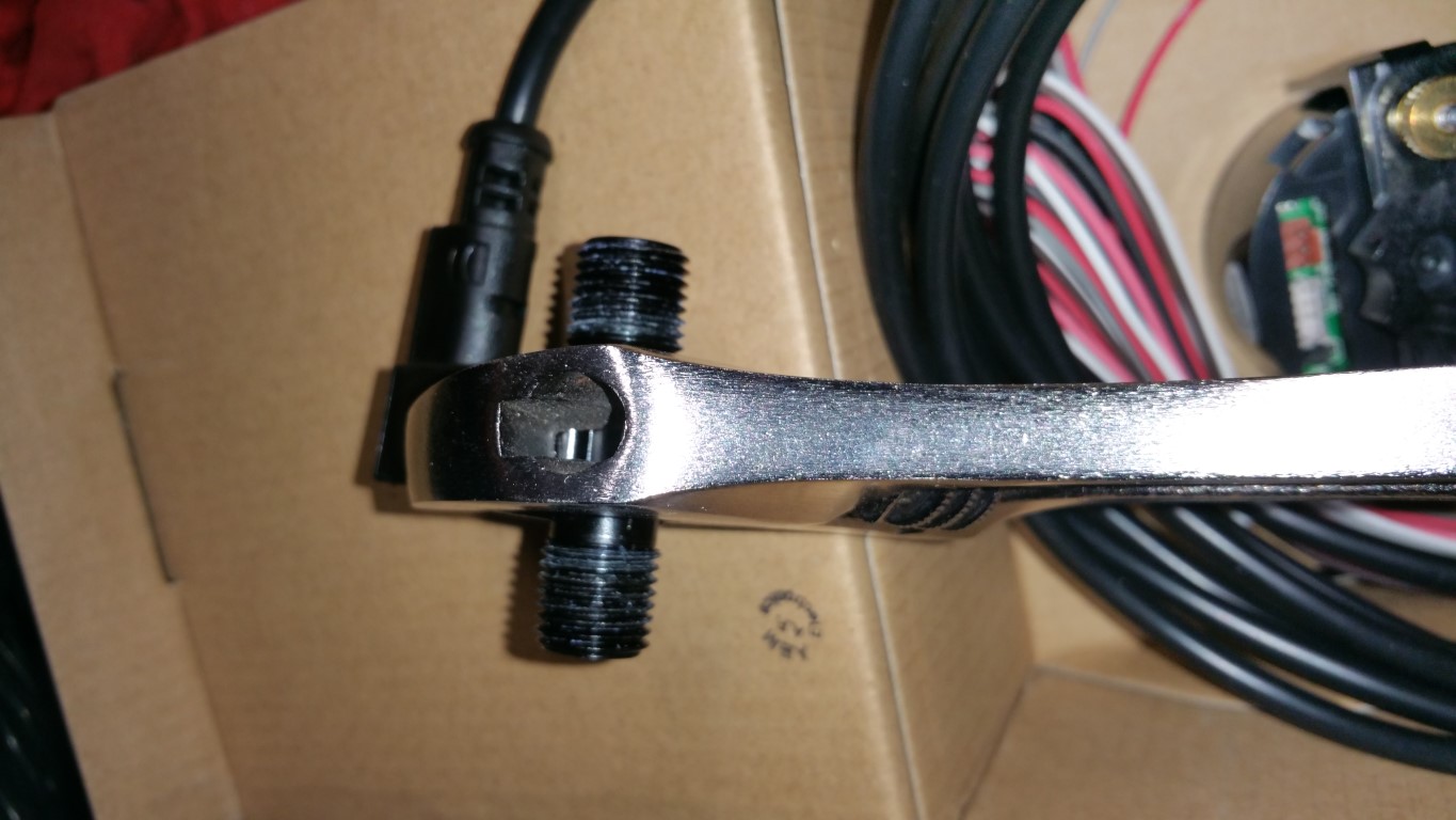

Prepping the Flow Gauge from AEM!

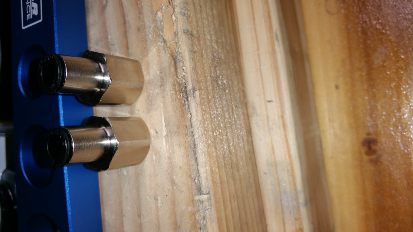

Once of the big things to keep in mind -- the unit is plastic and they used blue loctite!
You have to 'heat' the fittings in order to 'not' break the plastic, then SLOWLY remove the fittings -- doing a little at a time:
Note the residue:

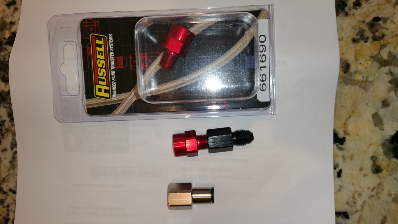

Slow and steady, both are now off:

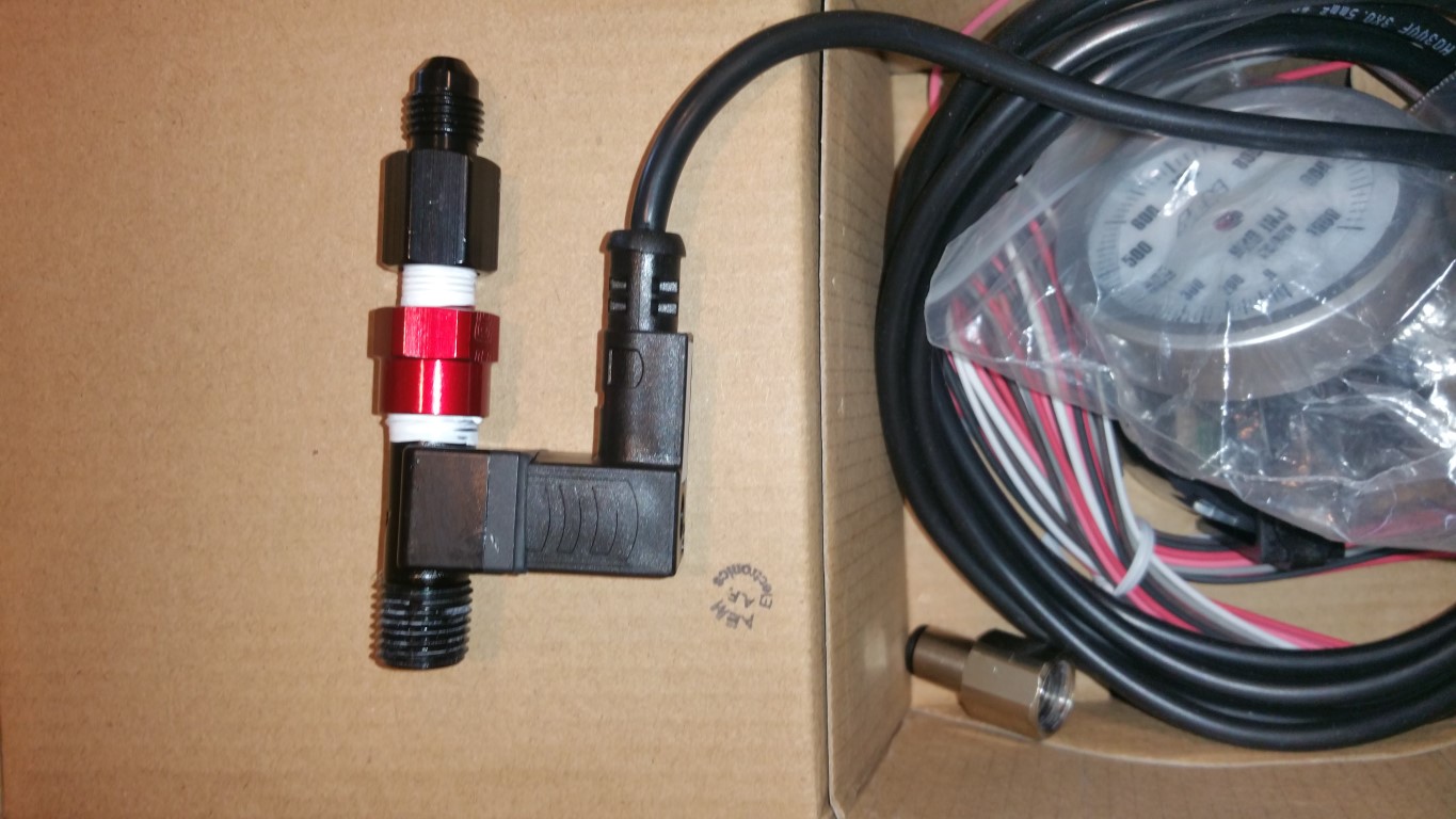

Now, I needed to add a 1/4 NPT to 1/8 NPT reducer so I could install the AN 4 fitting (make sure you note the flow direction!):
Test fit:
Now Teflon taped and ready to install on the check valve (the red fitting is towards the an hose and the flow is to the check valve):
This is where I need to 'install' the flow meter -- I'll need to remove the 1/4 NPT to AN 4 fitting and then, install the flow meter unit:
-Don

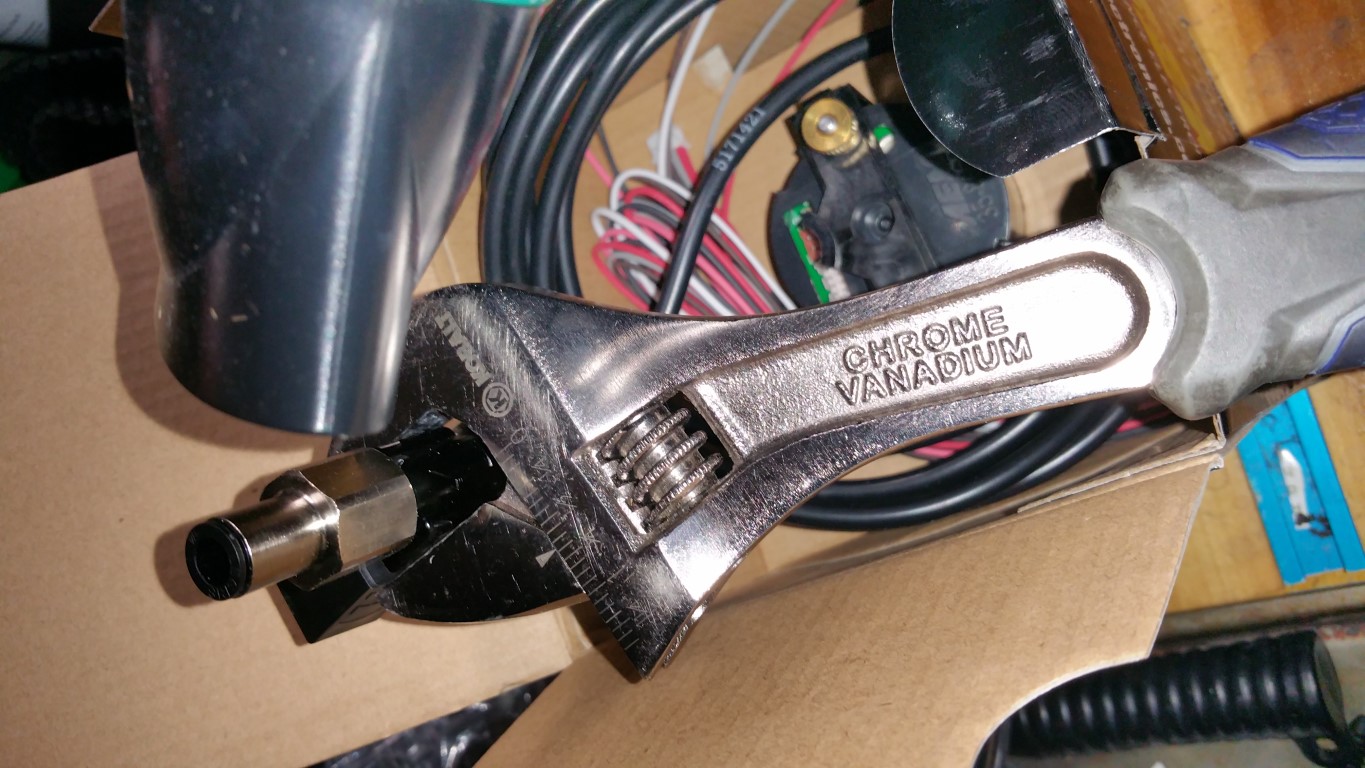

Posts: 15,802
You got some damned fine quality pieces parts going on in here.... and you bought your crescent wrench at Circle K..... What in the Wide Wide World of Sports is Going on in here....

Lowes, ACE, Harbor Freight, O’Reillys, Auto Zone within 5 miles of the house — its an addiction being a former ASE certified tech ;o) - SnapOn is way too much now!
Summit is 30 minutes away feeding it even more!

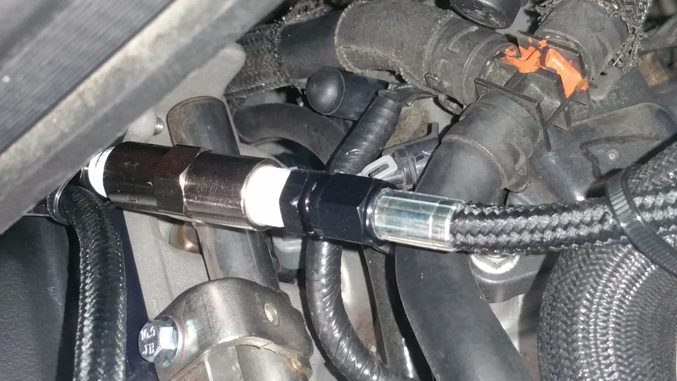

Continued on setting up the flow meter -- was able to find a good location for the fluid gauge Rodney included in the kit:
So now that I know this is a good location, I started on the flow meter -- started getting things ready -- slow and stead and then 'crack' -- yep the flow meter cracked while I was putting on the an fitting -- very little pressure use -- just happens sometimes.
The flow meter is removable and replaceable:
LUCKILY, I have a Summit REAL CLOSE so I was able to get one TODAY:
Not cheap but, they have them in stock so, what does that tell you (yes, they break!).
Here is how you assemble this (the harness is on its own and can be bought too -- note the harness gasket):

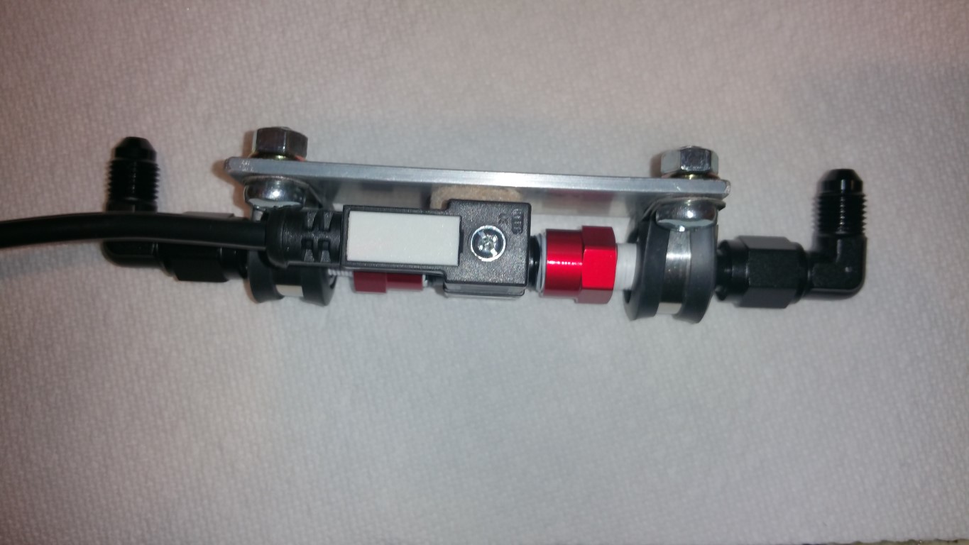

So since it took very little pressure to really snap one, I decided to create a bracket and use adel clamps to soak up vibrations.
Here is how I'm building up the flow meter:
I added green dots for the proper orientation:
Bracket and Adel Clamps:
I'm also going to keep this away from heat too.
I don't care how careful you are, sometimes its just gonna break...

Also the nGauge came in:
SD Card location:

Nice work on the flow meter install... is it just informational or is it tied into a safety system like a low octane table or reduced power setting. Call me curious...
Old 09-12-2018, 12:27 AM   #2254
hammdo
'It's an experiment'
hammdo's Avatar
Location: Dallas TX
Posts: 8,709
Info only — I have a very safe tune for meth — and it takes a while for 4 gallons to be used.
Road racing it’s for cooling only so it runs rich (.65 Lambda)...
Since I run E85 octane is there so I’m safe.
With the nGauge, I can swap tunes easier too.
FYI, I only adjusted the meth tune at WOT. Still need to test a bit but so far Meth tank is still near the top!
