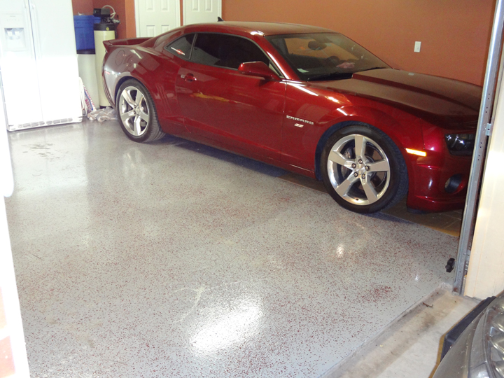

Well, it'll be a short stay, but Brandi made it home today... She is comfortably parked in her spot on the newly finished garage floor...
I did the floor in grey with maroon speckles and clear coated it... It matches her quite well.... She approves...

For you Pete..
Here are a few pics of the newly done Garage Floor... I did the work myself, so it's not professional but I like the results...
Please note, Brandi has been in the shop for two months, and she is a bit dusty... I didn't want to hurry the wash job so I'll wait until I have more time tomorrow to bathe her...
There is a diaper on the floor (big piece of cardboard) to make sure there are no oil leaks... We were into a lot of things... the oil cooler, the turbo oil lines, etc....

Nicely done. I like that a lot. You didn't document it?
My garage floor is horrible. Was it hard to do?

Not really... My biggest problem was when you mixed the clear, they said to let it sit for 45 minutes... before applying it... and it did go on well at first, by the time I was getting close to the end of the gallon, it was hardening really bad... about ten minutes after I started spreading it... So, on the second gallon of clear, I waited about 30 minutes and it started hardening almost as soon as I started applying it... so it was slap it on fast and get er done.... And no, I didn't document it.... sorry... and if you can do what you did to Bonnies styling room, you can do this...

Did you have to pressure wash the garage before?

Nope... I etched it with the citrus stuff they provided with the kit, Not muratic acid like other kits I've used... This kit has a citrus acid powder you mix with water in a bucket... I poured that out in sections, let it sit for a few and then scrubbed it with a stiff bristle brush... then rinsed it really well with a hose... no nozzle, just a flooding rinse....
I used a squeegee to get the bulk of the water out and used a fan to dry it really well... then applied the color and the sprinkles... which I had ordered on line due to wanting a specific color... Maroon... and let that sit overnight... i then applied the clear the next afternoon... I made my wife promise to not park on it for four or five days... and she didn't... There are no tire tracks or marks on it... There are a few blemishes but those are on me...
