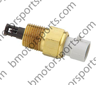

In order to get accurate reading, you must have a grommet style IAT sensor in the proper air stream, standard screw in temp sensors are not as accurate (pickup all the heat from the engine and under hood) and most have different transfer functions. When your in this area with our twin screw, the temps very rarely change and gives almost zero tuning ability since there's almost no swing in temps. Thus, its not required to monitor post SC. The proper system, such as most factory system has an IAT 1 and IAT 2.

IMHO the only way to really have an accurate reading would be to tap a sensor into the chrage as it leaves the SC unit and before it enters the cylinder head runners. This of course would need to be a temp unit separate from the IAT and NOT used for tuning, just to measure the effectivness of the intercooler design.

I agree with SC2150 the IAT sensor is misleading. You can run more timing with a Super Chiller at same IAT reading. I don’t know why but in practice you can see it on Dyno. So air charge is lower temp than reported. That’s even with a fast Omega Sensor

If the IAT sensor is still in the MAF, then that explains why the IAT's are soooo low. The blower (meaning any blower that runs like this) could be putting out 400* temps, and the IAT's wont change. From a tuning standpoint, that is wrong. You MUST work with "Actual" numbers.
First things first.... From a tuning standpoint, "Knowing" your true IAT's is CRITICAL. I dont mean just any IAT, I mean the IAT's right before they enter your motor. These temps play a significant part on tuning. A change in air temp, is a change in air density. A change in density, is a change in power output.
IAT is a very important factor in tuning. Not only is it a direct corrilation to A/F ratio, but it also is one of the key factors in pre ignition, detonation, and the amount of timing that can be ran, just to name a few.
If you are driving your car not properly tuned for IAT changes, you can very easily grenade your motor.
In tuning software, youve got a VERY VERY important field. It is IAT vs Spark. When your IAT's start to climb, you need to pull the proper amount of timing in order to lessen that chances of detonation. For instance, if you are running around at 100* IAT's, you may be commanding -0 degrees of timing. This means you are running off of your main spark table, with 0 degrees of timing being removed for Intake temps. Now, lets say you decide to mash the gas on the freeway, and run all the way to redline. Your IAT's can jump in excess of 60-90* by the end of the run. When this happens, it is critical that you pull the proper amount of timing. If you dont, you will start to detonate. Detonation causes massive pressure spikes in your cylinder. If you have boost, it multiplies that many times over. This is why you can easily crack a piston, or blow a head gasket.
Now, say you think to yourself, "Well, Ive ran my car, and it doesnt knock at WOT". The only way they can do this, is if they dont add the proper amount of timing in the main table to begin with. So instead of you running around with say 16* of timing, your running around with 12. Sure, your car wont knock when your at WOT (Wide Open Throttle), but you have now tuned your car for the 1% of your driving, and the other 99% you are leaving a ton of power on the table. My point is, is there are adders and subtracters that run along side of the main table. If your coolant temp is lower, then your car will add a couple of degrees. If its hotter, it takes it away. Same with IAT's, as well as a few others.
But now, on the flip side of the coin, IMHO, the general public worries wayyy to much about what their IAT's are while running around. Ever since the tuning software companies gave us the ability to view this stuff, it causes everyone to freak out when they see high numbers. Is it needed for tuning? yes.. Does it really matter if your look at it after the fact? No.
IF, your car is tuned properly, high IAT's dont hurt your car one bit. Mustangs see 200-250* temps every day of the week. The new ZR1 and blown CTS-V see 200* temps all the time. Factory blown cars have been seeing 150-200* temps for many many years now. Yes, it hurts power. Yes, when your heatsoaked you loose power. But as soon as you cool back down after a run, your car adds the timing back in, and your back up to your original power.
I always say, get the blower that is going to suit your greatest percentege of driving. Dont just pick the blower based on IAT's. But if you are really stuck on that, then dont get a top mount at all. Go with a centrifugal. 99.999% of the time, a centri is going to have lower IAT's.
Sorry for the long post, but I wanted to explain it. Wayyyy to many people buy based on false information. IF that blower is running "Pre-Blower" IAT sensor, then I would suggest you re-tap the sensor into the manifold. Just like EVERY other top mount blower company out there. Both Maggie and KB run their IAT sensors in the lower manifold. Where its supposed to be.. Same with General Motors.
