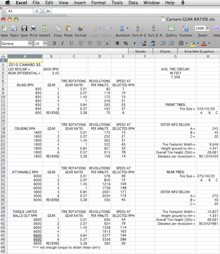

Originally Posted by SScattergunSS View Post
I think it's cool you took the time, but I think the rear wheel / tire diameter is 28.66" not 25.66".
Aw damn. Someone else was asking me questions about 17" tires- don't ask why- and I didn't change it back as you can see. The "text" is 245/45/20 but the fill in's are 245 45 17; same with the rear. Here it is again with 20's.....

Hmm...to hold on to 3rd and bump off the rev limiter for ET or shift to 4th in the quarter for speed.

The 3.45 Gear ratio (M6) is the final drive ratio, or rear diff ratio. I'm fairly sure that's correct.
Awesome, that's what I thought but needed the confirmation.
I'll be making an excel spreadsheet and posting it on here when I'm done so everyone can change the info to fit whatever car they'd like.
I'll also post a graph of the Camaro SS' shift times so we can tell exactly what RPM's would be most ideal.
I'll send you the above spreadsheet if you want as a starting point- excel is cross-platform...PM me.
